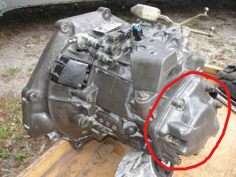

The end plate on the transmission is where 5th gear is housed. Take off the driver's side wheel and you'll see it. I do not suggest opening it up unless you know what you're doing.
I HIGHLY doubt that you've just "shot" the gear. In fact, if you had, you'd know about it. Destroying a gear or a diff sounds like throwing a handful of quarters at the firewall. Ask me how I know. IF you need a new 5th gear, I do have an entirely new 5th gear assembly in a transmission in my garage. Getting it off without breaking it? I don't know if I can do that.
The roll pins are what hold the shifter heads to the transmission (bronze colored in the above picture).
The adjustments for the shifter cables are under the shifter boot.

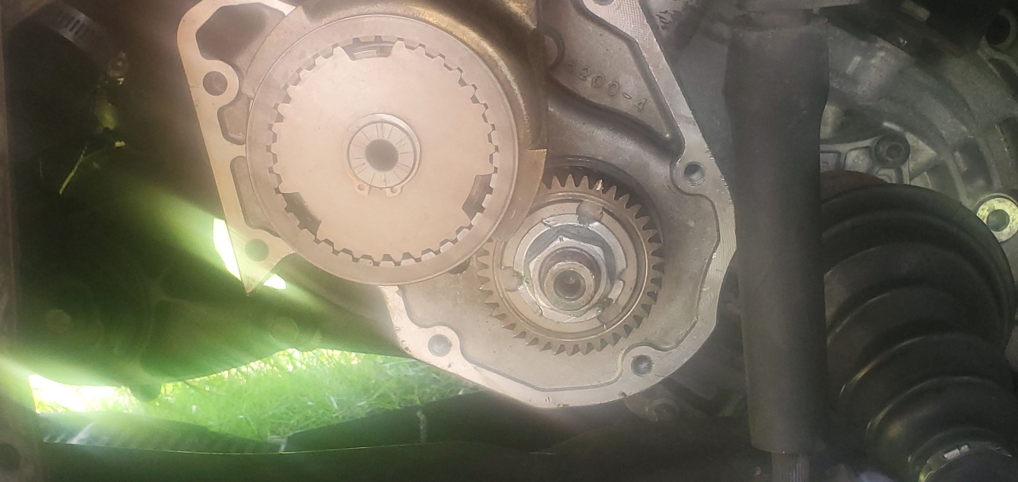

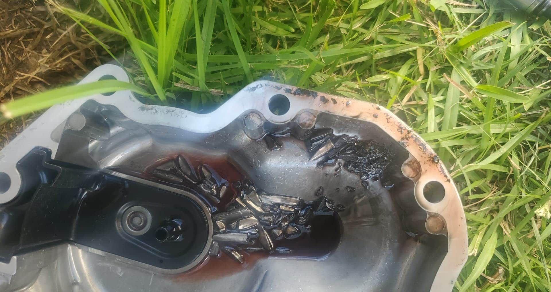

i got it from ZZP new... but.... confirmed... TRASHED
Old Jul 21, 2020 | 07:11 PM
USMCFieldMP's Avatar
Rattlesnake Race Shop
Joined: 06-08-06
Posts: 15,725
Likes: 410
From: Fort Worth, TX
Well hot damn. Look at that.
I'd call ZZP. If it's been less than a year and 12,000 miles, you might be able to get another. Sometimes they qualify those warranties with statements like "...when installed by a certified technician." But I also don't see the transmission listed on ZZP's site anymore.
Fixing it is an option, but I'd be worried about metallic bits grinding your bearing faces to bits.

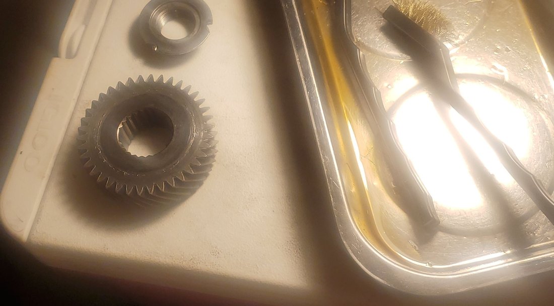

New 5th gear, anything info on process appreciated.
Originally Posted by 2010MurderSS
I have a few questions here, i shift to 5th, and i get neutral. In what order should i troubleshoot my issue? If i need 5th gear, what part list do i need to replace just 5th, im new to transmission work honestly. And i heard that you can service 5th with the transmission still in the car.. how can i go about this? I havent found the exact awnsers or pictures im looking for... ive heard roll pin, cables, shaft nut.. possibilities... im pretty sure ive shot the gear though. Can somebody guide me in the right direction? Money is limited, labor hours are not.
Please show me how to service 5th gear without removing trans from car.
Got new gear, extra fluid, sealant if i determine i need on gasket, all necessary tools, anbody got the torque specs on that nut over 5th? I have 2 and will use the best one. And clean debris the best i can out of trans. Ready to roll.
