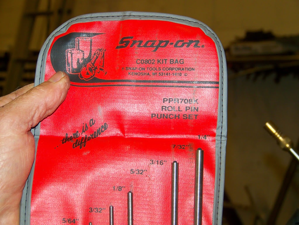

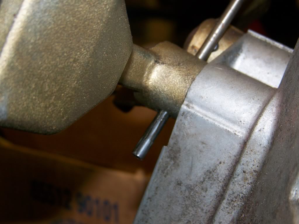

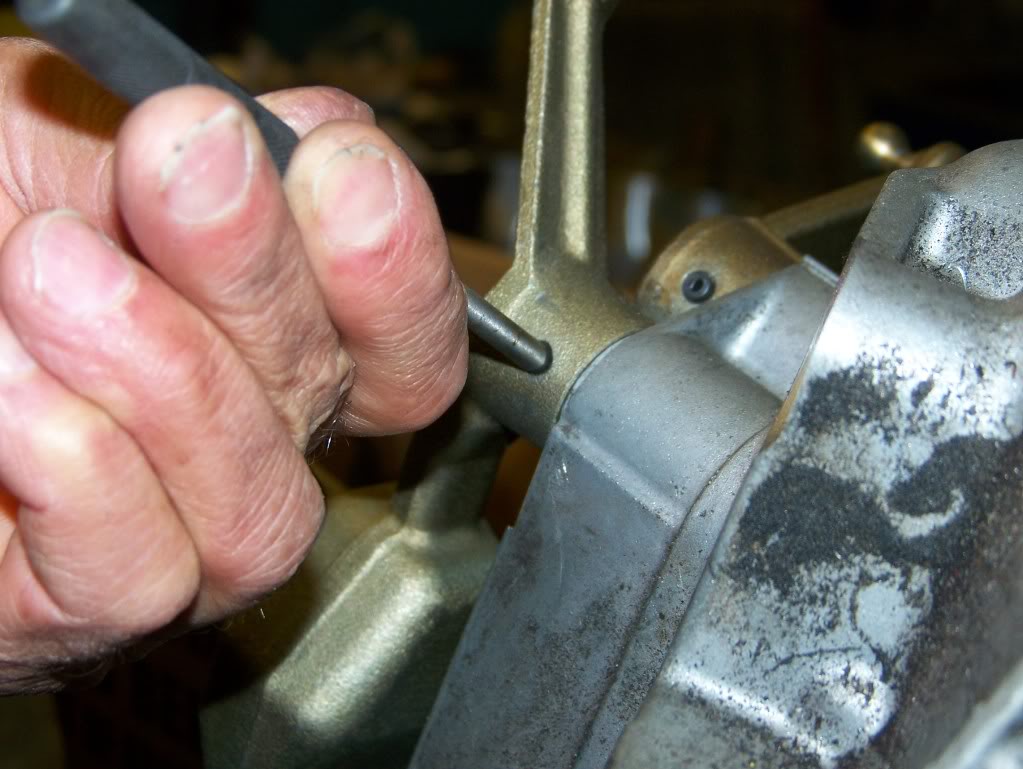

Are those pins hard to install any special tool needed
roll pin tool. its shown in the how to that ralliartist poached from me.
