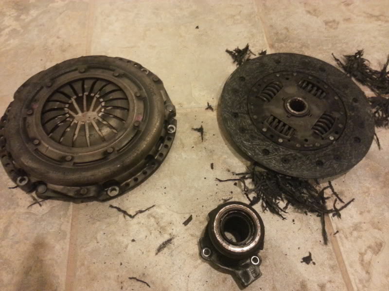

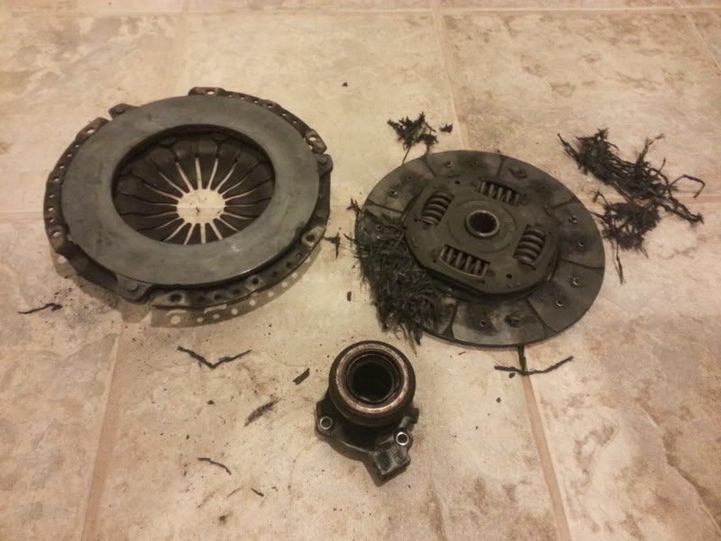

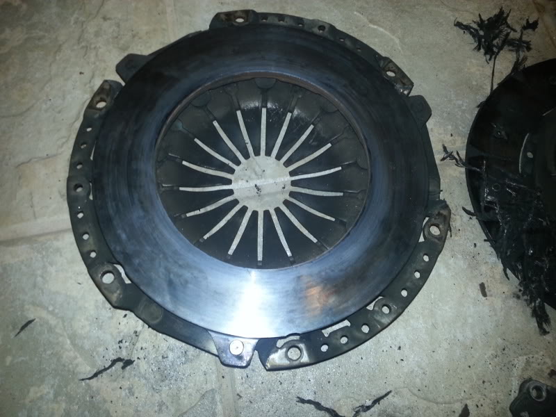

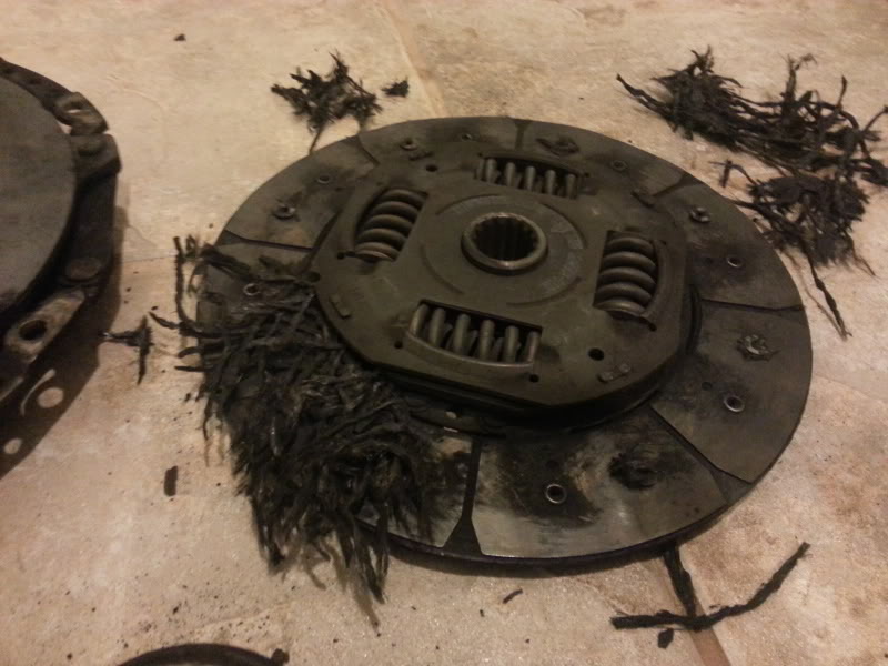

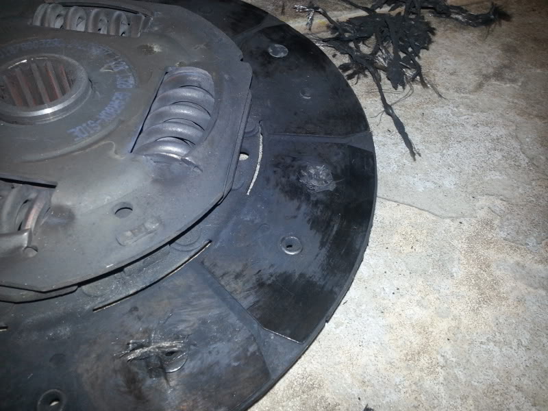

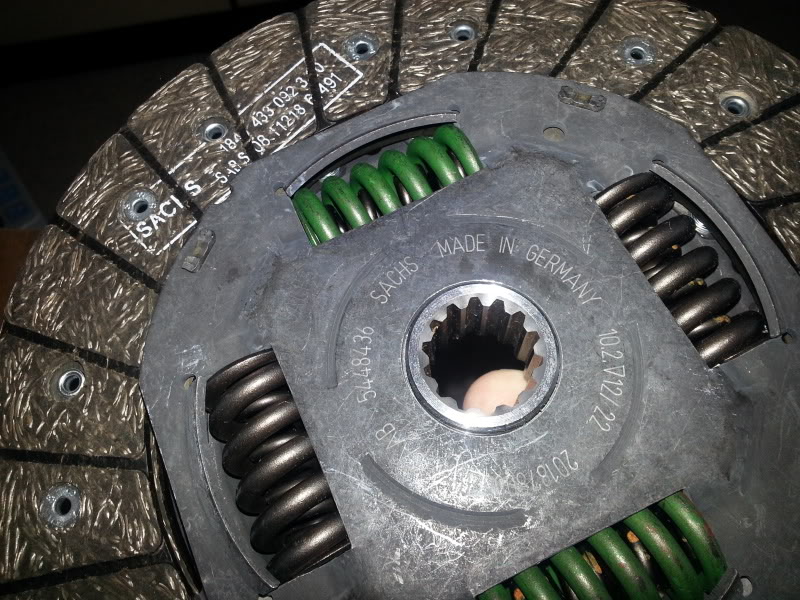

Will let the pictures speak for themselves
Old (clutch shredded to pieces down to the bare metal, pressure plate is blue from the heat) LNF clutch:

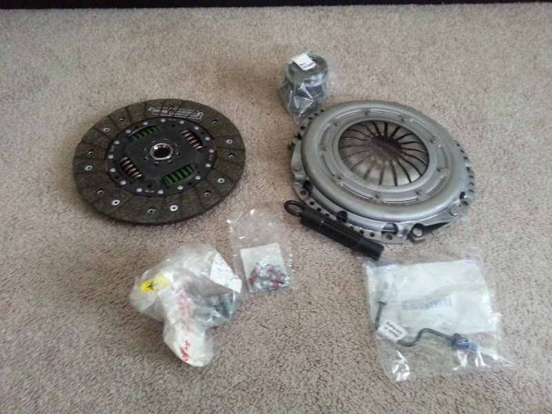

New GMPP clutch from CED:

About 58K. And I will say it again... if it wasn't for my wife using it as "training wheels", it would probably still be good for another 10-20K at least.
But what's done is done. Clutch is replaced. She doesn't want to drive manual again. Moving on with life.

You'll need both the kit and 6 (six) LNF pressure plate bolts from the second link (GMPP clutch only comes with LSJ bolts):
Ecotec LSJ Clutch Upgrade Kit 19212712
LNF Pressure Plate Bolt 11570368
