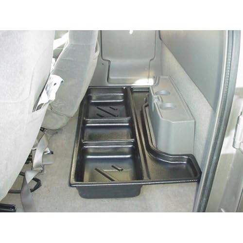

I'm at work, so no pics of my truck, but I will search up some pics of interiors that are the same, give me a few min.
Here's what I found:
No Black Plastic thing back there on the floor though.
these are what I have to work with basicaly....

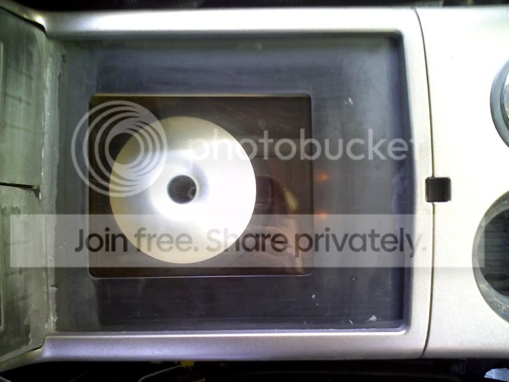

Yeah, that was the initial plan, I was going to do a Complete Plexi Box and Amp Rack in the extra Cab space, but I decided I used that area to much. Let me find a pic of the 3rd Door, I want to put a Sealed 10 or 12 in the actual door.
this is the best I can do for the door I want to use.

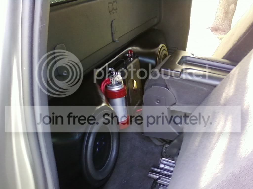

my brothers got a '00 sonoma, and he too wants some bass. It will be interesting to see where you put the box cause we have no clue where to put it besides in the rear door or take out the suicide seat and put it there... However both would require making a fiberglass box which would be a PITA to make expecially cause i have hardly worked with fiberglass.
most of the bottom of the door is pocket (and its a pretty big one) I was planning on cutting that out, building a frame on the actual door frame, and working that into the plastic cover. There is only 2 small bars near the edge of the door for unlocking it. Nothing else is in there with regards to airbags or anything else.

I have a question
Whats under the cup holders in the back, is that whole plastic piece there just for the cup holders?
Its just a thought but if possible take that plastic piece out and build the box in there. If you come up another 6-8 inches and forward about the same that should give you room for a 12" with a slot port, maybey face the port up on the top or do 2 small ones out each side.
Thgis way you don't loose much cabin space and you keep your sub symetric to the rest of the truck. If I remember right the 3rd door has no electronics in it to start with thus no molex to wire through, puting a sub in that area is going to be a pain in the ass to say the least
As much as I hate to say this a sub that requires very little air space would be your best bet, (here comes the painful part) The JL subs ere known for there ability to play well in small spaces, a 10 or 12 w3 (DVC version) would do nice. IMO you should stay away from the JBL subs, there not all there cracked up to be.
As for the amp, its a good amp but for the price you will pay for it there are plenty of better amps out there . Retail price on thatAlpine is around $800, for that money you can get a Audison LRX 1.400 and still stay digital, much better amp IMO
thanks for the suggestions, the Jack is in that plastic box with the cupholders, so Unless I move that, it's a no go there.

Console Box? Are you good with fiberglass and wood work? Anything is possible with a creative mind.
I have seen some put it in the swinging 3rd door, but you have to be good with glass and have to really support the inside of the door to make it look good.
