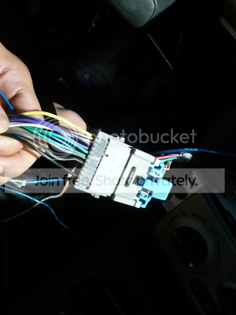

well i got my wiring harness...n i wiring everything...haha but now i got my back speakers to work but not my front... i wired the 12v from my fuse box...and i got my back speakers to work because i put the accessory wire with my power wires ...me n my pops were thinkin about sorta piggybackin the front speakers to the wires on the back for power....will this even work? or is there something else i could do that would be easier?

take a picture of ur harness and post it on this thread
[/IMG]

man i cant get the picture to show up...its an 06 chevy cobalt wiring harness...

i was able to get the code and check it out via e-mail replies but ya it looks good. you can piggyback it like u were saying but the best thing would be to find out why its not working. check the color codes to make sure they are correct and if so swap the fronts and backs to see if its the radio. below is the code it says the color in the car first then the corresponding aftermarket color it should be hooked up to
Left Front Spkr (-) Light Gray White w/ Black Stripe
Left Front Spkr (+) Tan White
Right Front Spkr (-) Light Green Gray w/ Black Stripe
Right Front Spkr (+) Dark Green Gray
Ground Wire Black Black
Power Antenna Turn On Pink (if available) Blue
+12 Volt Battery Wire Orange Yellow
Right Rear Spkr (-) Light Blue Purple w/ Black Stripe
Right Rear Spkr (+) Dark Blue Purple
Left Rear Spkr (-) Yellow Green w/ Black Stripe
Left Rear Spkr (+) Brown Green
