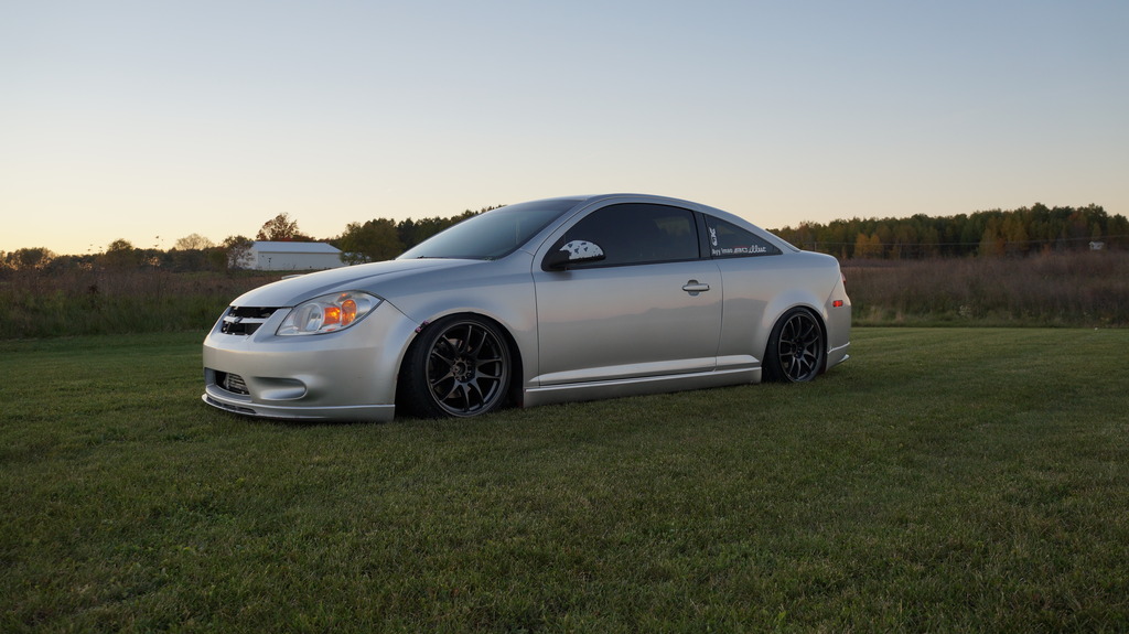

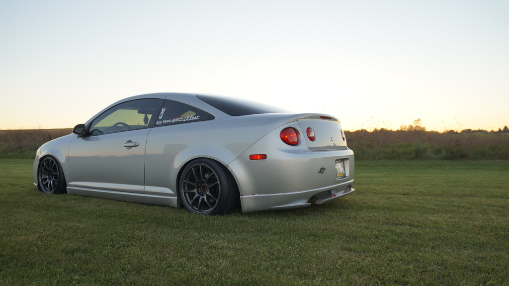

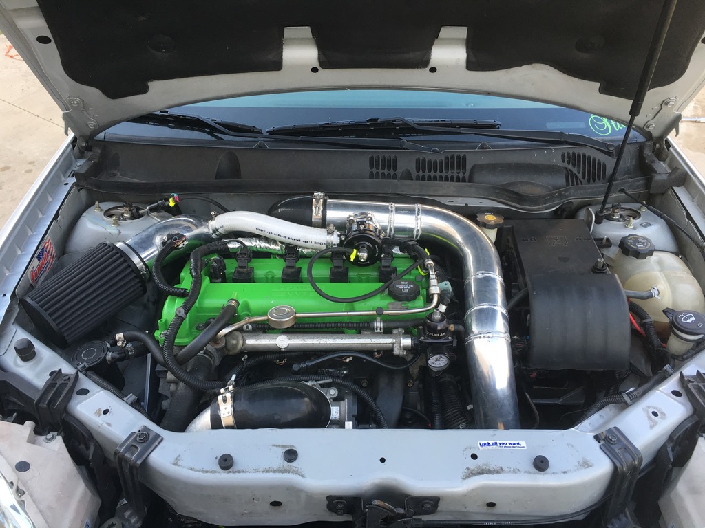

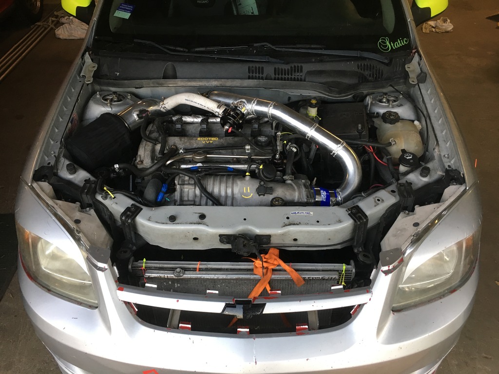

Location: Big Rapids, MI
Car Info: 2007 Chevy Cobalt LS
Stock Options: Air Conditioning, Getrag F23(Non-LSD) Manual
Modifications:
Drivetrain:
-Stock LE5 Engine/Harness Swapped
-Self-tuned on HPT
-OTTP Builder Turbo kit
-s257 57mm Billet Compressor T3 .63AR
-304 Stainless Manifold/Downpipe
-38mm TiAL Wastegate w/ Stainless Dump to atmosphere
-50mm TiAL QR Bypass Valve
-Swiggity Swaggity Hand Fabbed Turbo Parts
-3.5" Intake with MAF straightener, fittings for recirc and catch can, AEM dryflow filter, and Injen Hydrosheild
-2.5" Charge Piping w/ BOV Flange
-3" 304 Stainless Catback w/ Megan Stainless Fart-Cannon w/ 4" Tip
-Eaton M62 Supercharger Kit
-3.8" Pulley
-Stock Four-pass endplate
-Factory Heat Exchanger
-Stock LSJ Throttle Body
-Fuel System
-Full Return Style
-LSJ Fuel Rail
-Siemans 80lb/hr injectors
-Walbro 450LPH in tank pump
-OTTP Fuel pump rewire kit
-Fuel Lab 1:1 Regulator
-Mishimoto Filtered and baffled catch can
-KY Stg 3 6 Puck clutch w/ OEM flywheel
-Cavalier Axles
Suspension:
- Randylow BC Racing Coilovers w/ 14k front and 12k rear spring rates w/ BC endlinks
-Full LSJ FE5 Suspension Swap from 2005 Cobalt SS/SC
-Aluminum Control arms w/ Moog ball-joints and Powell Trailing CABs
-FE5 Rear Subframe
-LSJ Calipers/Rotors/Hubs
-LSJ Front swaybar
-Mongo Drilled 5x114.3 Hub Pattern conversion
-Powell Hardcore Rear swaybar
-ZZP Stainless Brake lines
-Hand-made engine mounts to align axles w/ Powell Rotated front mount
Wheels/Tires:
-17x8 +20f and +35r Enkei RPF1
-245/40-17 Dunlop Direzza ZII Star Spec
-Pictured wheels
-Drag DR-31 17x9 +17f and +28r
-Nitto Neogen 205/40-17
-Muteki SR-48 Purple lug nuts
-ARP Extended Wheel studs
Interior/Exterior:
-Innovate LC-1 Wideband w/ Digital blue gauge
-Autometer 45 Psi Analog/Mechanical Boost/Vac gauge
-Push-to-Start button
-Custom double gauge pod mount near gauge cluster
-Factory SS black Recaros w/ black leather rear
-Factory SS Floomats
-All black interior panels
-Ebay Bi-Xenon HID kit 6k w/ Hi/Lo relay in stock housings
-Silver Vinyl Eyelids
-Cobalt SS Factory Body/Lip kit
-OTTP Front tow-hook
-Minion Drift Token
-"Illegal in all 50 States" license plate frame
-Numerous +5-10hp stickers
Future Plans:
-Mongo Built ZZP Girdled LE5 11:1 Compression (Since I cracked my block AGAIN)
-LSD
-DSS Axles or Custom Equivalent
-1000whp street car
-Do some half-mile events maybe
-Never get rid of it
Other Info:
-The car won 2nd place Domestic at a local college car show, based on a people's choice vote, so that's pretty neat. Also, this was my first car at 15 years old.

did not know you twincharged it! what a bad ***** i am!
sickness dude. Love all the work you did to your car, glad to say I could have seen it in person a few times.

Big fan of that custom orange strap. Got my vote for sure haha.
1000whp? Pretty sure that might take you back in time.

Nice car man. Very well done and all around built! Not something you see too often.
PS
Just because I'm a bit confused:
Wheels/Tires:
aren't those PF01s? Or better yet they look like Work CR Kais?

I appreciate the kind words man!
Guess i should word the post better. I posted specs for both sets of wheels I run, but only pictured one. Ill add some with the RPF1s.

More like DR-31's. Work kiwami KNOCKOFFS ADAM
Old Dec 12, 2016 | 03:55 PM
I wasnt lyin, it says what they are in the post

Ah okay! I was confused a bit! Iw as like, hey wait those aren't RPF1s.
And then Lee with the rep call out haha!
Still very nice man. Get some pictures of your RPF1s on here imo!
