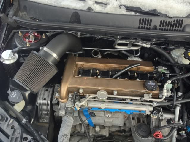

Awesome how do you like it? And what bolt Ons do you have? Or even better have a picture of your engine bay? Lol
lsj-t ftw haha not finished yet
