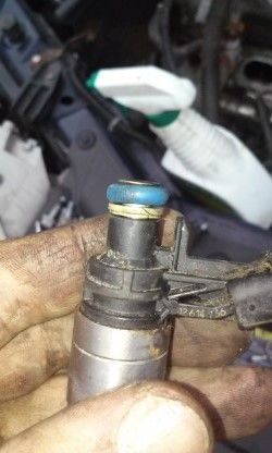

LDK engines had LNF injectors and white seals. LHU engines had OPELS and black seals (this is the reason I went LHU for my engine swap). if your tuner knows what theyre doing and they say you have stock injectors id say you have stock injectors. when I did my swap, for kicks I left my injector settings alone and did a datalog and my trims were all wonky, pulling lots of fuel. when I changed my injector constant from .028xxx to .025xxx my trims were much closer.
you might be able to get under the car and pull the foam away from the fuel rail to get the part number that's on them. they'll look the same other than the part number stamped on them. here's a pic of my LNF injector (fuel rail end) I took when I did the seals on my car, a month before the engine blew.

Don't remove the Opel injector from the rail if at all possible. There's a little straw type tip on the end, like above the blue o-ring in the injector in the pic on the Opel's. They break very easy. Guess its anyone's guess if a new Opel injector/rail assembly has tips already broken inside or not. I was very careful pulling mine out and they still were broke. Don't know if I did it or not. There's a bit of a debate as to whether it makes a difference or not . ZZP says it may cause high RPM misfires. Some say it doesn't. Strange thing is the LNF injectors have no such tips.

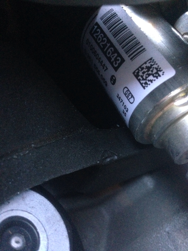

Opels?

Google said it was from a Vauxhall Astra or Opel... so id think so.
I saw the same thing. I guess the part I don't understand is that everyone calls them opel injectors but these arent the ones that "flow" more. So apparently it seems there is two versions. But my questions is are the seals on the ones I have e85 safe?

I bought it off mongo and he states they are the same opels ZZP sells. Which ZZP site states they flow more. Mongo told me he used they on his car with e85.
my tuner is KMO43 which im sure he will chime in soon and state that my logs were spot and on.
From all this I am gathering that they are NOT the ones that flow more but I do imagine the seals are e85.

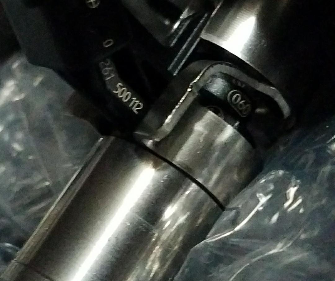

These are opel part numbers from what I understand if you get a chance to look I would check for this

basically what flash said is true, the LDKs just have the better seals not the higher flowing opels
