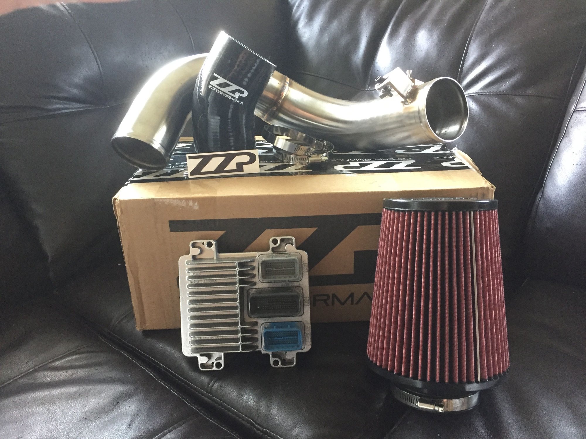

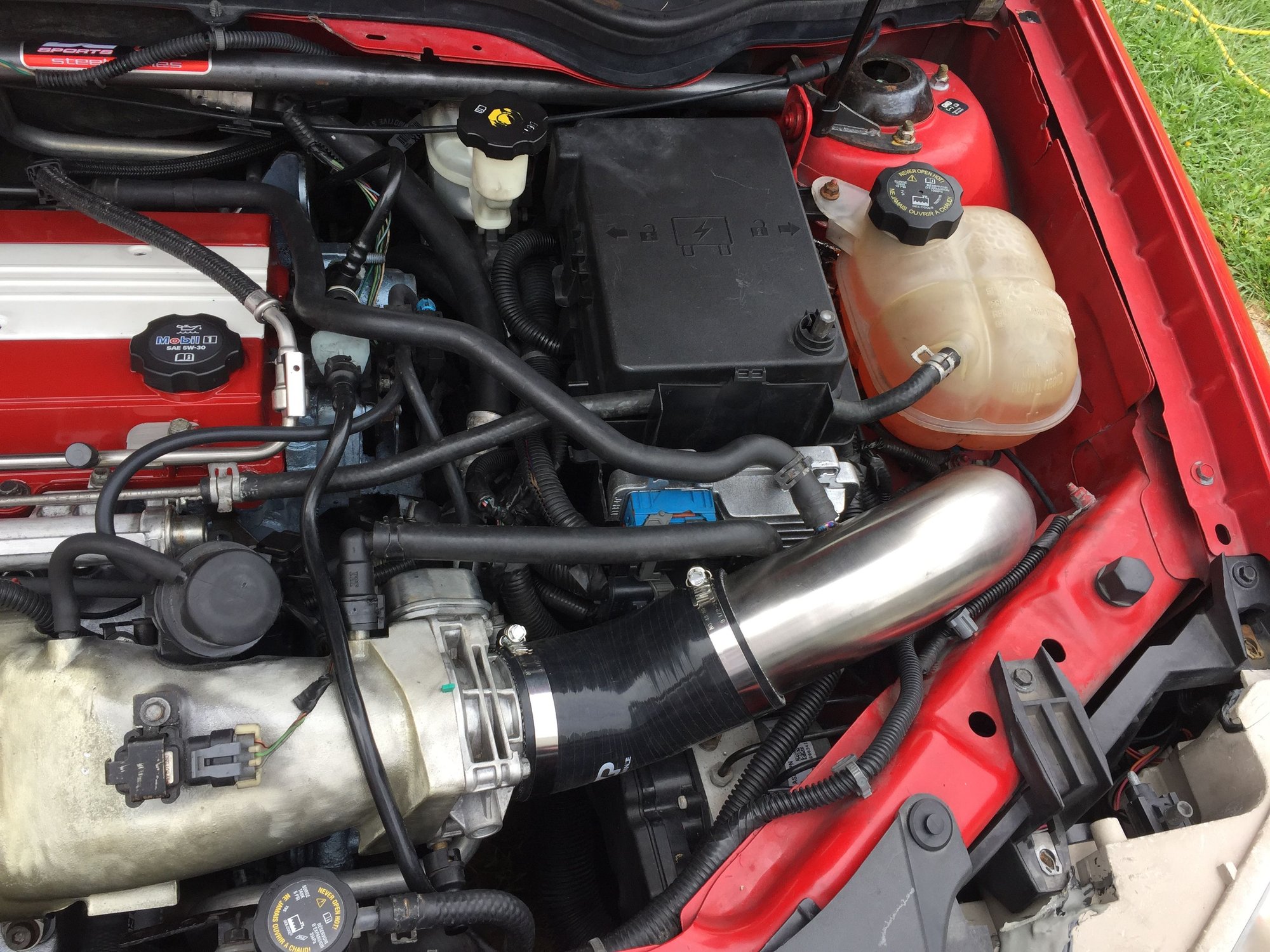

Zzp intake
Also got a zzp intake for her along with a tuned ECU since the other one turned out being junk. Supercharger is LOUD ! Lol
