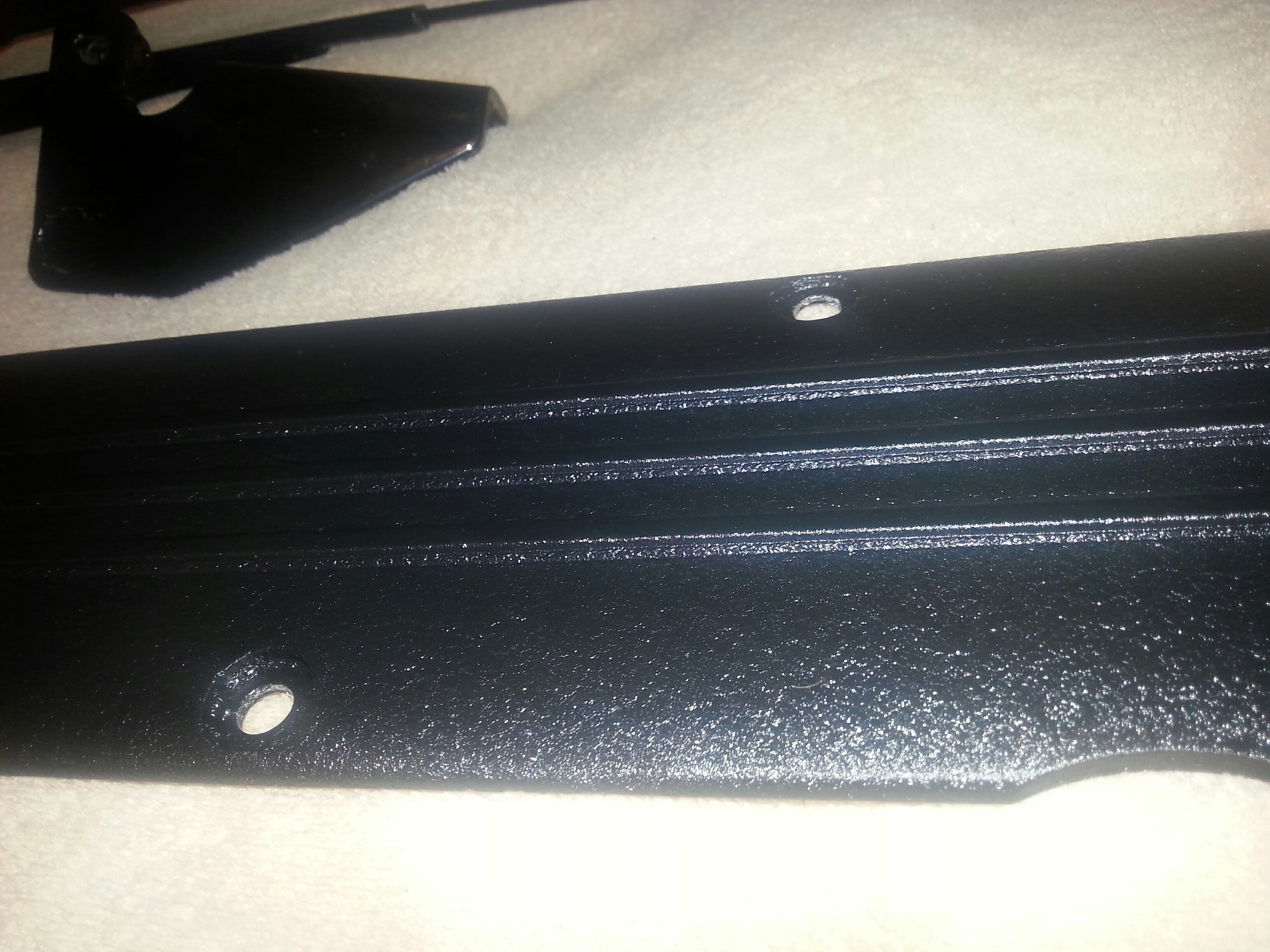

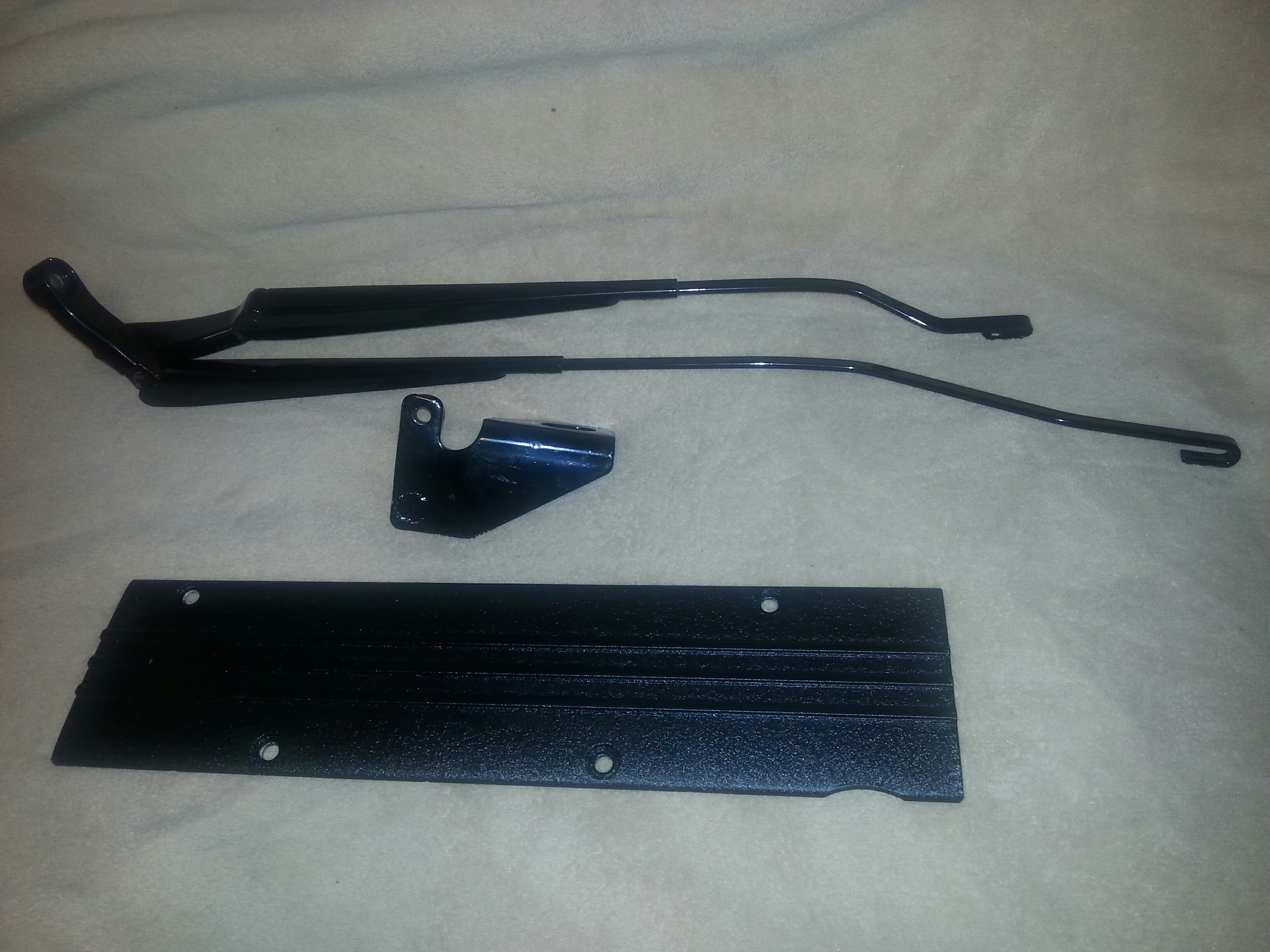

Right now I have an intake manifold and supercharger housing and snout out for powdercoat. He is going to run them through a high pressure parts washer then media blast them before they get coated. (He knows not to media blast inside the sc housing, it will be masked off)
If a powdercoater isn't heating up to at least 400 degrees F, its time to find a new guy to go to. I have an intake manifold on my cutty that wasn't done correctly. When it was put back on the car, the foam on the back of a cover left an impression in the powdercoat once the engine was up to temp.
Good powdercoaters that take pride in their work are hard to find. I had the coil pack cover for my lsj done yesterday, he coated it and stripped it twice before HE was satisfied with the finish.
