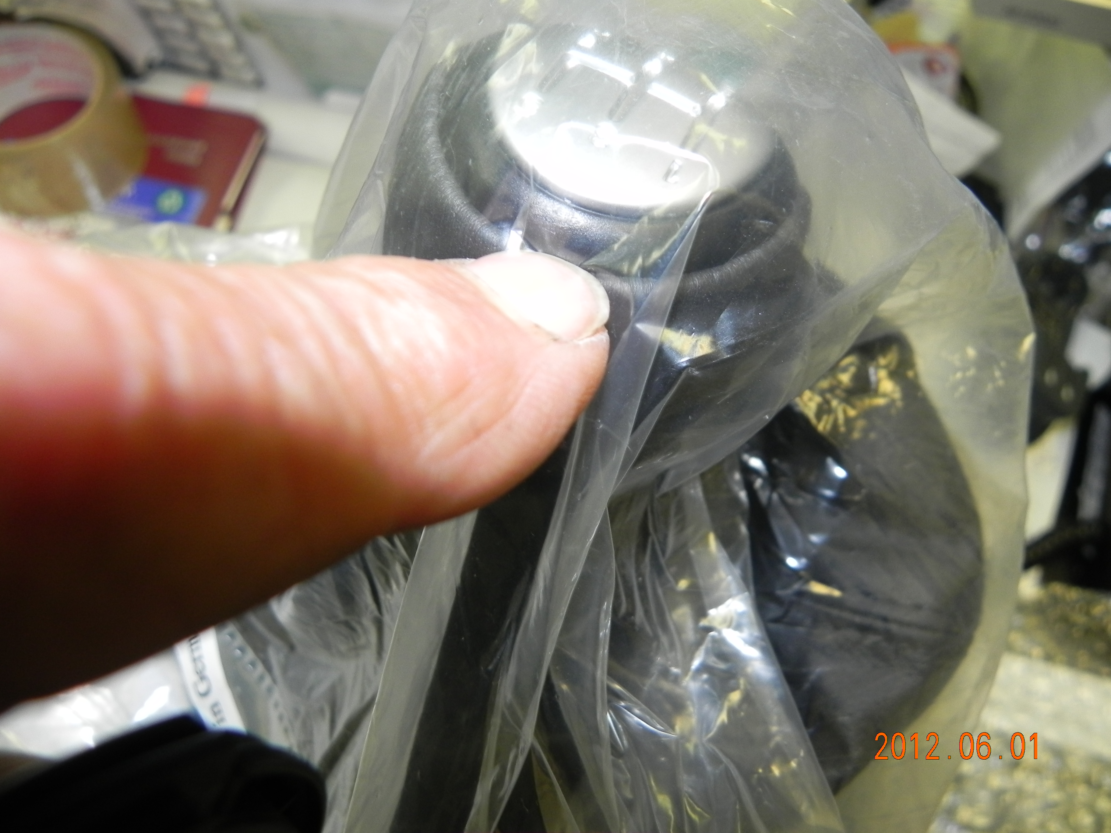

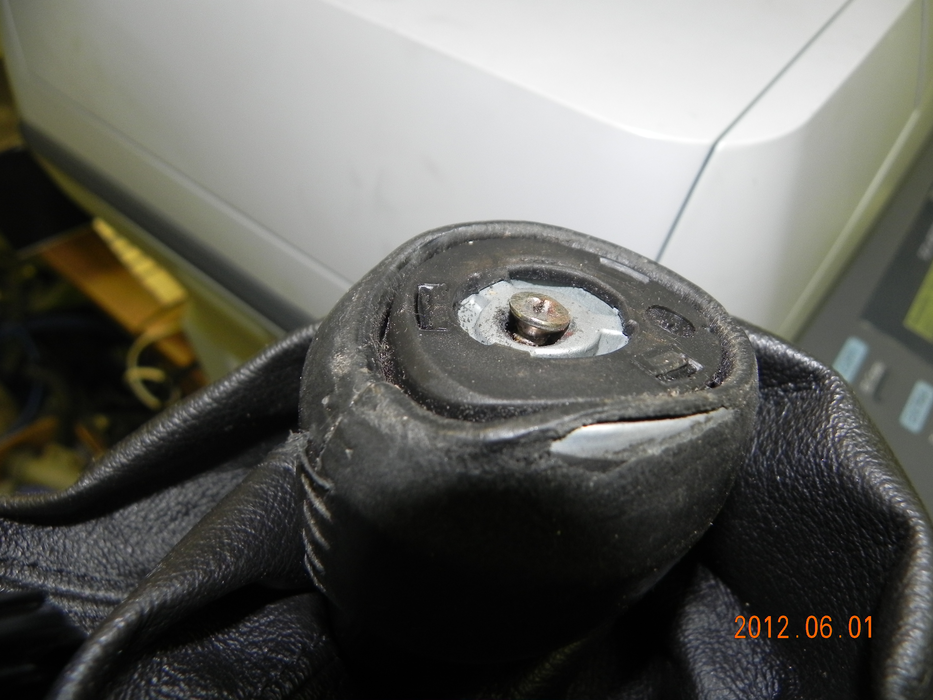

you dont say what cobalt you have. Remove knob. replace boot. replace knob. U r done.
on M 35, remove top cap, drill a hole if no screw, tap, add screw and use a 3 jaw puller to remove knob. pita.

if its a 2006 ss sc then get your drill out. if its an F23 trans in an 2006 SS coupe normally aspirated, its different to these pictures.

You don't need to remove the console. Pop out the cup holder. Reach your fingers back and pop out the boot. Then do what John told you to get the knob off the shifter.
