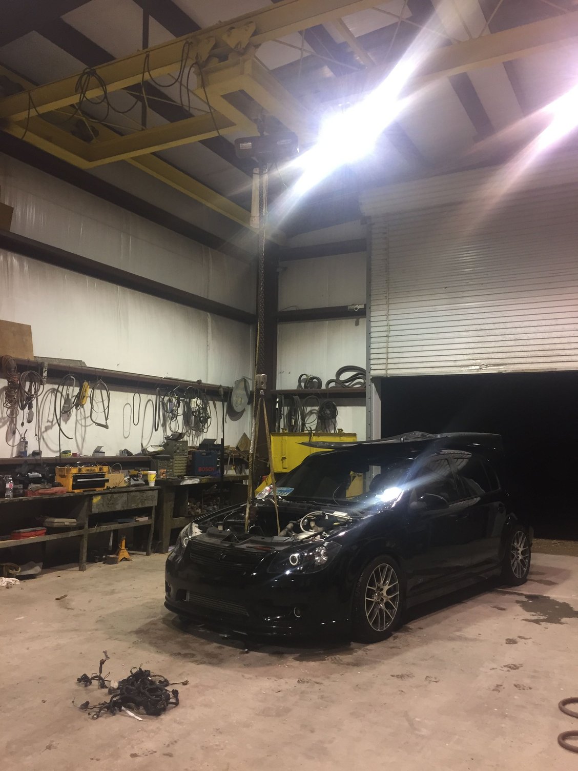

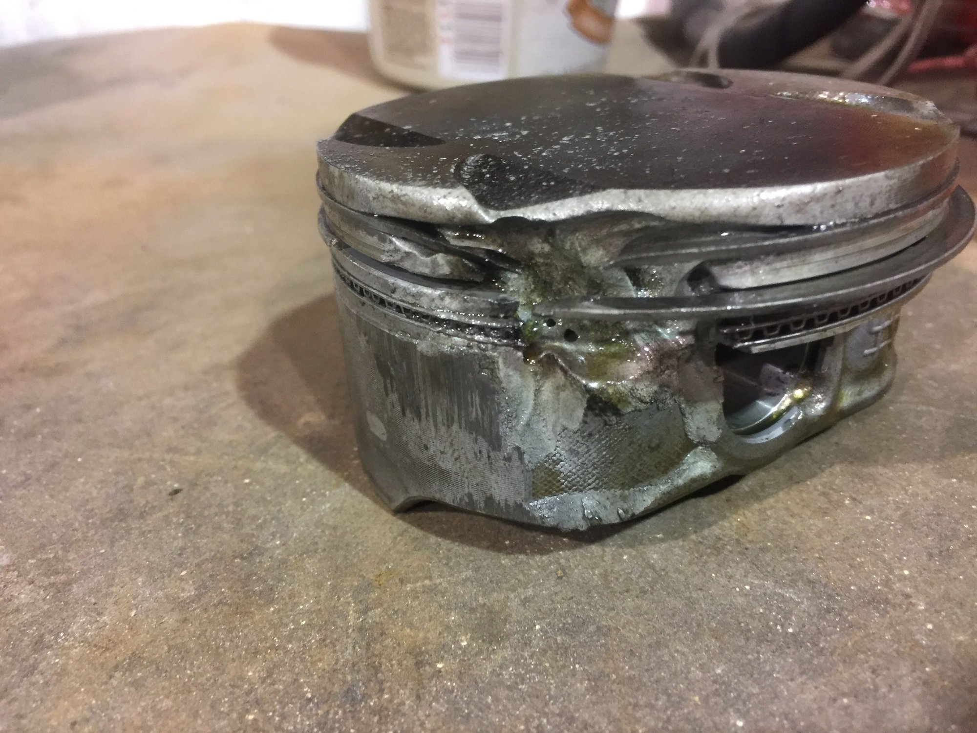

I joined this page in 2011 shortly after getting my cobalt in January of 2010. I decided to finally make a build thread since a lot of new things are happening to the car. Most of you know I ended up putting an m62 on it back in 2015. Turned out pretty decent for the setup. Put down 264/266 on a mustang dyno at tx2k16 and managed to break 12s in the 1/4. Not bad for an auto. Then put the tvs on it this past may. Ran it once and got low 12s. Didn’t get to enjoy it much because we ran into a few problems. My crank pulley broke off while I was driving it. Not sure how it happened. Hurricane Harvey flooded it so it was down for about a month. Gutted the car and cleaned it really good and replaced the carpet. Added a few extra goods while it was down. Got it all fixed up and shortly after ended up melting a piston and cylinder sleeve while racing an lnf. Car went lean and we weren’t watching. Oops. That was beginning of October. Instead of replacing the piston and sleeve it’s getting a built gen 3 and a built auto trans. Might as well build it now. Almost got all the parts for the bottom end. Car should be running sometime in January. Most will laugh but it’s being set up for the 1/4 mile. A trans brake and wot box will go in also. After everything is complete the goal is to run low to mid 11s. Not really too concerned about a dyno number but it should be around 400whp. Here’s my setup and some pictures. I’ll update this post as the build continues.
