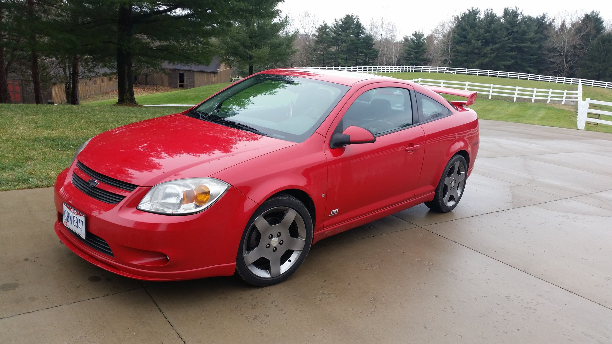

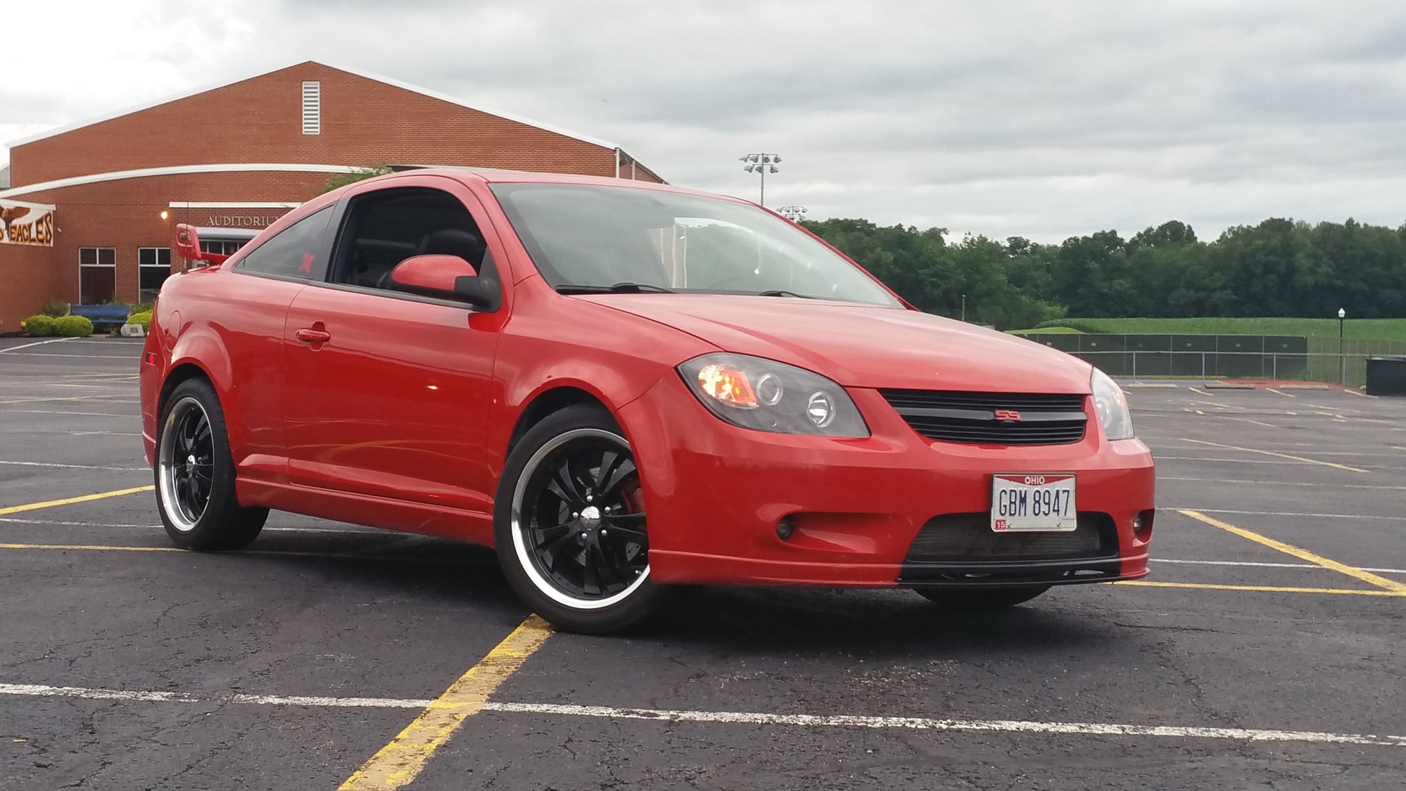

Ok, I know I'm no expert on the SS platform, but I feel like I know enough about it, in addition to knowledge gained from working on other cars, to do a mild build on my SS. So please, feel free to voice opinions, give suggestions, and add anything posted in this thread.
So I bought my 2006 Cobalt SS/SC used at a dealer for $6,000. It had 98k miles on it. It had a GM stage 2 factory, a p.o.s. used JVC single din headunit, a no-name 3 gauge pillar pod, Autometer wideband, and Autometer voltmeter on it when I bought it. It seemed garage kept because there was minimal rust on the undercarriage and no rust anywhere else. The clear coat was peeling a little, but I paid it no mind. Since then, it now has 120k miles on it and I've done a little modding; GMPP catback, no name intake, ZZP 2.5" catted downpipe, ZZP front mount, ZZP short shift mod, ZZP aluminum shifter bushings, ZZP LNF shifter bracket, option B, ZZP dual pass, ZZP tune, Pioneer touchscreen headunit, Hawk ceramic pads, and drilled and slotted rotors. I've also added 18" Vision wheels and Nitto NT555+ tires to it. It's Victory Red with the Evo mod, black spoiler, black housing halo headlights, black tailights, black side markers, black 3rd brake light, 50% tint on the front, 20% on the port and rear, 6000k hid headlights, and 3000k hid fogs lights. That is what I have done thus far.
Now that it is winter, I'm putting it up. It's going into my garage and getting overhauled. My plans are as follows, from exterior to performance: fresh midnight black paint, hi-shine 2 stage clear, new grille, black housing OEM headlights, LED Concepts halo rings in red, led tailights, led 3rd brake light, 2.8" pulley, modular hub assembly, ZZP shorty header, ZZP 3" intake, 60# injectors, LSJ upgraded clutch, lowering springs (undecided), short throw (undecided), a new tune, and maybe a few other oddside and ends like arm rest, shorty antenna, etc. Hoping for a little more power/torque, and a little bit more firm ride. Hoping for at least 280whp. I'm also gonna clean and repaint parts of the motor and trans along with parts of the suspension and brake components. Not show car quality but something that'll shine up nice and have some power to back it up with. Thoughts, comments, and concerns are welcome. Thanks guys!
