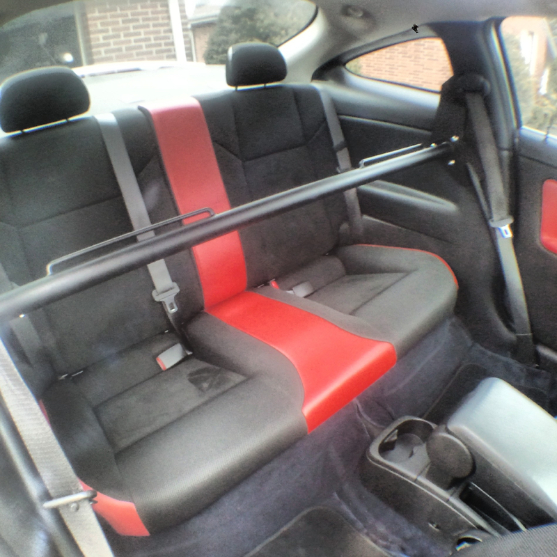

the upper seat belt mount on the sedans is adjustable. The coupes is not. There lies the first problem. Second the b pillar for the coupes is located back way farther than the sedans. The cross bar the goes horizontal across the car would not work. The seats will be in the way.
I had one on my G5. It was nice but it rubbed the crap out of the interior plastics. No matter how I shimmed it. I planned on putting it in my LNF coupe but sold it once I realized that it rubbed

damn ok
