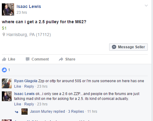

He PM'ed accusing me of making stuff up about his "sarcasm" on Cobalt Nation, so I screen capped it. Yup I'm making this up. Kids these days
