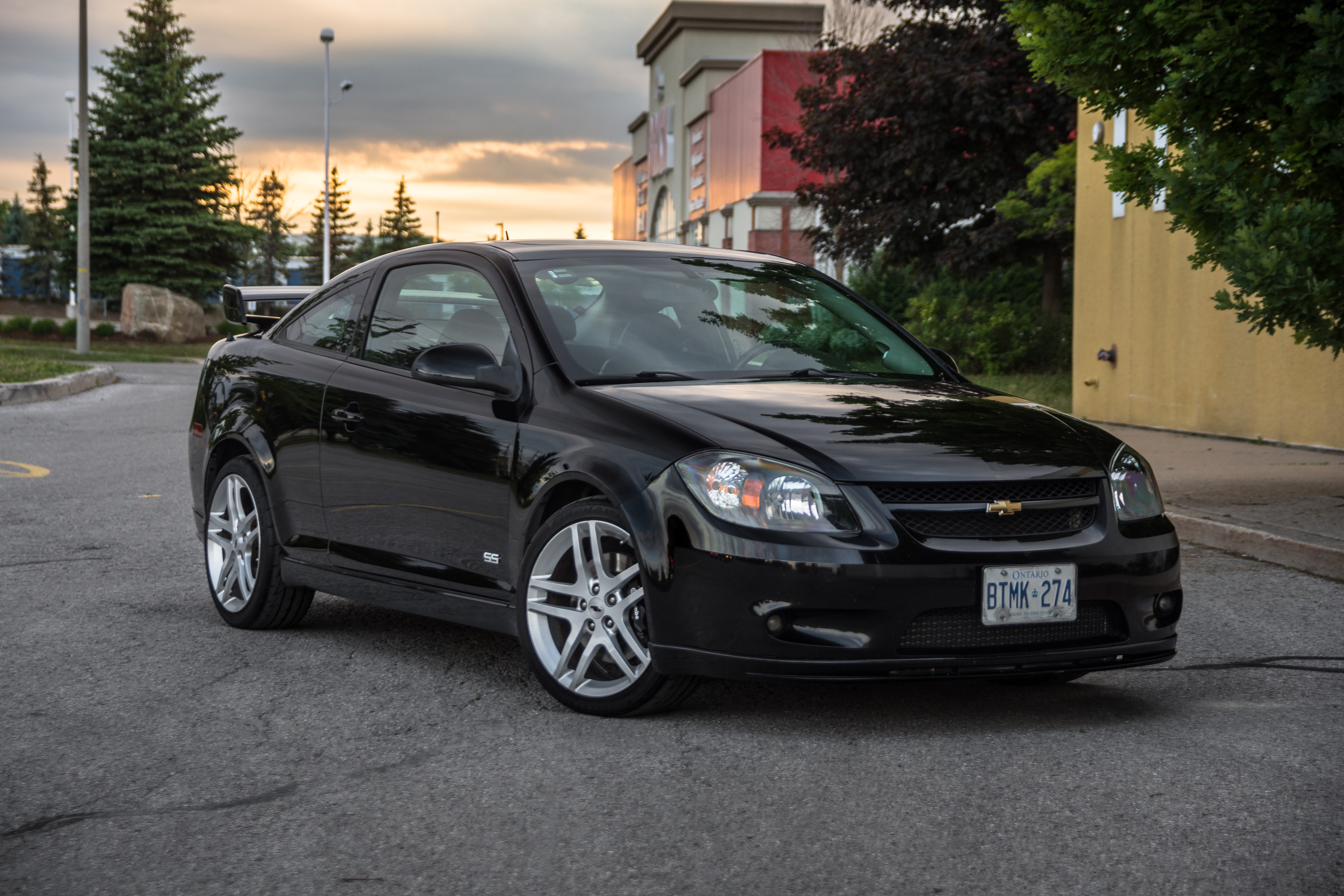

After looking for another Neon SRT4, I managed to find this 2009 Cobalt SS/TC. I'd never considered buying a Cobalt prior to this, I didn't hate them or anything, just never really thought about them. This one was very clean and well kept, and I was tired of searching and searching for Neon's just for them to be trashed when I showed up.
I looked at the Cobalt and drove it. I was still unsure if I really wanted to jump into a new-ish platform (ecotec). After watching a few ZZP vids, and reading through a few threads here, I decided to buy it. To justify the purchase, I had to use it as a daily/commuter since it's much cheaper on gas than my "daily" Ram.
Originally, I was just going to drive the car, maybe hit the track once or twice, and then probably sell it and continue looking for a Neon. After a week or so, I decided I could at least do a GMS1 tune (or similar) and leave everything else stock. Then I saw the ZZP black friday sales, and the discount on the intercooler and charge pipe kit was enough to make me buy it. I paired it with an intake. A week or two later I caved and ordered a Megan Racing downpipe. Then shortly after that came across a brand new Magnaflow cat-back exhaust for 1/3 the cost of retail. I even managed to pick up some black housed headlights.
The car already had 3 bar map sensors (but not tuned for them), and ZZP lowering springs, which I think are a 0.75" drop in the front and 1.25" in the rear. They ride pretty stiff for how high they still sit. I don't think I'm going to go with coilovers or anything, but who knows.

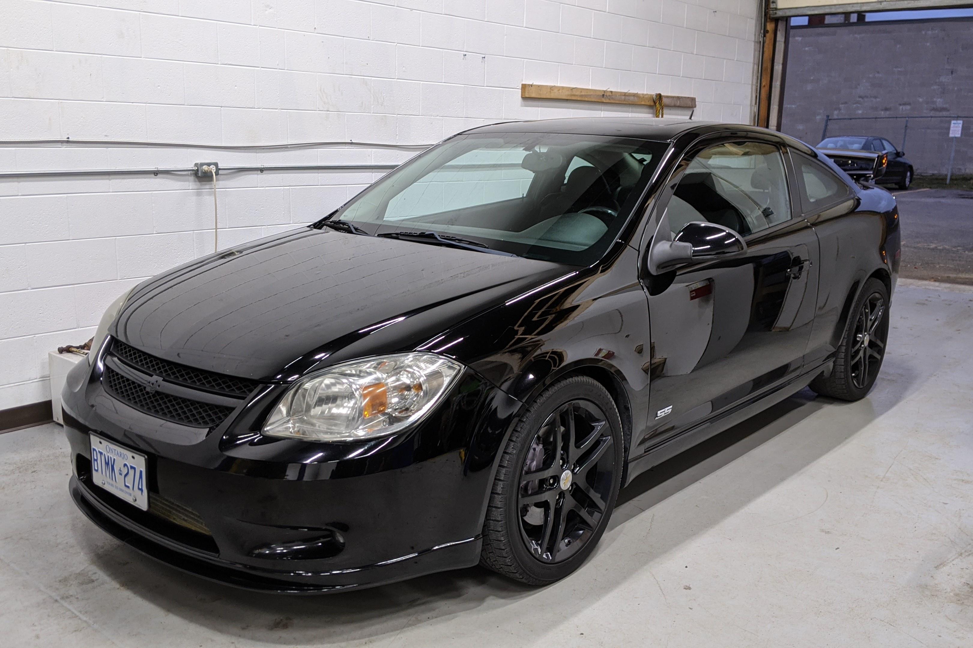

Here are some pics of when I first picked it up.

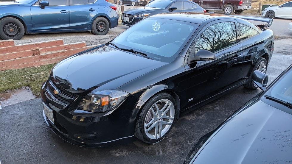

I didn't hate the black wheels, but I prefer the OEM silver look. Found some and picked them up.

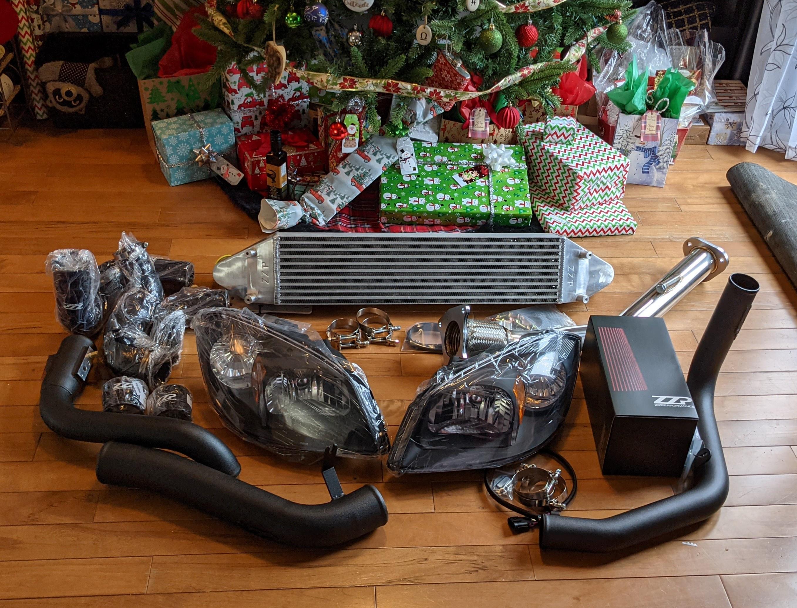

Most of the parts, waiting for Spring so I could install them.

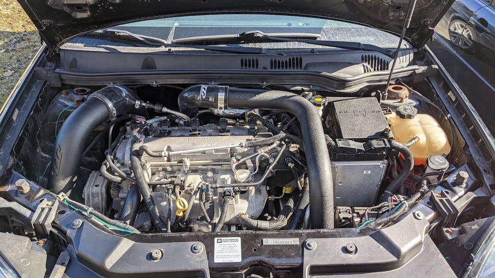

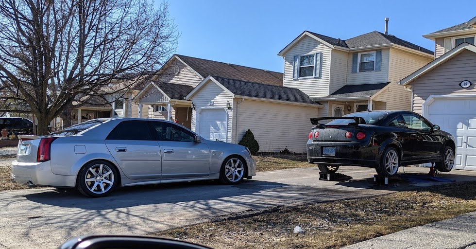

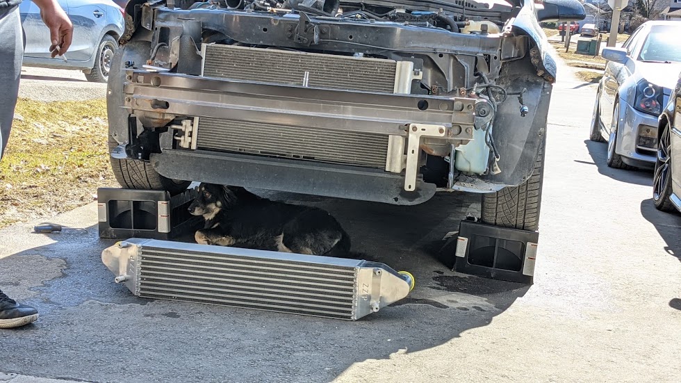

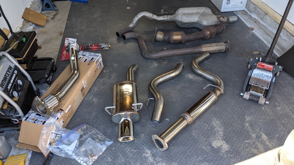

Spring finally came this past weekend, and I had an opportunity to install everything. It went fairly well, I thought I would have to fight rusty bolts, especially with the exhaust, but I didn't. I wouldn't be surprised if this car was modded before and placed back to stock. It looks like the exhaust had been off before, and there was a bolt missing for the upper charge pipe. It would make sense as to why it had 3 bar map sensors already too. I'm not worried, the car runs and drives great regardless, and I've put about 5,000 km since I bought it in November. I just need to arrange for a tune now.
I bought some universal honeycomb grille for the intercooler. The car didn't come with the factory one, and as much as I like the intercooler showing, part of me also likes it hidden.

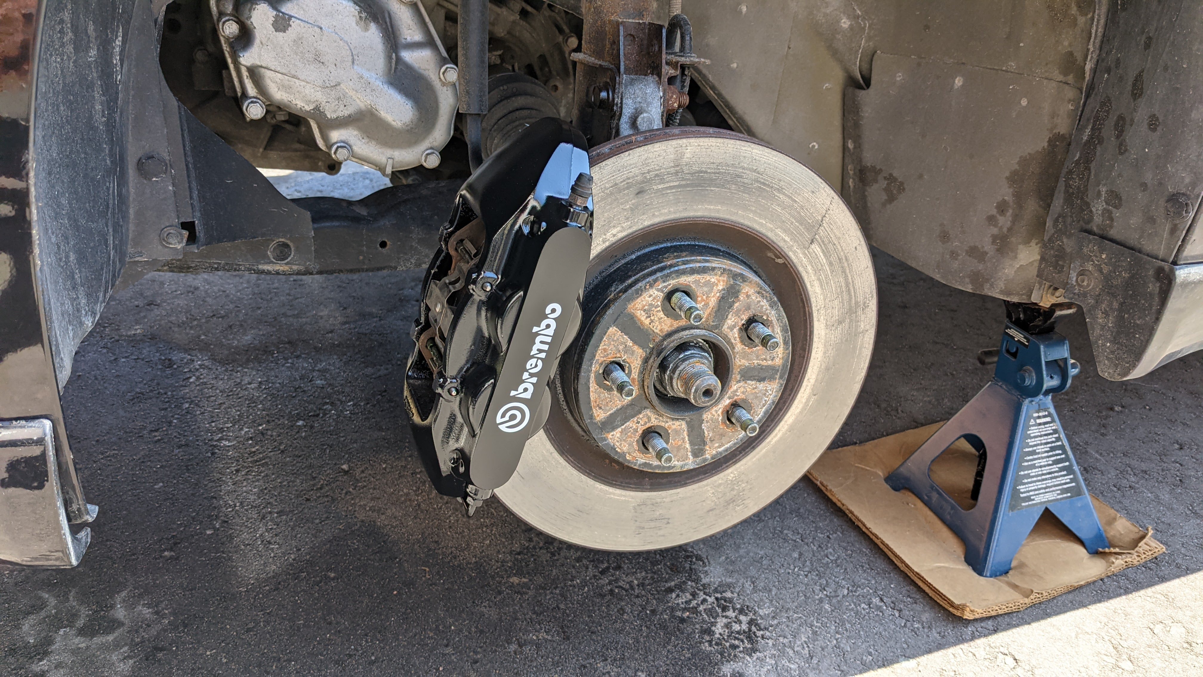

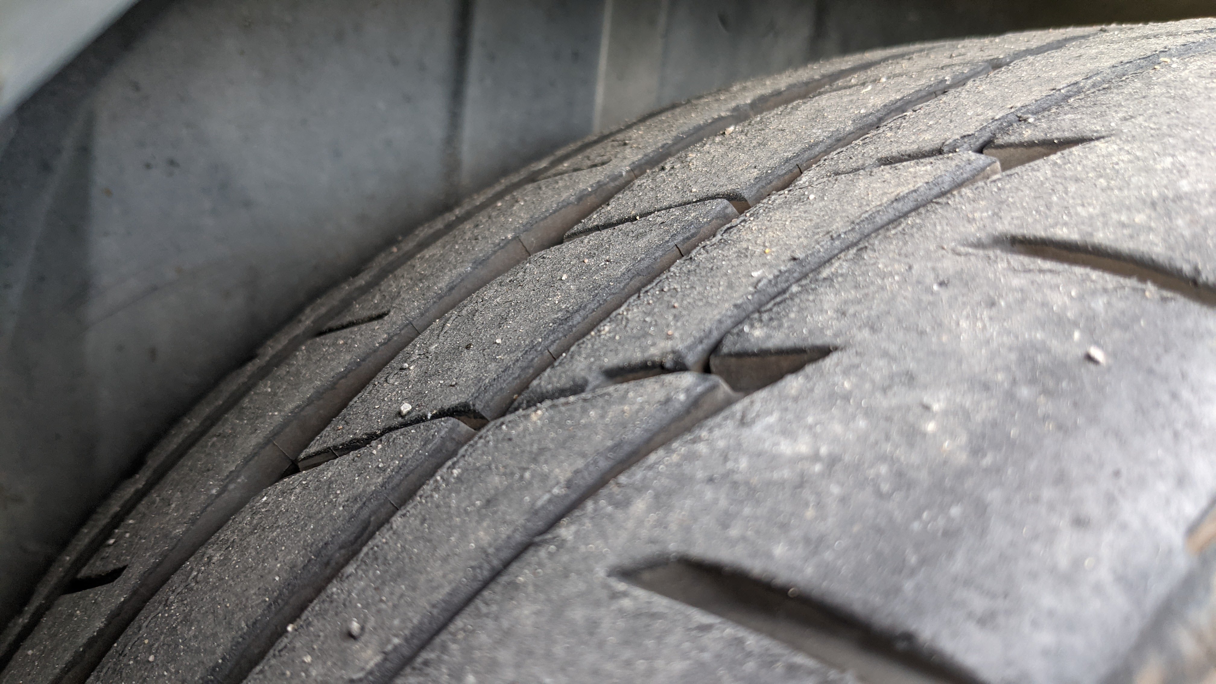

I needed at least 2 tires for the Cobalt, and taking into consideration that this is a daily driver first, and some spirited driving and a few track days second, I bought 4 Indy 500's in 225/40. I find they have a ton of grip for a 300+ tw tire, and don't have any issues in Spril/Fall (cold or wet). They're also the most affordable "name brand" for the performance.
The calipers were looking pretty rough, so I ended up hitting them with some black caliper spray paint. Added some Brembo stickers, and then finished them with a caliper clear coat. They turned out well, and much better than before of course. Took a minute to clean and lube the pads and pins.
I have a tune booked for later this week, so hoping all goes well. I did order and receive a set of NGK 6509's, as recommended by my tuner. He said to gap them 0.030-0.032".

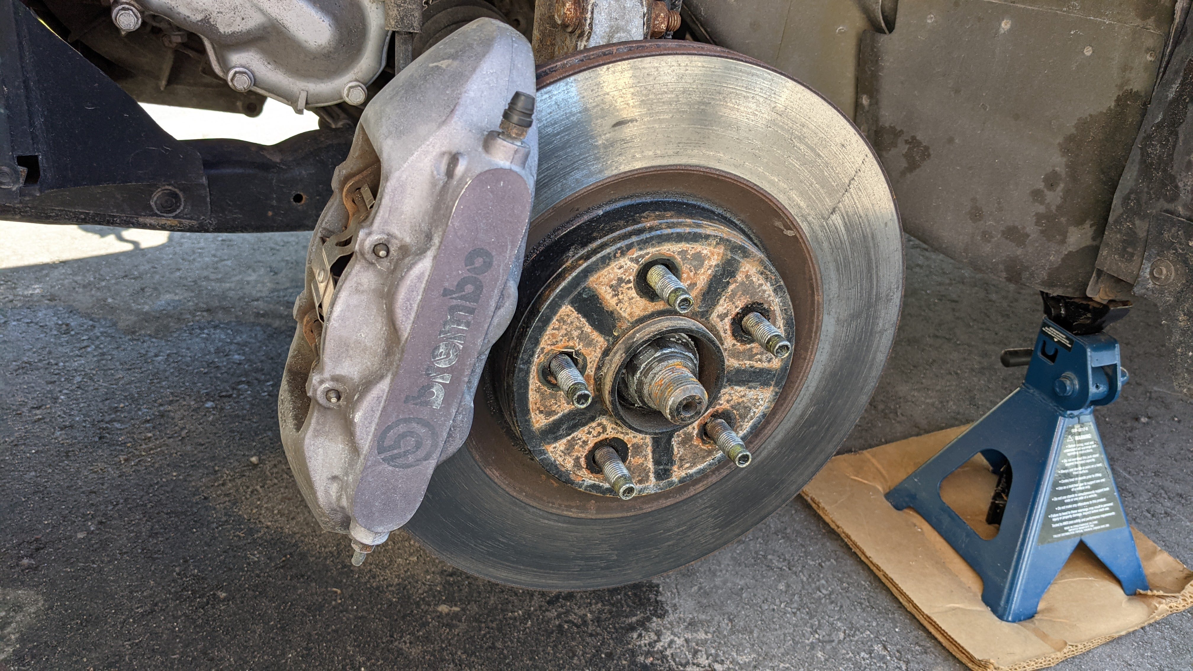

Had a light knocking on and off in the front. Figured it might be a control arm or maybe the trans mount or something. Put it in the air and found out a common problem with these cars. The cage nut for the LCA/frame is blown out and just spins. It's not tight enough to keep it perfectly in there, so that's where the knocking comes from. Looked up the ways to deal with it, and I'm not sure what I'll do or when I'll do it. With tracks shut down, I'm not overly concerned right now. I also have stuff to do on my V, my Ram, and my gf's car, as well as the house.

Cleaned up and painted the rear calipers to match. My ebrake stopped holding a couple weeks ago, on inclinces. I tightened the cable up front, checked, cleaned, and oiled the lever on the caliper. Pads have tons of life, and the caliper isn't seized. I guess all that's left is a stretched cable? Another thing I don't care enough to fix right now, it'll be added to the list.

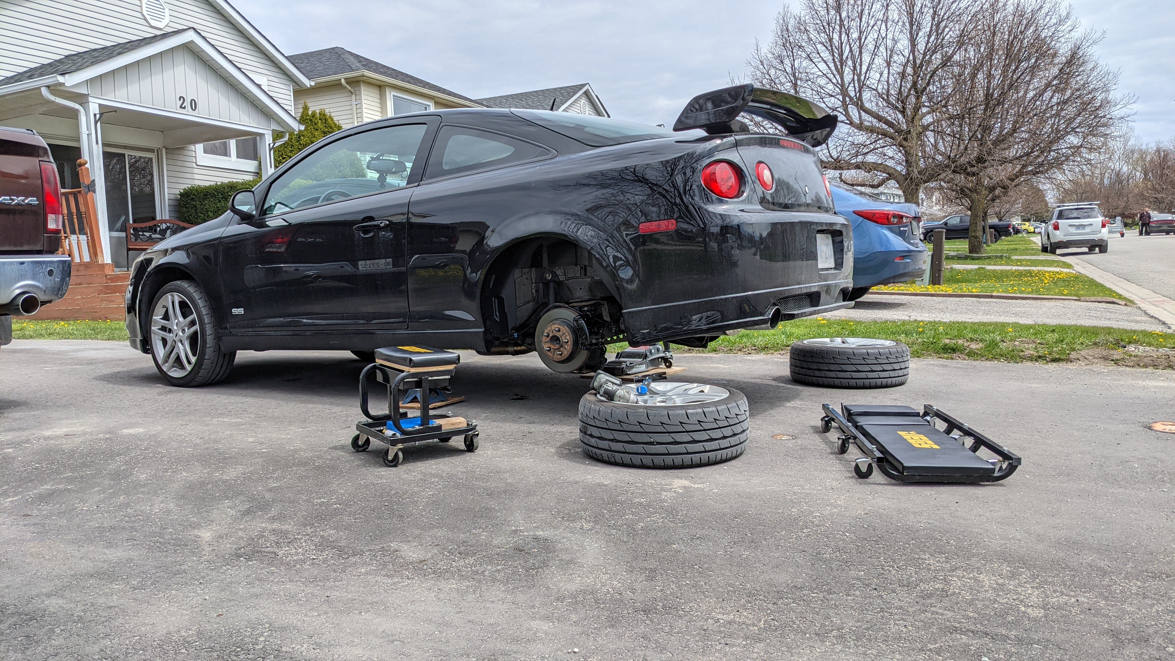

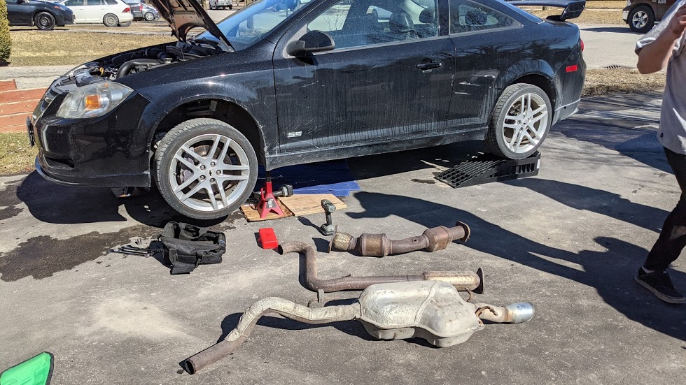

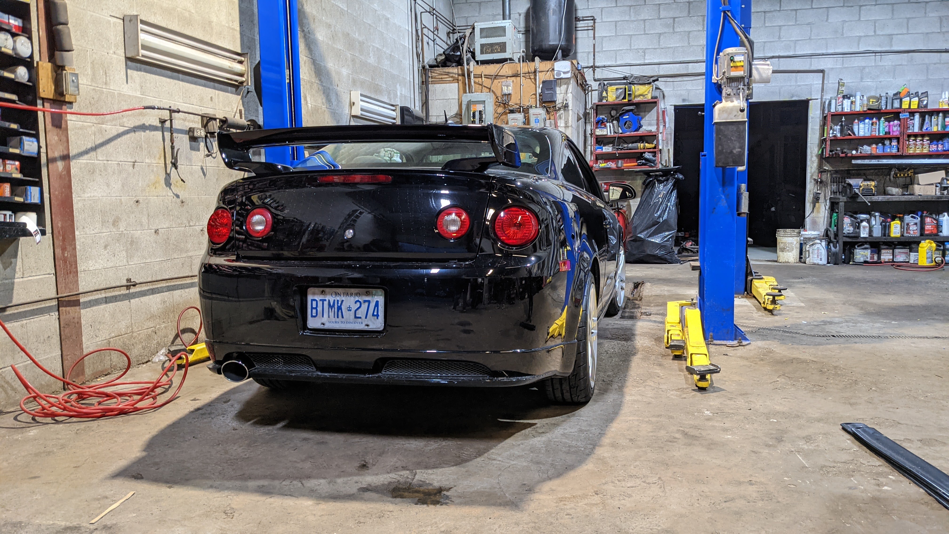

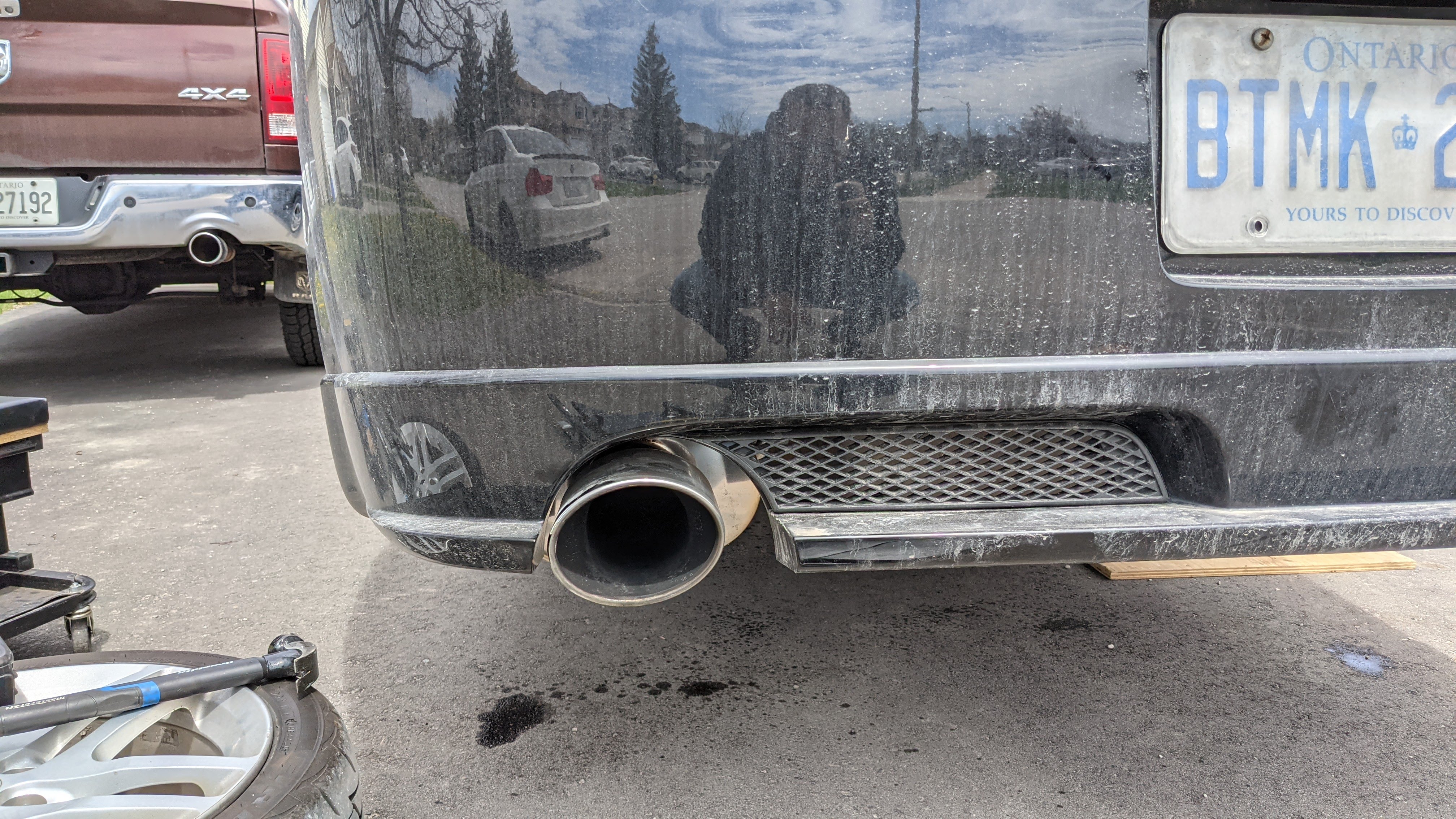

While I had it up, the muffler alignment has been driving me crazy. I took this damn thing off 5 times, and still couldn't get it any better. I adjusted the section over the axle in every way I could, nothing. Managed to level it to almost perfect, then I just said screw it and threw some zipties to hold it centre.

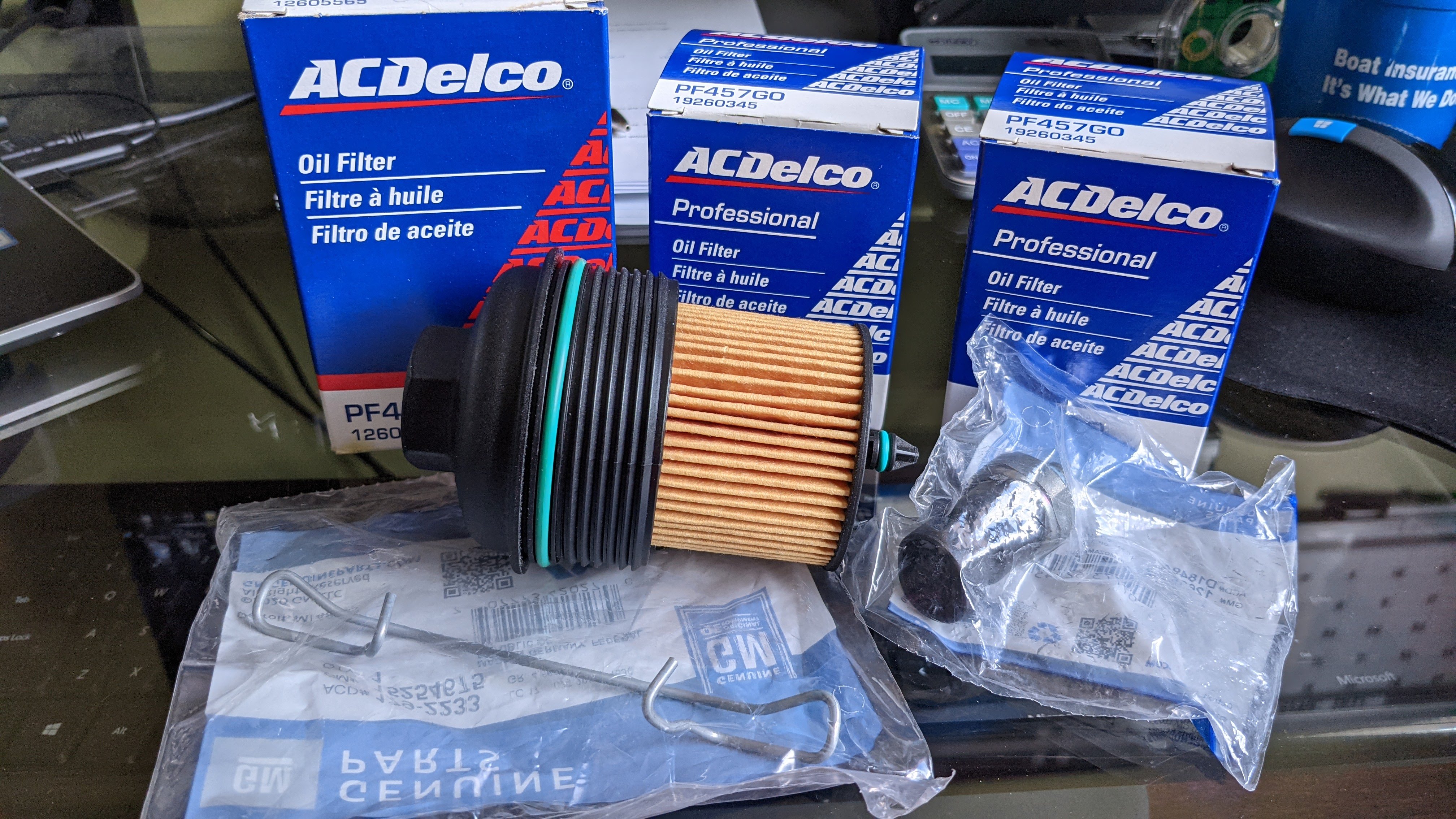

Picked up some oil filters, a pad clip since one is missing somehow, and an oil pressure switch/sensor. Mine blinked the other day, so I'm assuming the switch is bad or needs to be cleaned up. Praying at least haha. Bought a new OEM one since they're cheap.

Yeah, to echo the others, sounds like you might need some work on that tune... you shouldn't have any real lag after a shift.
A few ways to go about it.
1. You can stick a screwdriver in there in between the cage and the nut and try torqueing that way.
2. You can just knock the cage off (might need an air hammer) and then stick a wrench in there on it. This is what I did. A little bit of a PITA on the driver's side.
3. Do number 2 to remove the stock crap, and then use a nyloc nut in it's place. Still a PITA on the driver's side.
4. Do number 2 and replace with a new caged nut (can order from CED). I did this on my latest rebuild. Not sure that it's all that effective.
It's a terrible design.

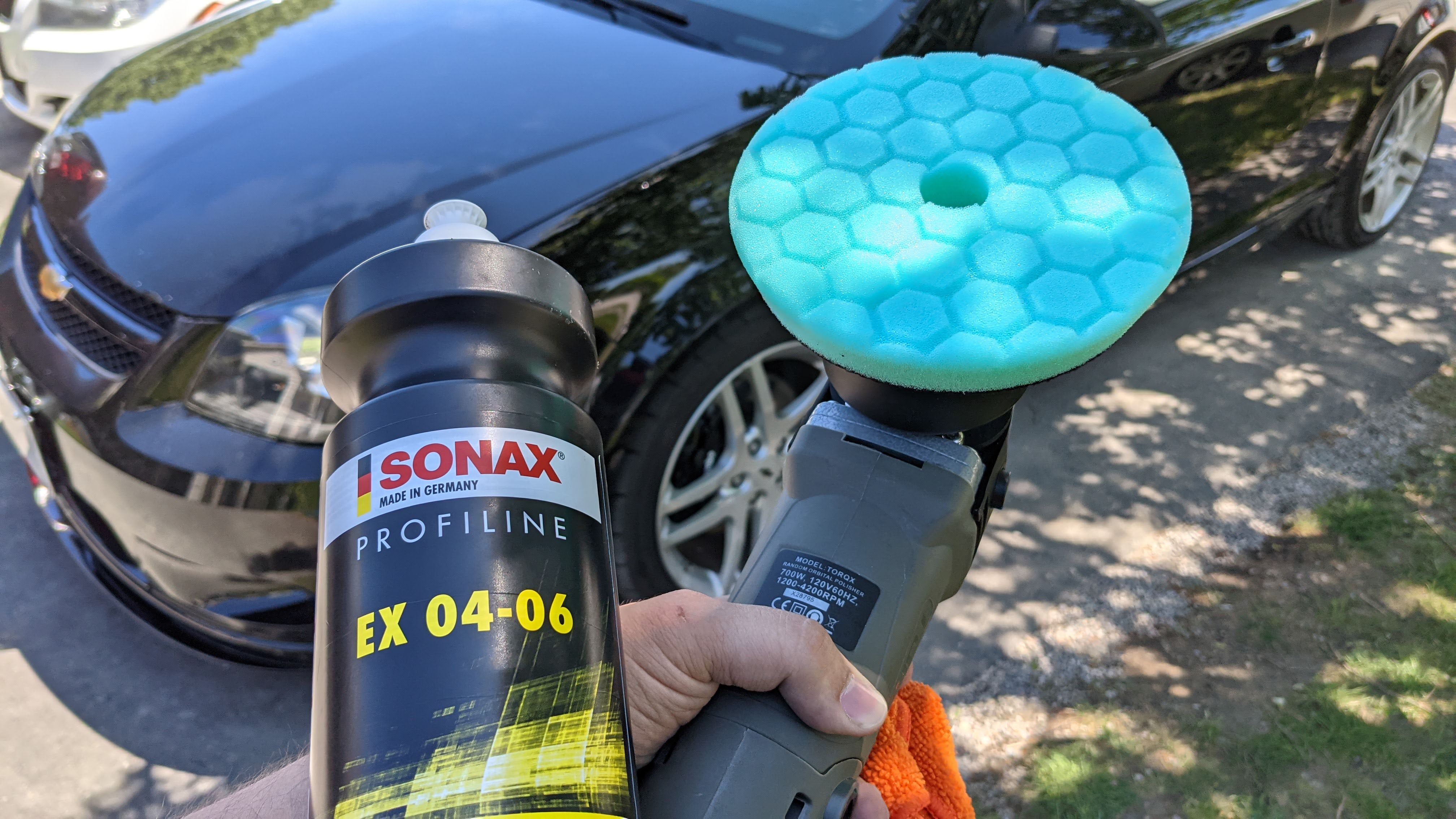

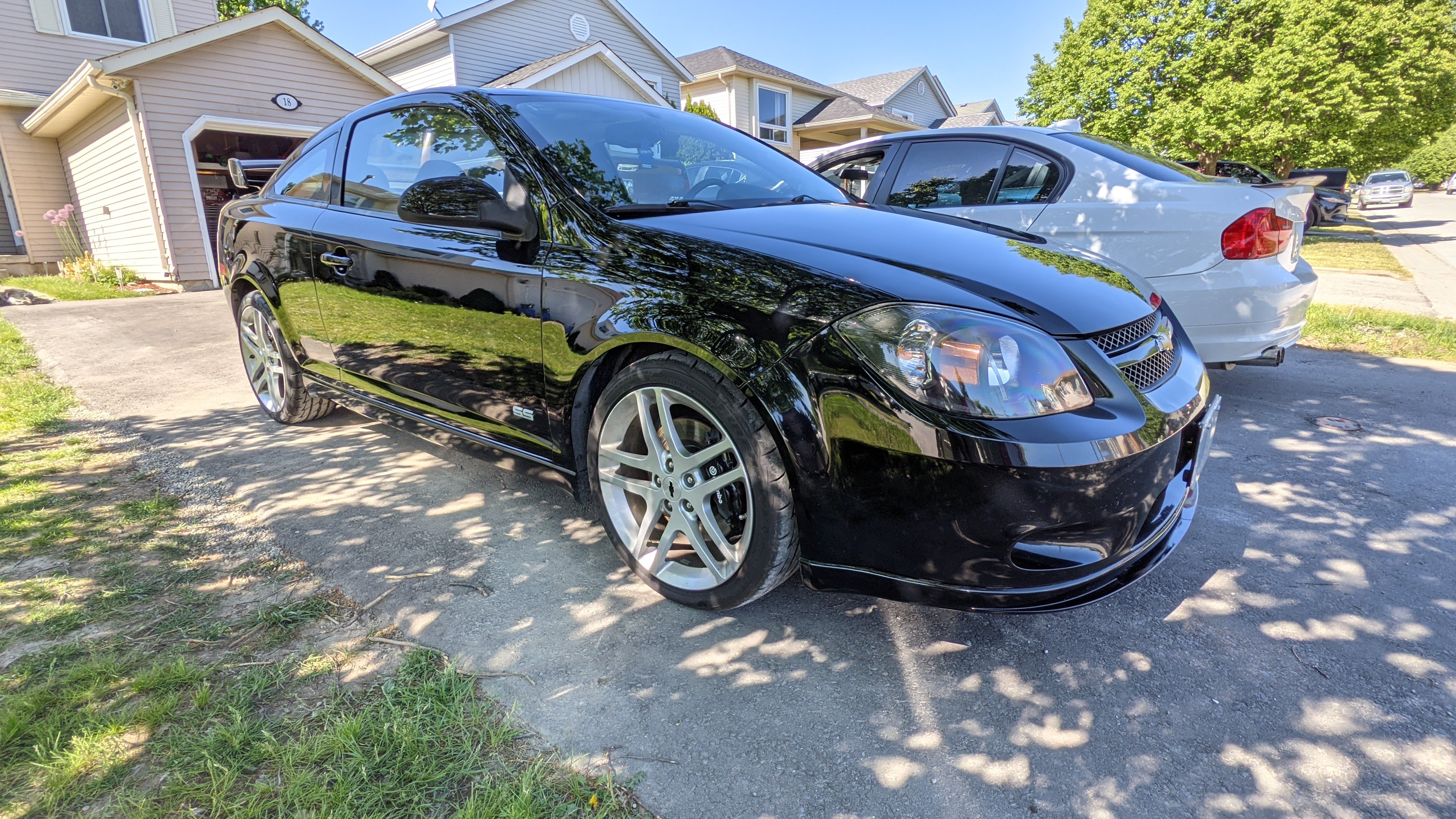

Near the end of May, I clayed, polished, and waxed the Cobalt. Looking back, I really should have cut the hood, it's still pretty bad (in my opinion), but I may do it another time.

Finally got out to the track, and I absolutely love this car. The first session, I was pretty upset and hated it. But by the 3rd time out (I do 5 laps per session), I figured out how the car wants to be driven. Fighting the torque steer was pretty annoying, but I figured out the sweet spots to come out of corners strong, but still fast.
The brakes were the biggest set back, as I didn't address them prior to going out. I couldn't brake too late, and after 4 laps, they needed a break. The stock struts with the ZZP springs actually felt really good, and I have no desire right now to change them. I did order some front pads the next day, and I already have high temp fluid waiting to go it. I was hesitant at first, as I listed the car for sale and I don't want to put anymore money into it if it's going to sell.

Car looks good! You might look into the adams or chemical guys line of stuff for paint correction. I just did this to my ram as it was bad. I then used adams ceramic coating and man the shine is awesome!
Old Jul 13, 2021 | 03:43 PM
ThatKevinC's Avatar
Joined: 03-23-21
Posts: 9
From: Ontario
I have a few CG products, but I hate their compounds and polishes. I still use their P40 quick detailer, it's definitely my favourite, and I like their VRP for interior dressing. I also liked their Jetseal and Pete's 53 wax combo, but now that they've doubled the price on it, I probably won't buy it again.
I really like the Sonax line up of compounds and polishes. I have a bottle of their "Cutmax" for heavier spots, paired with a heavy cutting pad, it's great. The EX 04-06 with a green pad is a really nice 1 stage minor correction and polish. Aside from the hood, the Cobalt didn't need more than this.
