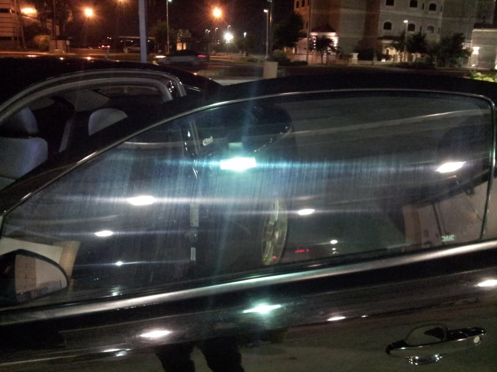

I took a picture today just so you can see the type of scratch I'm talking about. But I also found a solution for it. I guess they also call it "water damage". This is what we have to do;
1) Buy cerium oxide (15$ for 1lb)
2) Mix it with distilled water and make a little paste.
3) Get a buffer attachment for a drill (theres a kit of cerium + buffer att. for cheap)
4) Polish the glass and wipe everything off.
5) Follow up with continuous maintenance & cleaning of the weatherstrip, buy a can of compressed air and leave it in your glovebox whenever you plan on rolling down your window make sure you wipe all the dust off the side first (this tends to happen more often to people that doesn't have a garage and parks outside) I personally use a screwdriver and get most of it out but eventually getting the compressed air.
If your window damage looks like the one I have it'll work.
This is my damaged window;
And yeah, you're right. We can still get tints since they go in the inside of the glass and I don't think I have any damage there, most of the damage is outside because the dust gets trapped in the weatherstrip.
So I think I'll get tints this week and I'll just polish the glass later on. Maybe after tints it won't be so noticeable.

Mine has similar scratches
Wow we have the same scratches. I'm sure it's an easy fix bc theyre not deep enough. Remember to keep ur weather strip clean. GM sucked at designing our windows...
