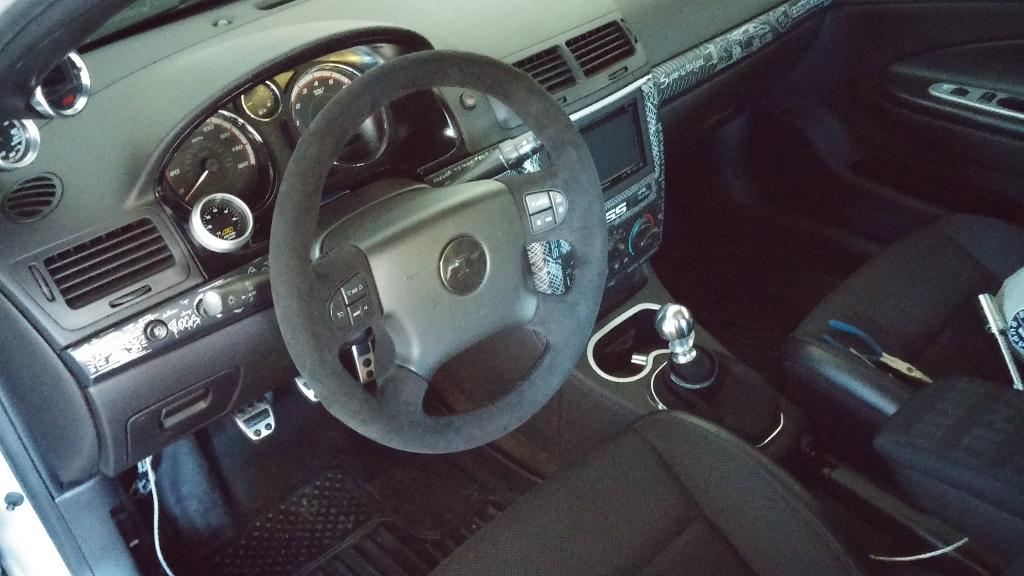

Make sure your wheel is locked in position, preferably right at the straight position as such (also a 'before' picture )

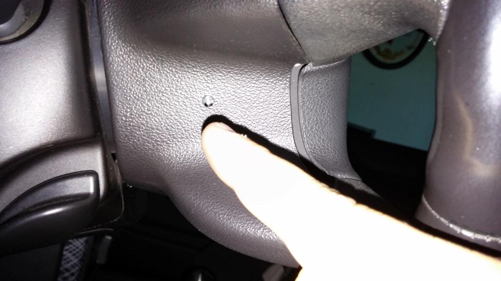

Locate the small holes on either side of your steering wheel, as shown below. You will need to take your thin flatblade screwdriver, and poke into the hole on each side. you will feel it push up on a tab, and push it in until you feel it give. this will pop out the airbag on one side. You need to then hold that side, while pushing the blade into the other side to release that tab.

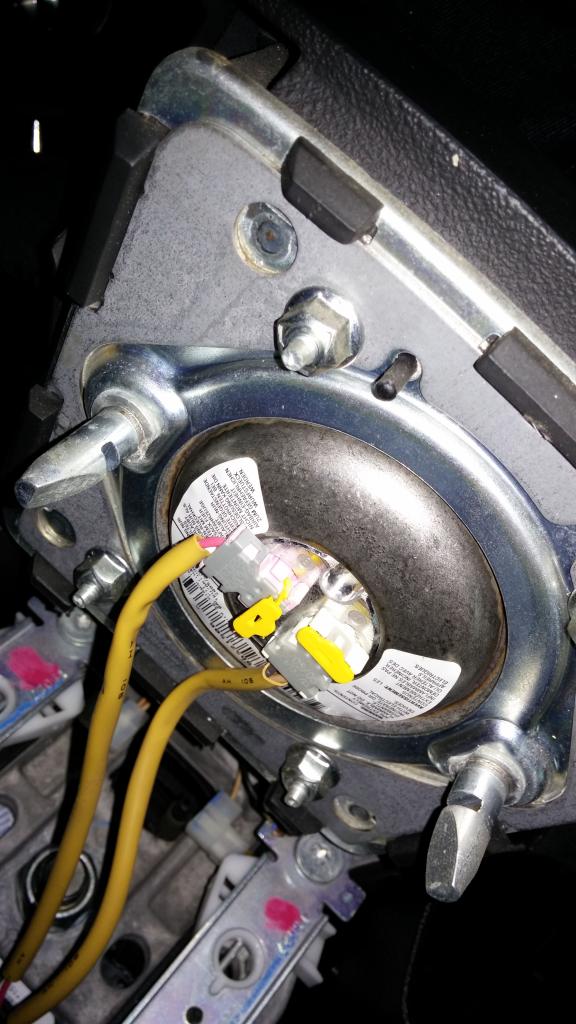

There are two connectors on the back of the airbag that need to be disconnected. To do this, take a pair of pliers and GENTLY pull up on the yellow tabs. Then, the connectors pop out with a light tug. After doing so, ever so gently put the airbag on the ground and slide under the car, out of the way.

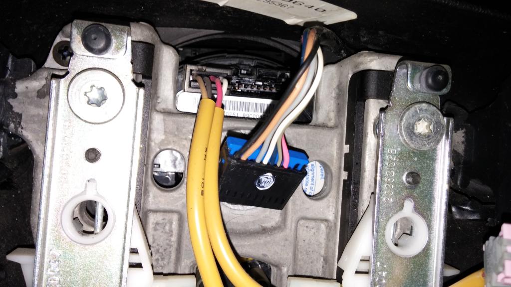

Next, there is the steering wheel harness. This needs to be unclipped.
NOTE The connector is on the steering wheel clockspring, and the clockspring will spin freely once the wheel is removed. be careful to not let it move much or at all, for ease of reinstallation.

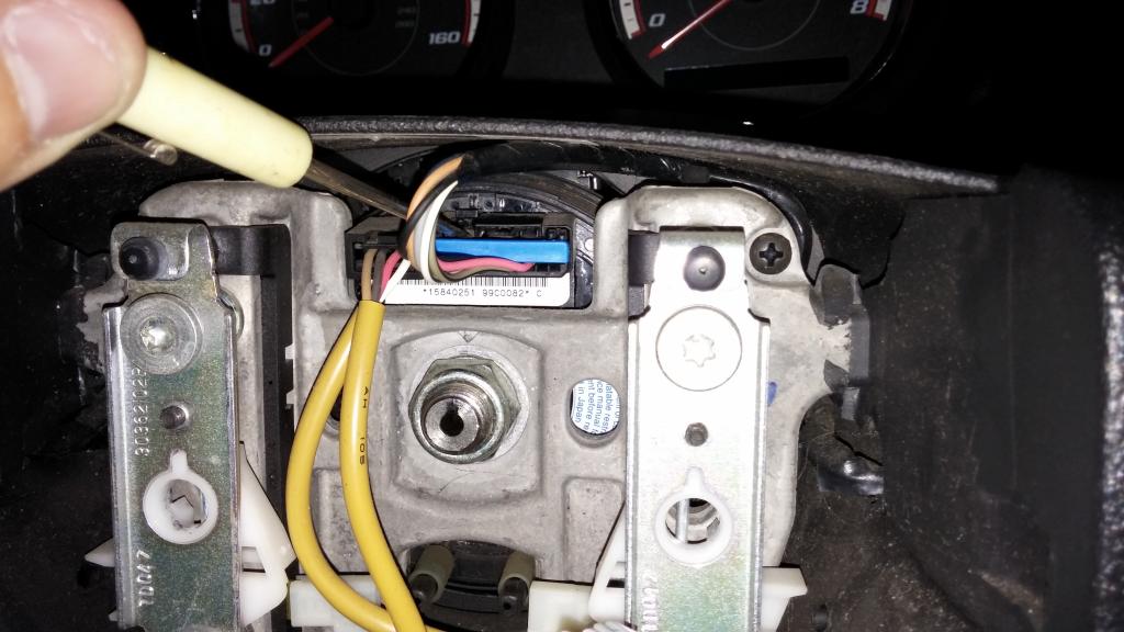

To unclip, you need your flatblade again. Push the two tabs in on the top side of the plug, under the ridges.
one tab is the one the screwdriver is going to in the picture; the other is just to the right of it.Name:  20140923_155244_zpsch6bxe7w.jpg
unclipped.

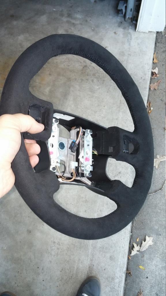

Simply tug back and forth on both sides of the wheel to release it from its seat. After its loose, take the bolt the rest of the way off, and bam, the wheel is out.
Here's what its getting replace with in this case... a wheel wrapped in alacantara from redlinegoods!
put the wheel in its spot, start the nut, push the wheel all the way into it's seat and tighten like the wind! be sure the clockspring is still in its upright position.
plug the harness back in, and get your airbag back.
push the connectors into the airbag and then push the clips back down.
push the airbag in and it will simply click into place.
reconnect your battery, make sure no one is sitting in the drivers seat just in case the airbag wants to go off...
and done!
