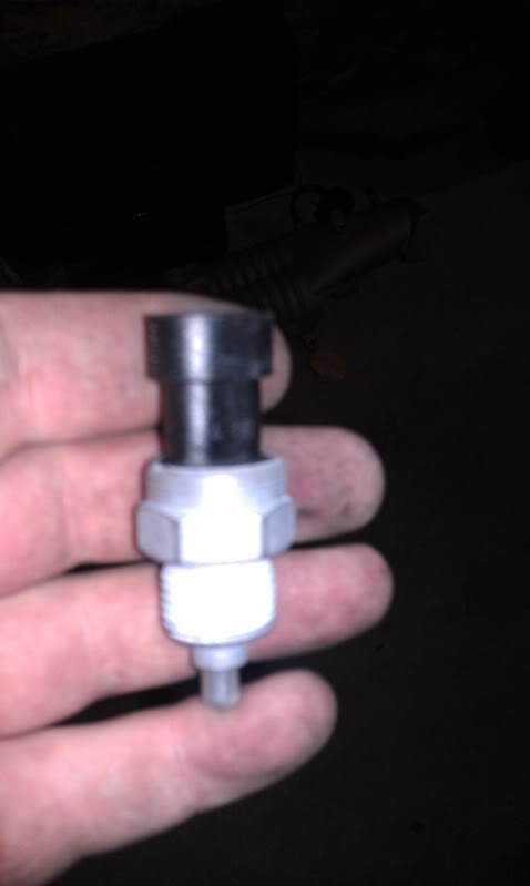

Here is a picture of the switch in the car, and the switch out of the car

not bad....good write up and thanks for the info on future reference,and also thanks for the price

you can literally see it, which is why i included a picture, its to the left of the fuse box. 4th gear, move wires, look down
