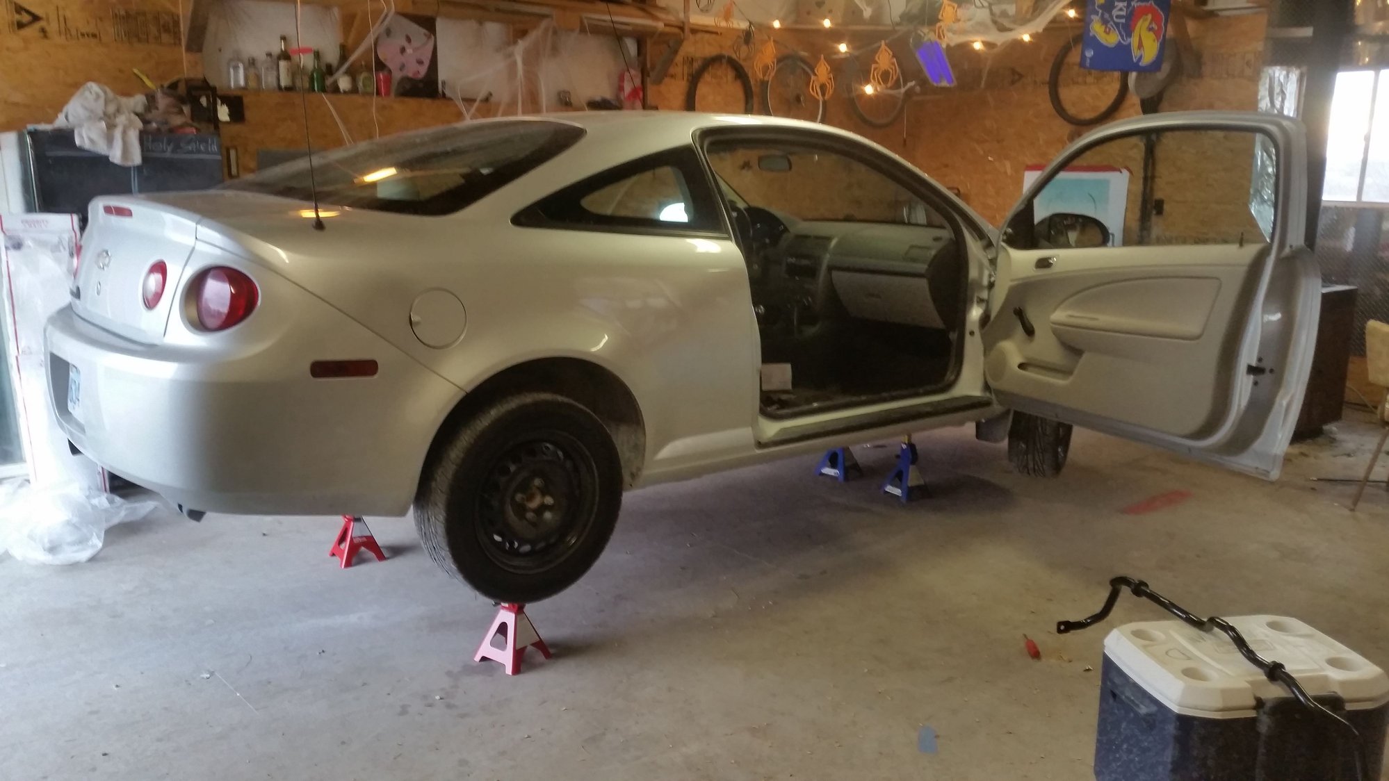

Up on stands with seats removed to install under car rails from Powell.

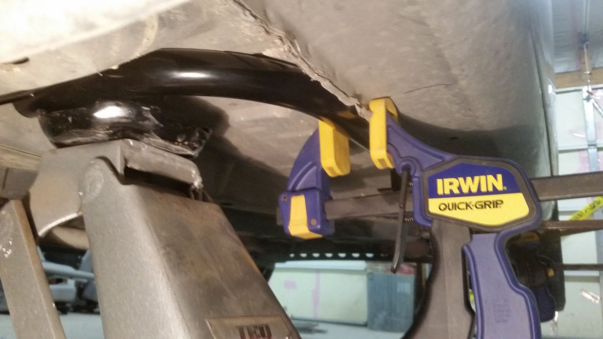

Installing UCR
Here the car is on jack stands utilizing the UCRs from Powell. The UCRs are great if you don't have a lift to get the car up in the air. Only have to us the jack once on each side and the rails rest nice and stable in the jack stand's cradles.

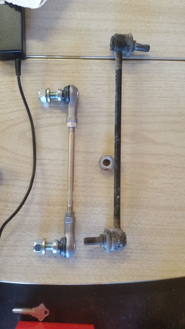

Here is a comparison between the Powergrid and stock end links.

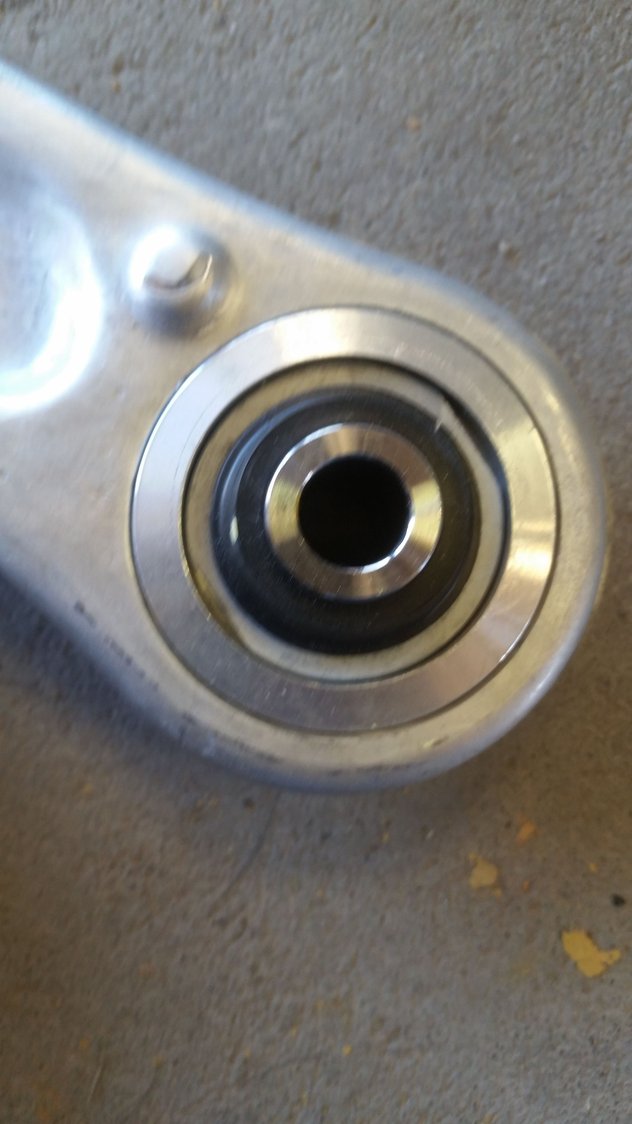

Spherical TCAB from Powell installed on the latest TC FE5 control arm. Noticed a significant reduction in torque steer as well as elimination power hop. I also have Powell rotated transmission mount installed so that helps as well.

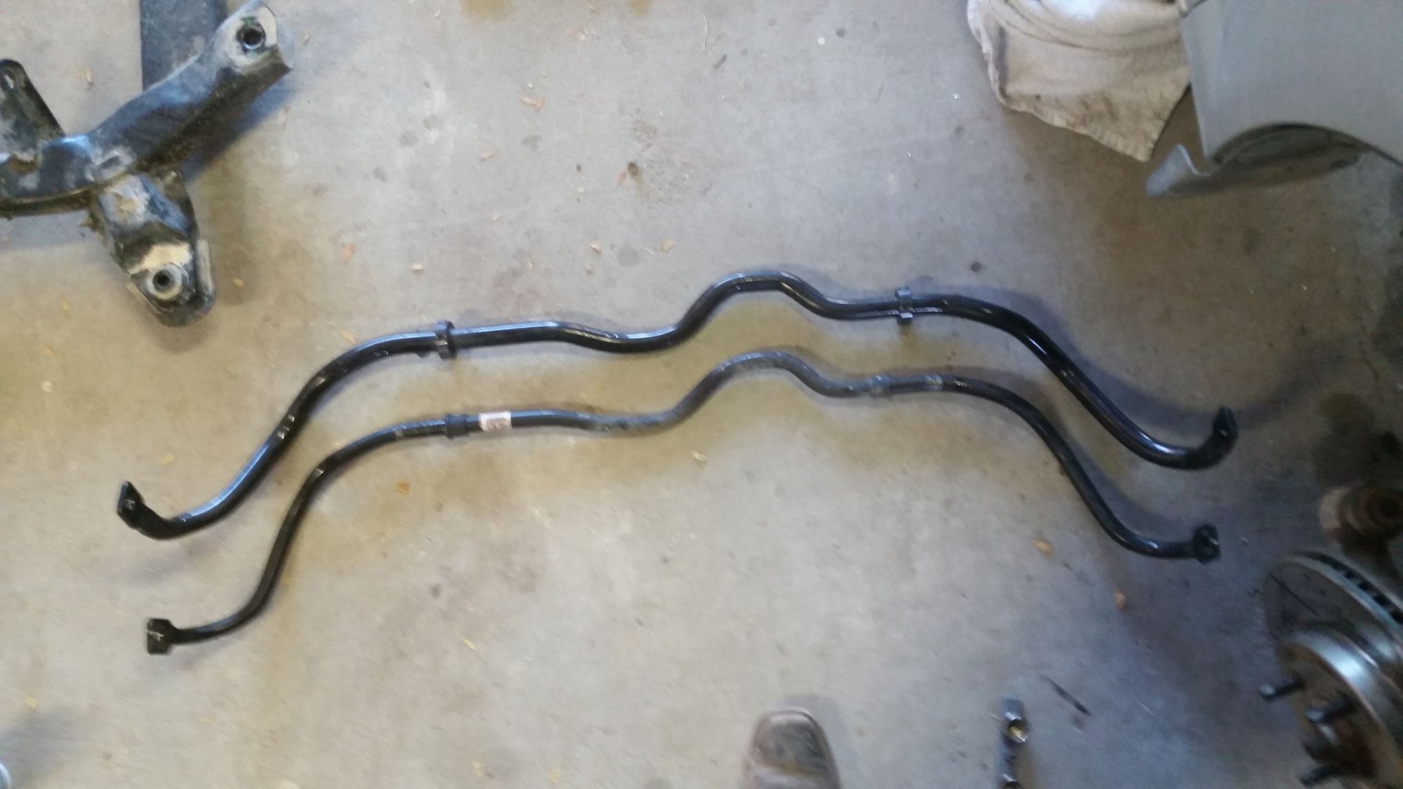

Sway bar comparison between SS/TC and my lowly LS stocker.

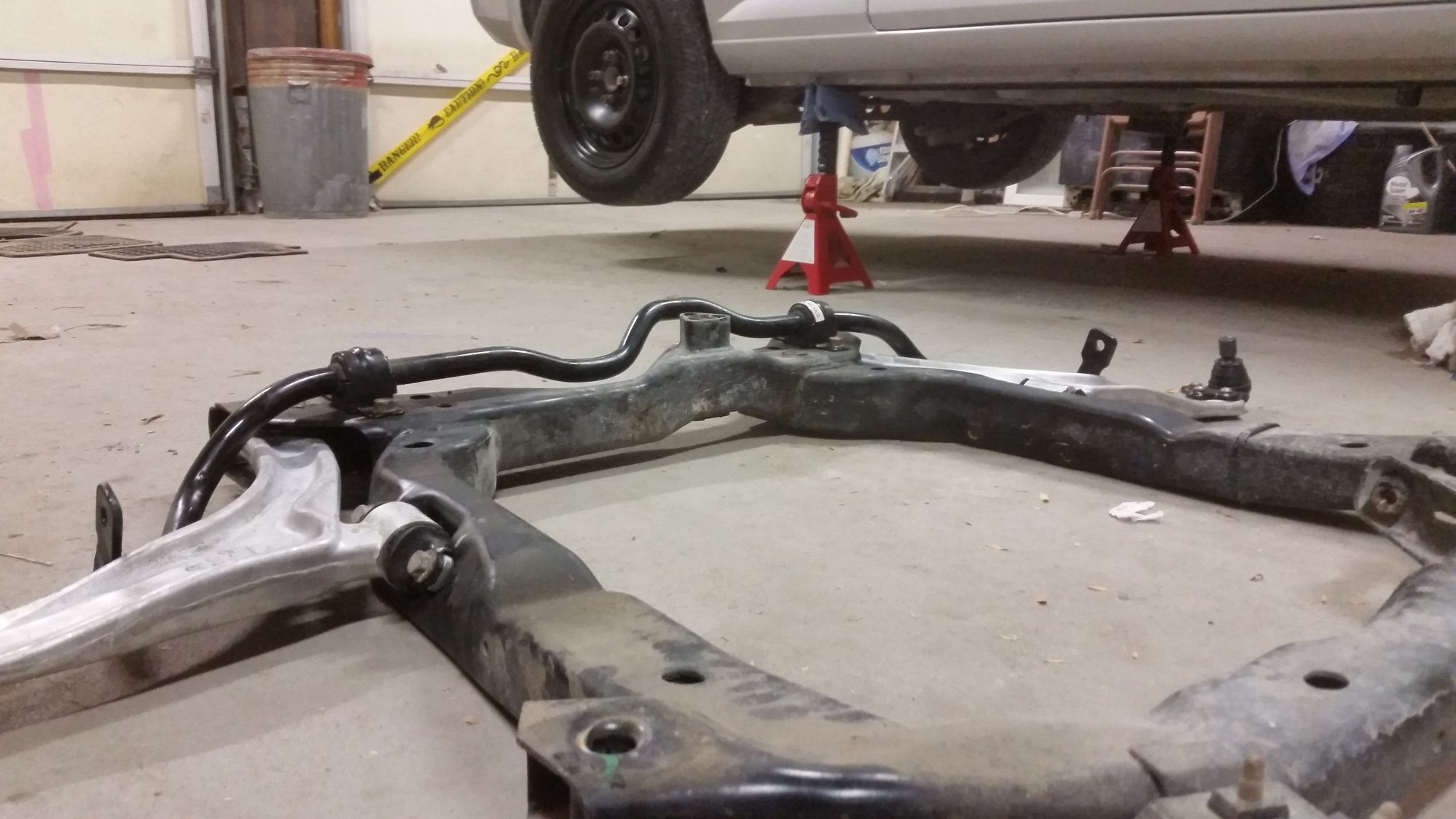

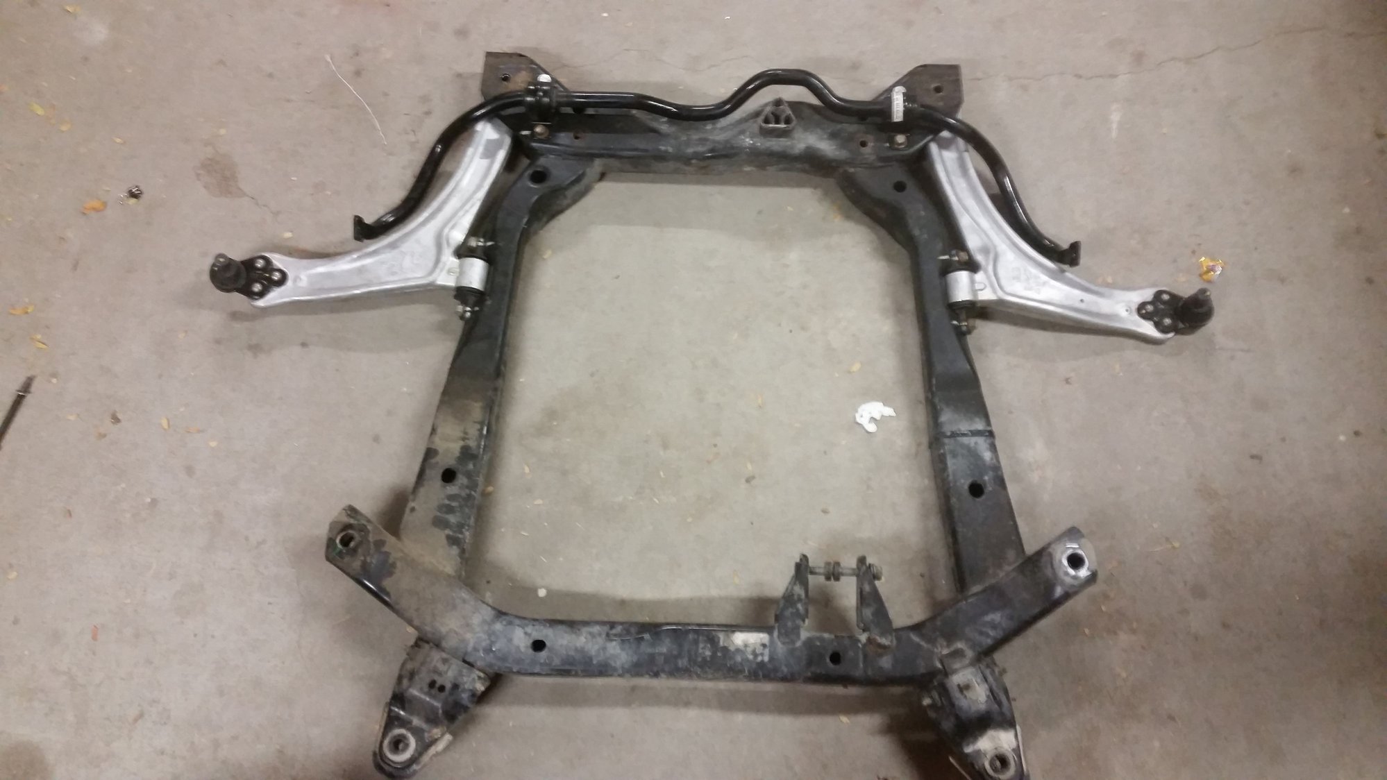

Front cradle assembly with newly installed goodies.
