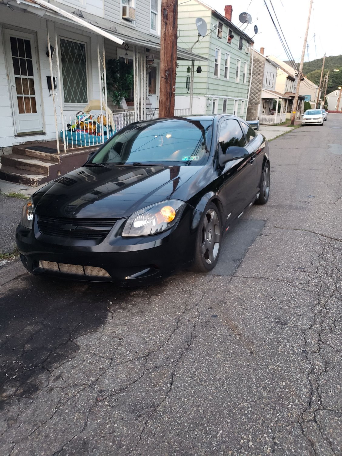

06 cobalt ss/sc. Just traded one of my trucks for it. Pretty sure it has a full stage 3. Having some issues and could use some advice and help. Cant wait to have this thing back to tip top shape
