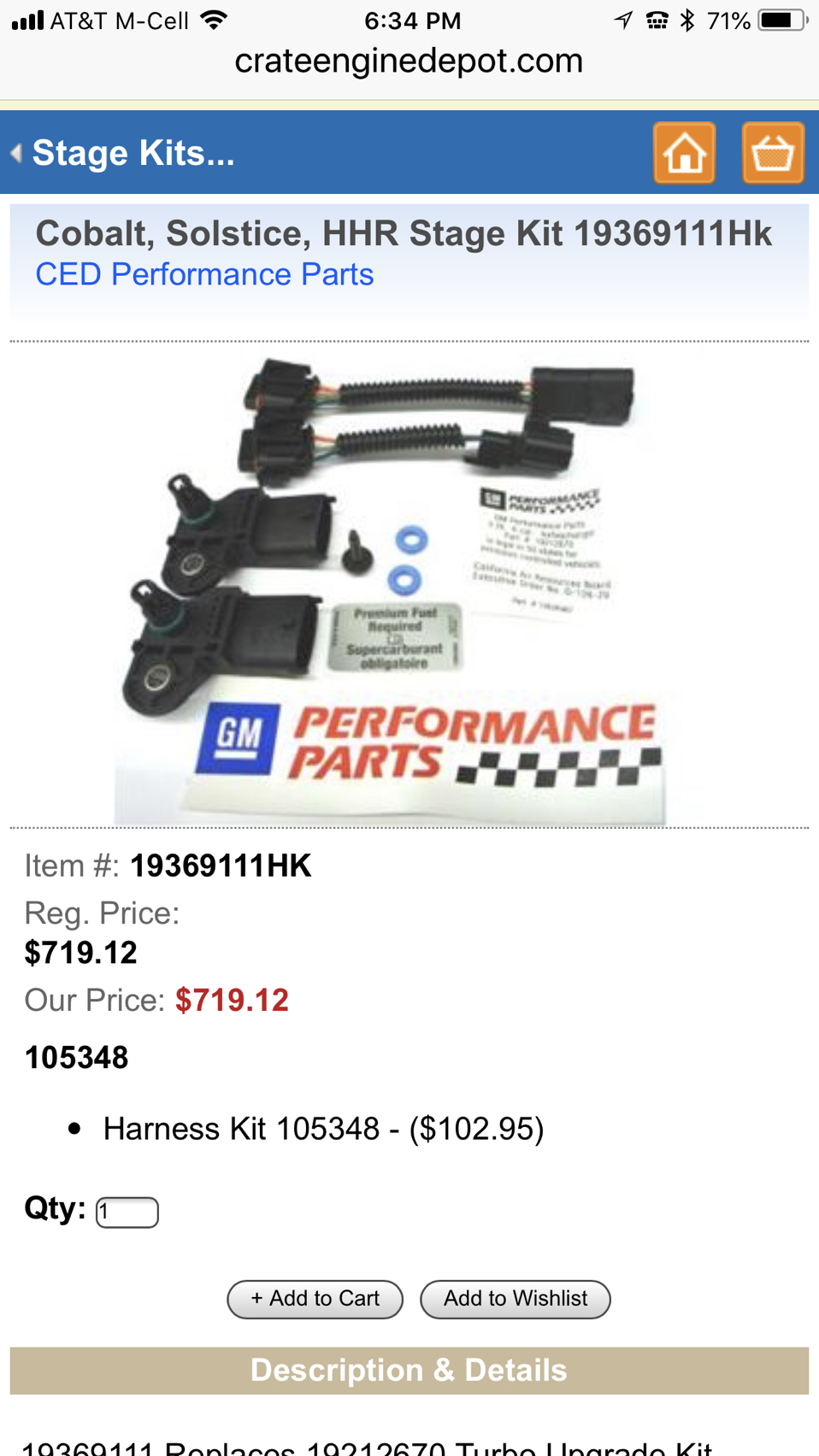

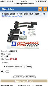

I got my kit through CED back in 12 but the advice others have said is valid- just getting tuned by someone who knows what they are doing.
