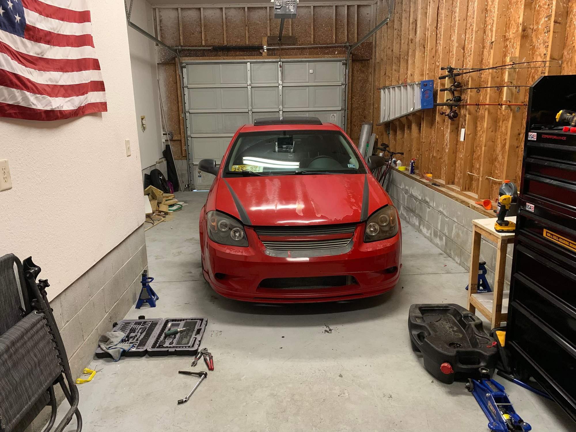

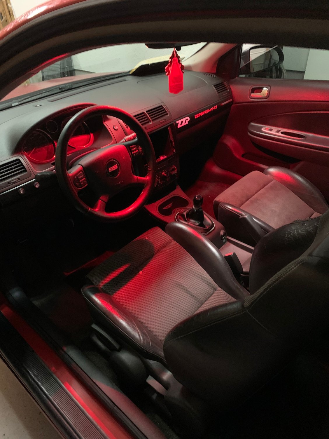

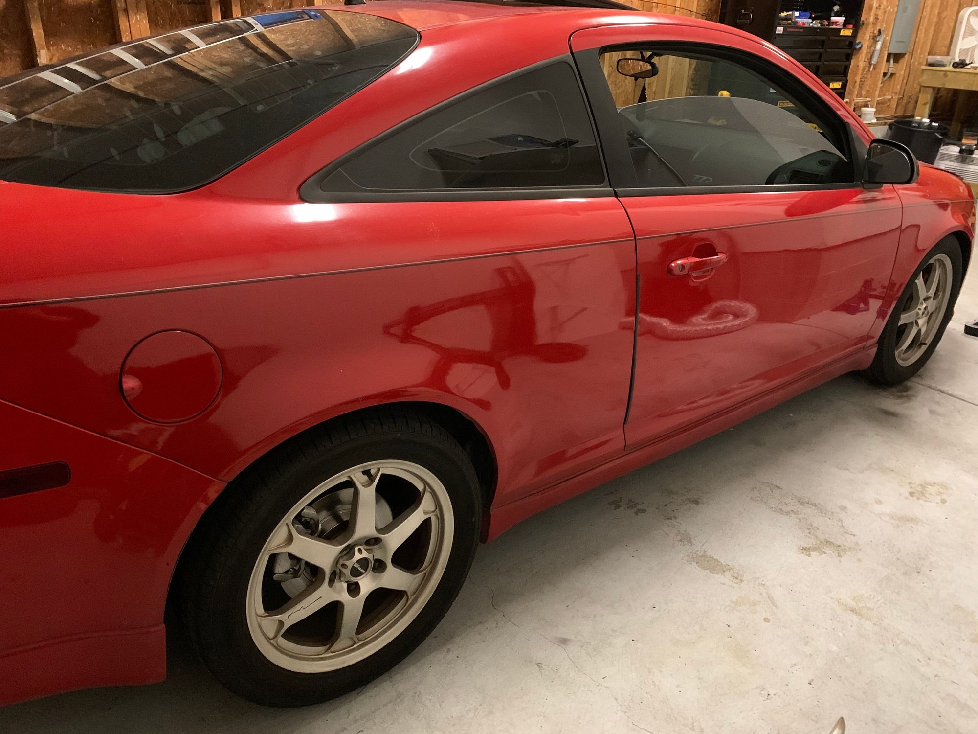

cosmetics wise it looks like ass, but performance wise is runs really well. Only thing is I noticed after installing stage 2 kit that my STFT was running pretty rich around -16+ at idle but steady’s out once you get going

Not bad at all man. Engine bay looks good with the painted supercharger and painted valve cover. I would suggest getting option b kit, dual pass endplate kit and s3 heat exchanger. It will help keep your intercooler temps down and get you a few extra hp because of it. With those additional mods you can easily go down to a 2.9 pulley without any issues. Also what is done for exhaust i know you said straight piped. I would do zzp 2.5 inch catback exhaust with their resonator pipe. For the header either go mid length or shorty header. All these options you can get from zzp and i would stay away from the cheap ebay crap because they will have fitment issues trust me I found out the hard way with the very first exhaust i bought for my G5. It was a cheap Megan exhaust knock off. Ended up burning a hole in my bumper and droned soo bad it gave me headaches while driving. Eventually I smartened up and went with a high quality exhaust with zzp and never looked back.

Mine looks great from a distance, but is starting to have clearcoat issues like yours. The hood is where it seems to start for everyone.
