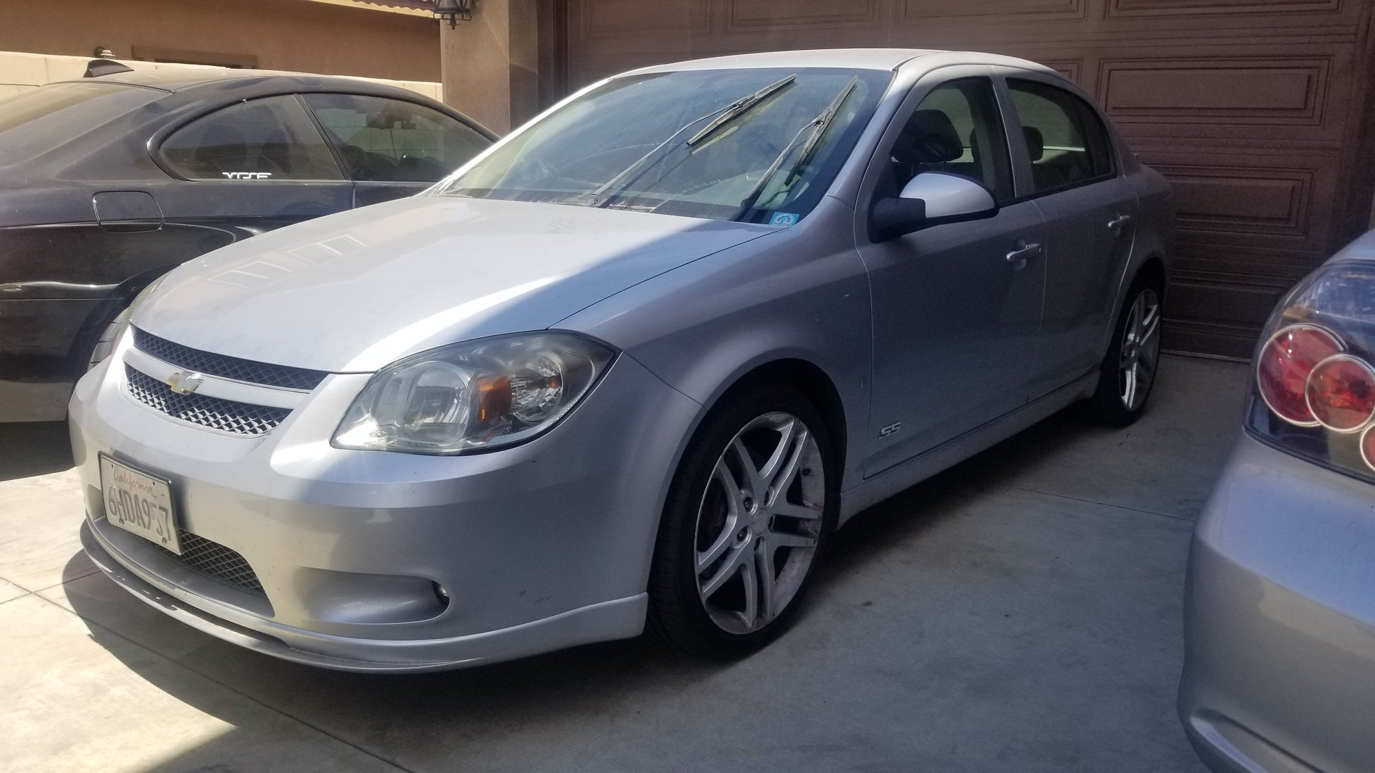

Hi Everyone, my names Al. New to forums but I have recently acquired a 2009 Cobalt SS Turbo Sedan, which apparently seems to be pretty rare?
Currently it is not running as the previous owner said it had some coolant mixed with oil (Which i verified), But I'll probably be pulling the engine apart soon so see what went wrong.
Hoping to get this thing running and build a pretty nice sleeper car.
Excuse the dirt, have not gotten a chance to wash her yet.
