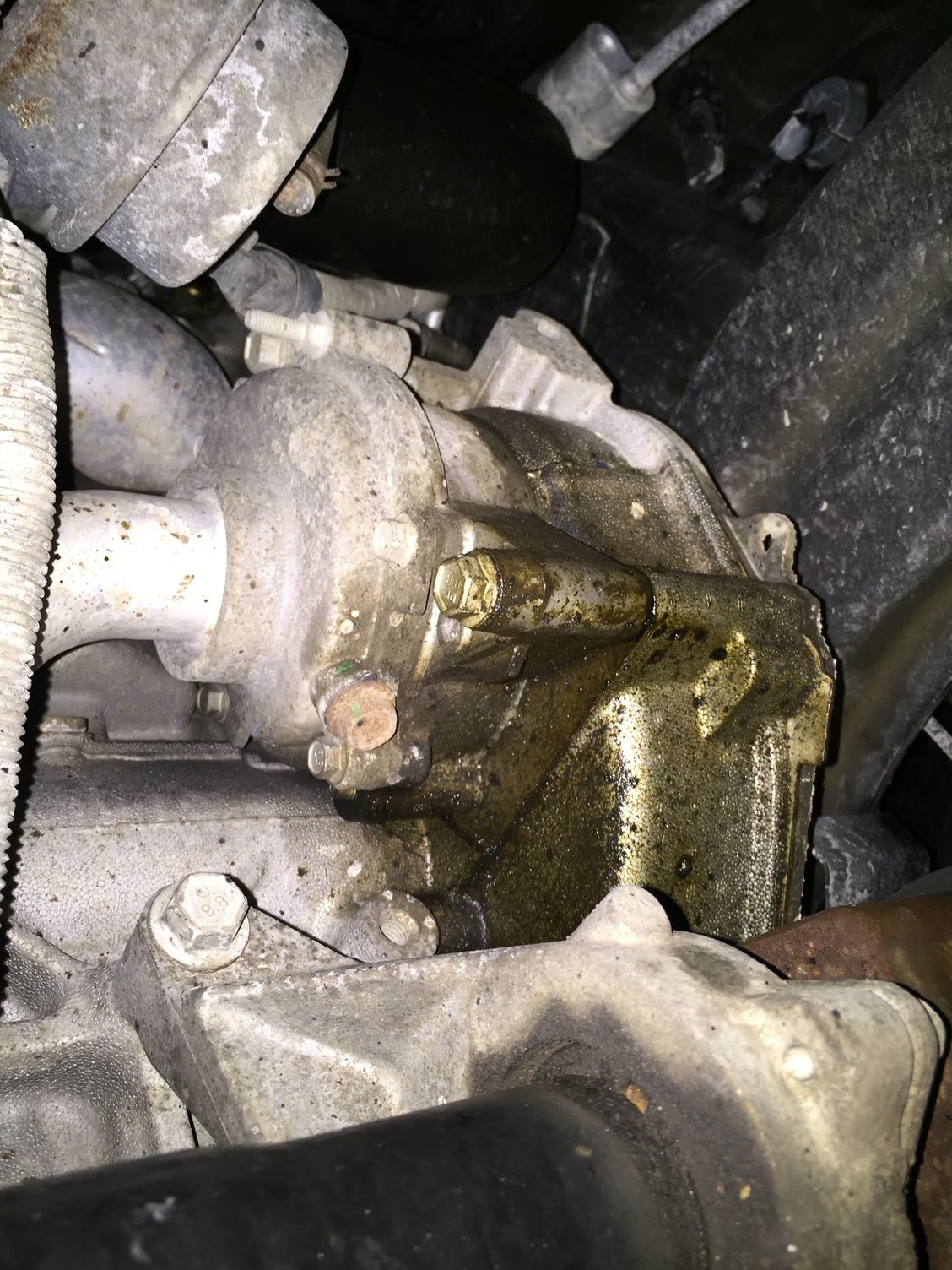

Ok so its the day after i made this post and ive been looking around for that leak and found this? Could it be my leak and what is it, if its not a coolant leak, what could be leaking out of that What is this and whats leaking from it

To address the pictures you added to the first post (side note, just post them in a new comment otherwise they may get overlooked). It looks like the gasket between the waterpump and timing area is shot and that looks like oil. Oil and coolant are significantly different, a quick touch would of been able to determine it on the spot.

You definitely have an oil leak. I can't tell from the pictures where the oil leak is coming from for sure. I would clean all the oil off then look for where it is coming from the next time you drive.
