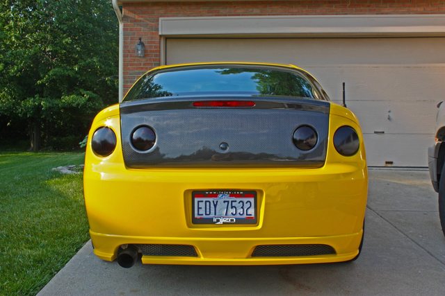

you want the hook? you are just going to have to make your own bracket. $40 shipped. PM me. it is a genuine BENEN hook
thanks. its the VIS, it fits terrible and was a **** ton of work to put it on. if you get a CF trunk, please get a shaved one with no third brake light or keyhole. it will make your life a lot easier
agreed

trunk lock didn't fit-break out the dremel
third brake light didn't fit-break out the dremel
not one hole was marked to be drilled-pretty much eyeballed it and got it good
trunk is super high on the driver side and flush on the passenger side, no aligning is going to fix it. i know its not going to fit perfect but damn
- Keyhole i dont care about and wanted to plug it but yes ill agree was to small.
- Mine fit perfect no issues
- Holes were clearly visable where they needed to be drilled as they dimpled from the mold. Not sure how yours was any different.
- Mine was super high till i aligned it. Simply turn the bolt on the hinge all the way in then lossen the 2 bolts that bolt to the car and slowly push the hinge down. retighten. Completely flush.

i wish i would have taken pics of the trunk before i did any drilling. not one mark on it for drilling. i was pissed. and i did exactly like you did to align it, the passenger side went flush but the driver side still sits high
you make it sound too simple lol
mine was a pita
