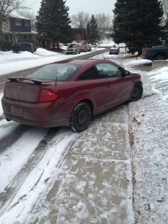

so ill start off with i just got back from a 1000km drive. i parked my car out in front of my house. i then went out and ran some errands and parked it again. no issues.
about half an hour later my mom yells that my car is on my lawn. so i ran outside and sure enough it was. i originally thought someone driving by hit it up onto my lawn and they took off, but there's no damage.
i then thought it just rolled forward, but then i remembered and saw that i left it in gear. then i saw a mark on the sidewalk where the tire had spun meaning the engine had been running.
as you can see in this pic, my car was way up onto my lawn

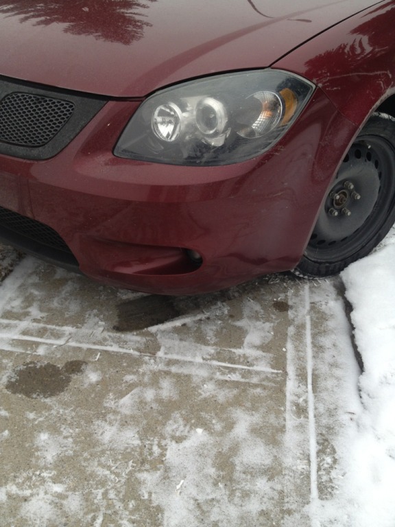

and in this pic you can see the tire mark
so we then boosted the car, and when i connected the jumper cables the car lurched forward. i hopped in and started it and it sounded like ****. sounded metal on metal and i turned the car off and there was a clicking until the car died again.
so my question is, is WTF happened haha. the car started while in gear, so something had to of tripped the starter into starting.
good thing i turn my wheels or my car wouldve ended up at the end of my street and probably crashed.
