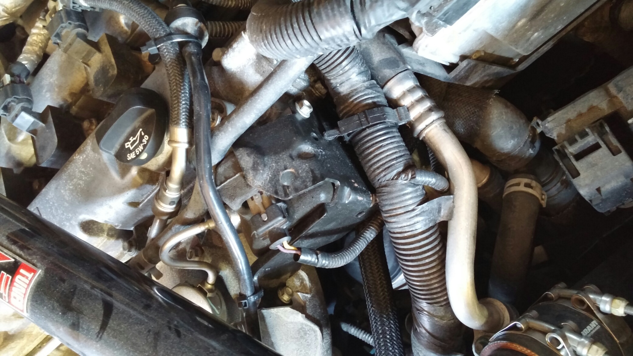

I've also attached a picture. I noticed this ticking sound the first night that I brought the car home and had the hood up in the driveway but I never thought too much of it. Since all of this has come to light, I've revisited it. I had the hood up the other day and was reminded of the ticking. It sounds exactly like a timer, each tick precisely spaced out. Every 1-2 seconds. My mechanic sourced it to the black piece that is pictured. He wasn't sure what it was, maybe something for the boost or fuel economy? It's hooked to the fuel line and exhaust.
Do you guys have any ideas of what next steps could/should be? Anyone have any information on what this piece is? What the new codes could mean? Other things to check, try, anything!?
Ticking is normal, that's your high pressure fuel pump.
I'd still be checking for a boost leak, there is a thread around here about how to build one and test the system. Normally Too Rick at Idle codes are the first indication an oxygen sensor is going out, but make sure there is no boost leak, and you could for good measure replace the plugs with stock AC Delco plugs. Then address the oxygen sensor.

I would check the intercooler better. Is it stock? Aftermarket? Some of the hahn intercoolers had problems with the welds breaking and causing leaks. I would pull the front bumper to get a better look at it. The main problem is that your drawing extra, unmetered air in the engine. Which will throw your fuel trims off and also make it run like cap cause the o2 is trying to adjust for a bad airflow reading
