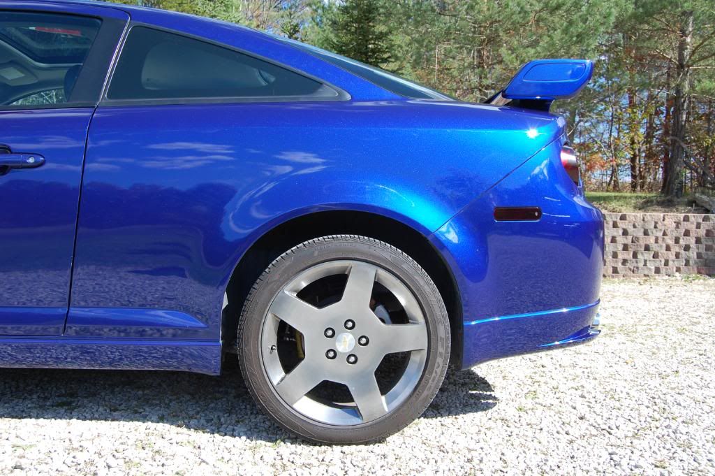

This is how the passenger rear wheel was positioned in the wheel well before the axle swap:

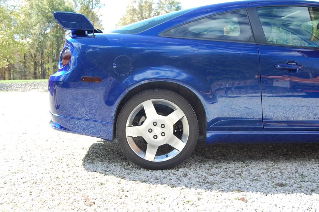

And the Driver side rear:
Everything seems to me in order now. Replaced the badly worn tire and I'm getting an alignment done. Hopefully after that I'll have no more weird tire wear issues. the wheel is in the same place in both wheel wells now though, and the alignment holes in the axle lined up with the ones in the frame of the car perfectly, so I'm pretty sure everything is good.
Driver side now:
Passenger side now:
