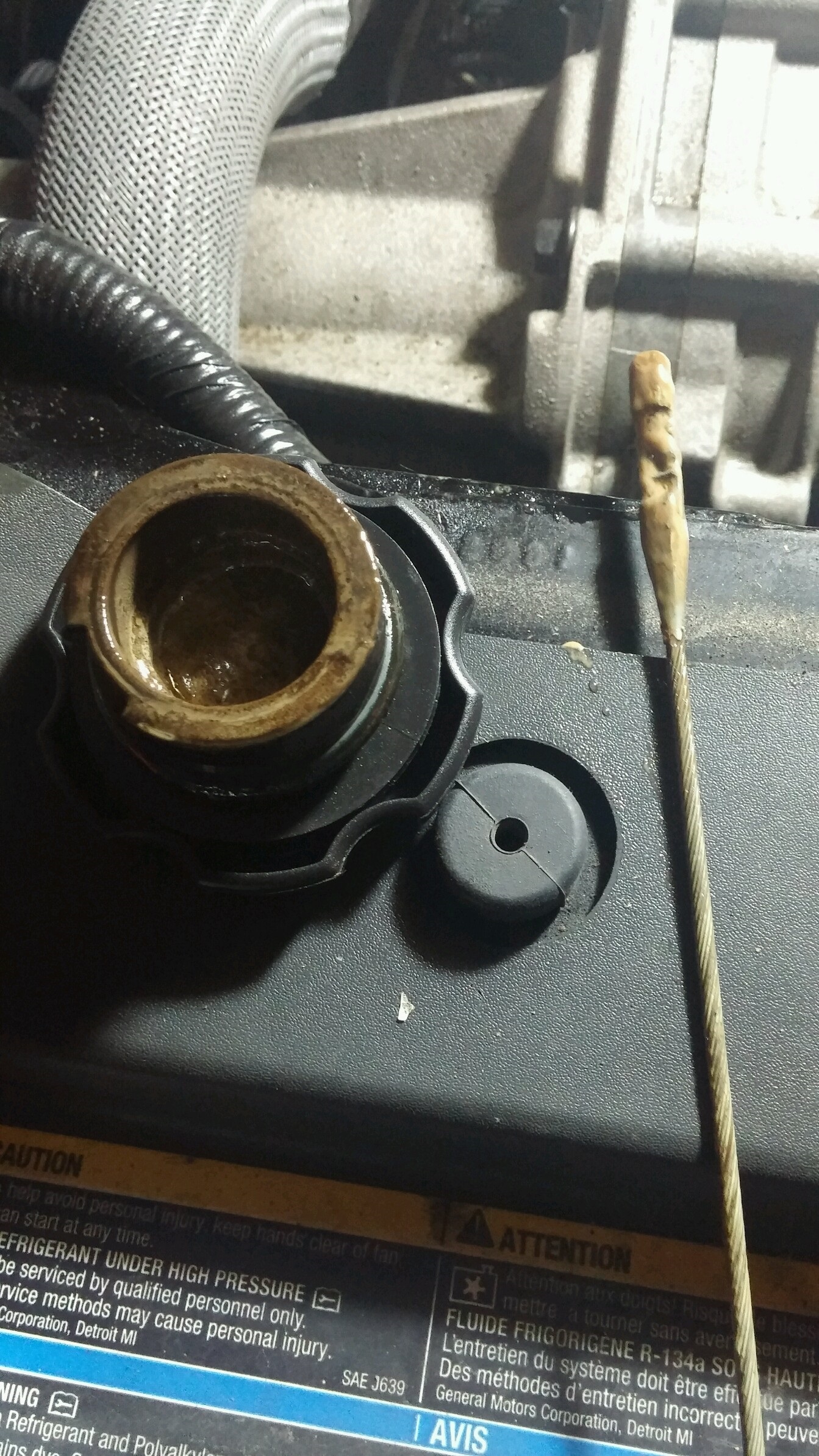

Holy S*#t, ran into a surprise, blown head gasket? only thing that's weird is it wasn't like this about 3 weeks ago when I changed my oil...Blown head gasket maybe? I still have full amount of coolant and my car doesn't over heat... or a cracked head, bad valve... What could it be guys? I'm not the most brilliant with cars.. haha

Oh... Looks like a minimum your going to be pulling the head off....me personally I'd go into worst case scenario mode

eh you get that when it's cold outside with a lot of condensation. always see that on my oil cap.
Yeah, I'm screwed...
Old Dec 28, 2015 | 04:16 PM
Looks pretty milky on the dipstick. Drain your oil into a clear container, let it seperate and see how much water youve actually got in there.
