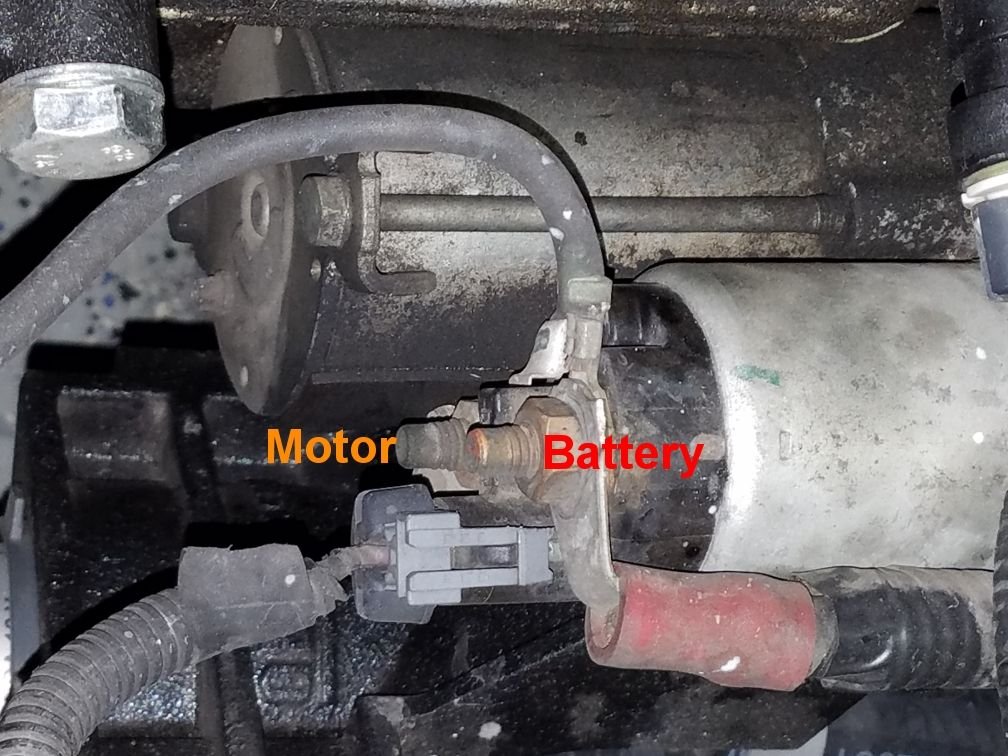

Bypass all of the control side of the circuit by taking a good jumper wire capable of flowing at least 25 amps to the 2 terminals shown below. This will bypass the Ign, safety switch and PCM. If the starter cranks over, let me know and i will talk you through the control side.
If the solenoid on the starter clicks and the starter does not rotate, the starter motor is not receiving enough current. Check the voltage drop from the battery + post to the battery terminal on the starter. Check the voltage drop from the - post of the battery to the starter housing. Anything over 1 volt for that distance and you have bad connections.

If they were jumping the Battery terminal to the Motor terminal as seen below, and it still wouldn't crank over then there is a Battery or cable issue. If they were testing the battery with anything less than a Conductance type of tester I wouldn't trust their results of the battery being ok either.

No... Turning the key to the crank position tells the PCM you want to start, otherwise it may only crank and not crank and start when you jumper it.
If the starter doesn't at least click when you do that, look at the above pic again and unplug that connector at the started. That is the solenoid terminal. Jumper from the top terminal (Battery) to the terminal on the starter where the plug came from.
Again: Make sure you keep it in Neutral with the park brake on as you are bypassing the clutch switch.
If you still don't get it to click and crank over, clean all battery connections, the ground point of the ground cable and make sure the battery connection at the starter is good. This is assuming the battery is sitting at 12.6V or better.

Alright so my ic pump is directly in the way of the stater. Can't seem to locate that plug. Connections do have a noticeable amount of build up though. Tried to clean it up a bit and no dice. Prolly gonna have to remove the starter
