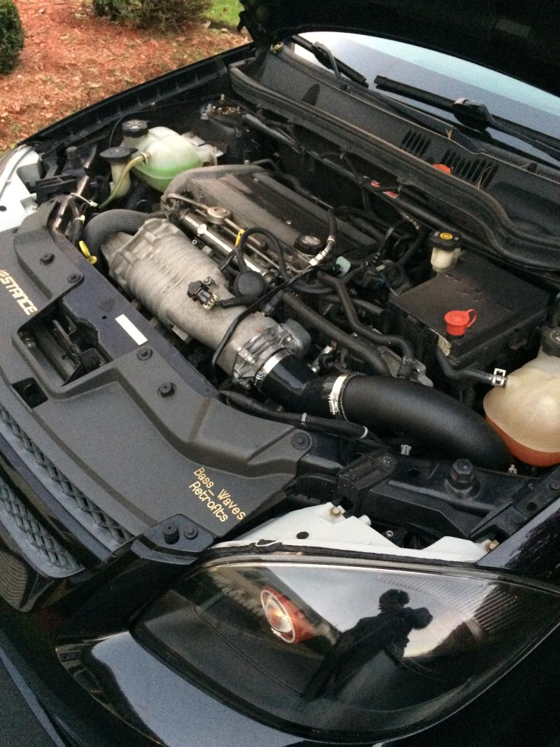

that intake is definitely throwing the code. and its highly resctrive... **** man get a new intake. ZZP 3" is nice.
This is how it should look:

Old Jul 7, 2016 | 10:39 PM
Not only is it restrictive, it's a huge vacuum leak post maf, it looks like it's slipped into the metal pipe.
OP find a stock intake and buy it. Remove the current setup and install the stock intake before doing anything else. Even driving it.

Yeah if your intake is allowing air in after the maf, which based on that horrible setup i'm sure it is, that's probably the cause of your P0171 code. Fix that abortion of an intake first and see how it goes.

That looks like someone used a mk4 VW 1.8t lower charge pipe as your intake
Yes! I knew that looked familiar. VW charge piping would be a good match for that pipe lol.

Well if you have to keep driving it, at least rig it and tape the connection to try to minimize the massive air leak. It might help a bit until you can source a stock intake
Old Jul 8, 2016 | 07:17 AM
Stock intakes are hard to find, but if you can find one stock is the best.
