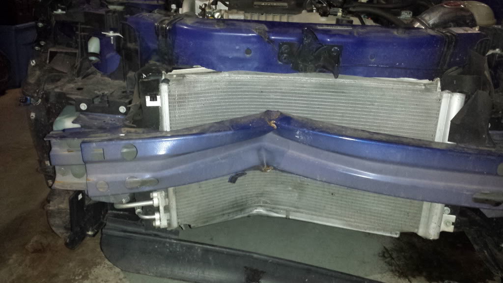

I then removed the front impact beam to get a closer look at what needs to be done.
http://i251.photobucket.com/albums/g...psf48b544b.jpg
From what I can tell, all 3 of the condenser, intercooler, and radiator are going to need to be replaced.

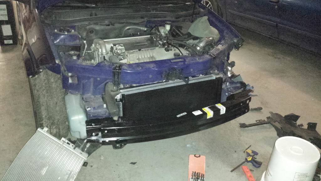

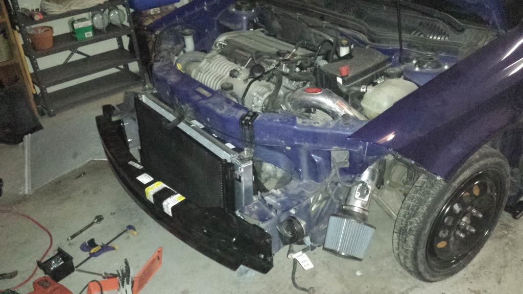

Update with work I did this weekend:
I got the old crash bar brackets off, re-aligned the new ones using a bunch of measuring, a few clamps, and some magnetic lasers. New fans, Mishimoto radiator, and a new A/C condenser (it came black like that, the pick was aluminum). The old condenser is still attached because I am pretty sure that the A/C is still pressurized.

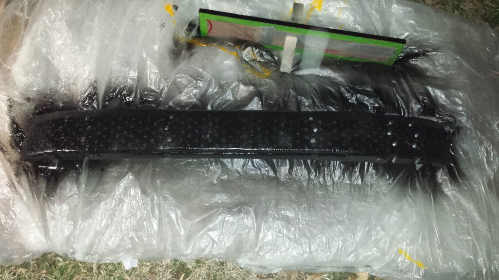

The styrofoam absorber for the front also came in white, so I spray painted that black. I doubt it will show, but I already had the paint for another project.

I'm going to have to wait for more parts now. I have a hood coming in later this week.
