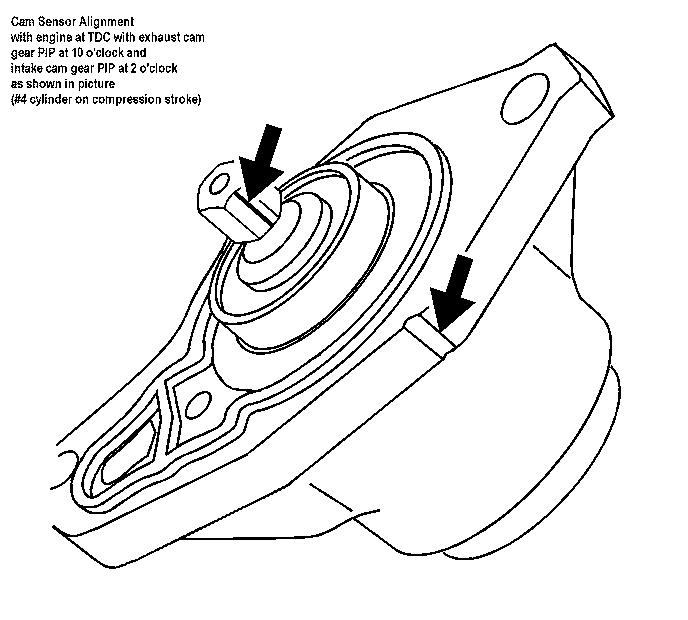

p0069 is for the barometric pressure sensor, its right above the oil filter cap between the valve cover and supercharger.
p0017 is crank/cam correlation, the cam sensor may not be installed correctly or the ecm may need a relearn.

you may have the baro and the super charger inlet pressure sensor sensor plugs switched try swapping them and retime the cam sensor
