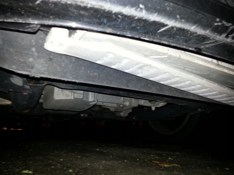

Just noticed this when I parked my car at home after work. How bad is this? Do I need a new intercooler or just a bracket? Can I temporarily hold it up with a metal zip tie until my new intercooler comes in if I need one? What's the best place to get one?
Any suggestions welcome.

That's not a bracket thats a condesation collector. You either need to rip it off the rest of the way and patch the holes in the bottom with Jb weld, or get a new intercooler

I was talking about the plastic piece holding the condensation collector to the intercooler. It still seems to be attached well to the intercooler, just bent.

Also, I haven't driven it since I noticed it. Would my boost drop way low if it's actually broken? How can I tell (besides a boost leak check) whether it's actually broke or purely cosmetically damaged?

if it's leaking the boost leak should be big enough to throw a p0101 code. If it's running fine and not leaking, I would just jb weld it back in place

The plastic that holds it to the IC seems to be the only thing broke...I would just do what tommy said.

Ok. Since no codes popped up while driving today (and I'm positive it didn't happen today because I didn't go over anything), I did just that, I put it back in place as a temporary solution.
Couldn't find my JB Weld, but did find my stainless steel zip ties. Looped three of them together, bent the piece back in position, and left it at that.
Doubt they will replace it under GMPP, are there any recalls or TBs out for this? I believe previous owner's wife did the same thing, and it looks like there are many people on here who have damaged theirs too. Sounds like a design flaw to me.
