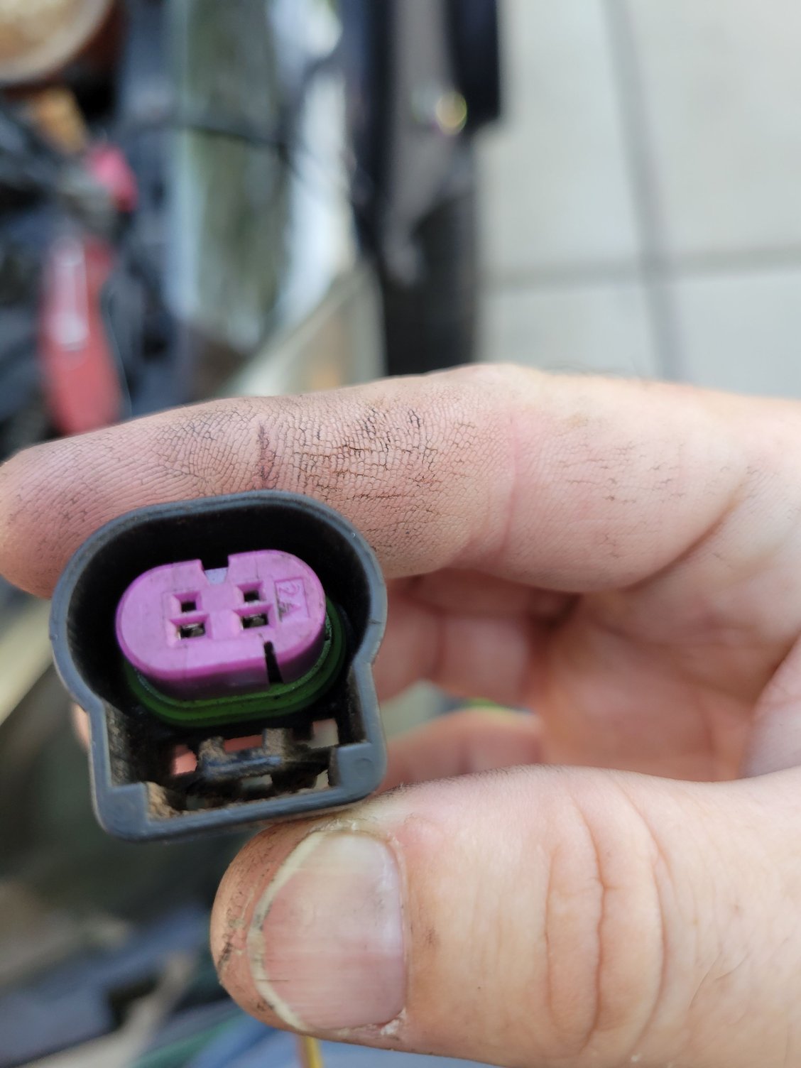

This may be the problem right here if you look inside the jumper the prongs are both bent to one side and down i hope this is the problem i mean i hqve checked power and one side showed a reading the other wire didnt show any ground or any reafing with the meter i beleve it was the low voltage reference wire

Ok so new throttle body hooked up and i also rewired the ckp sensor minus that plug that may have been causing problems so now my starts and runs its ok but it is stuck in reduced engine power mode and i dont know how to fix that plz if you know some secret ninja karate lol i can to do get this outta rudeced engine power mode i cant see what is causong this
