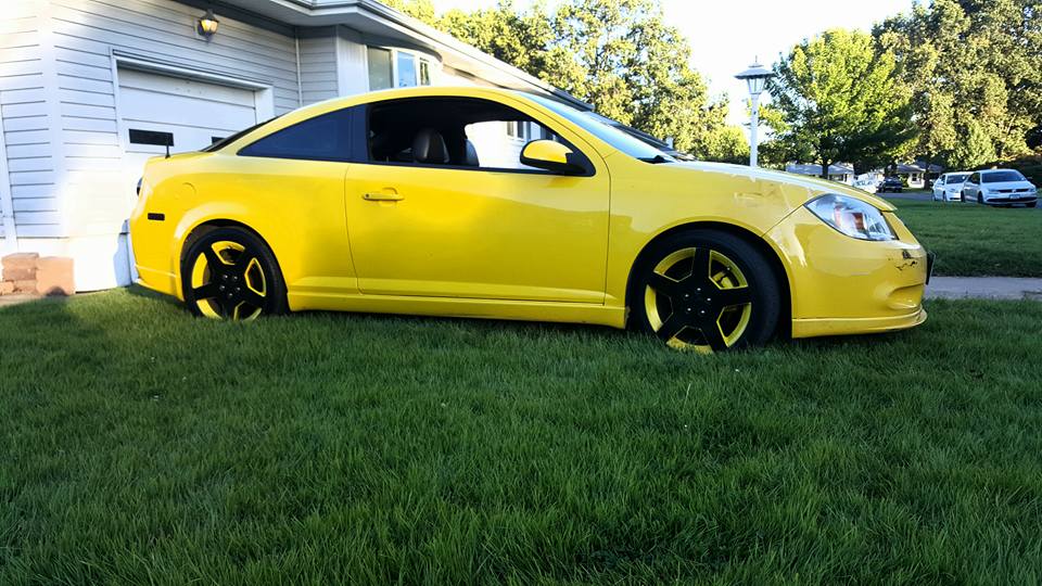

side note, ignore my profile. haven't really used this since I owned my last cobalt 7 years ago. a 05 ls. I am now running a 06 lsj. lots of cars between the two.. respond through here or if you have some useful info feel free to text me at 314 623 1773. I don't use this forum to much anymore but im at that point of installing my stock cams back in.. new balt is attached in photo attached
