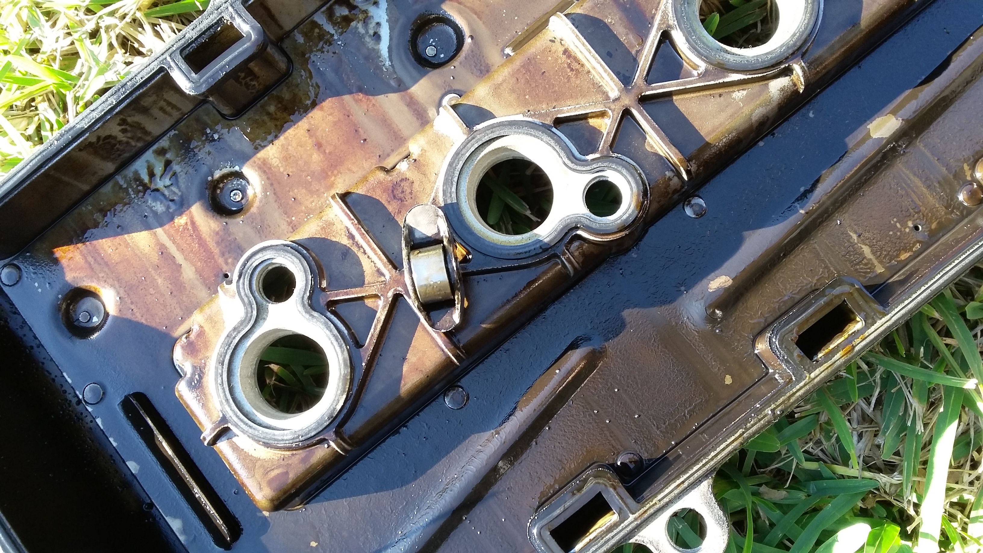

Hi everyone first time posting, few days ago I heard a knocking sound after driving for 5 mins bedding my new brakes. I shut it down and got my phone to record and second time firing engine sounded fine(probably rocker arm already fallen out). Thinking it was the timing chain tensioner problem I open up the valve cover and see that the rocker arm got ejected. I'm trying to figure out the easiest way to put the rocker back in and ensure it stays in. Looks like it was just the rocker, lash adjuster looks intact. Any help appreciated

my old car popped 6 out at once. I just loosened the cam and put them back under and it drove fine after

i didn't even remove the cam caps I just loosened them and slipped the rocker arm back under.

Ok so it was also a broken lash adjuster. Put the rocker back in place, went to manually turn the engine, knocked the rocker off and also broke the top off the lash adjuster. Hopefully I got all the metal pieces out before I replace it...and the chain tensioner. Hopefully any metal pieces come out with an oil change, if not...

The rockers are held "up" by the adjuster against the cam and valve. If they are popping out, you have a faulty adjuster that isn't staying pumped up. Usually see them ejected from an over-rev event, which can cause other damage but it's better than the valve staying open and smacking a piston.

My bad you're right, they were all loose because I had the bearing caps off and the cam lifted. I need a beer...

you need to clean out that engine and more then likely replace all the lash adjusters

with the condition on the inside of the engine a little preventative fixing can go along way and the zip ties don't help keep the engine in time

I ended up using a whole roll of shop towels on it, replaced tensioner and lifter/rocker. No problems since, taking it easy though. I'll upgrade springs and lifters when I'm ready for more power.
