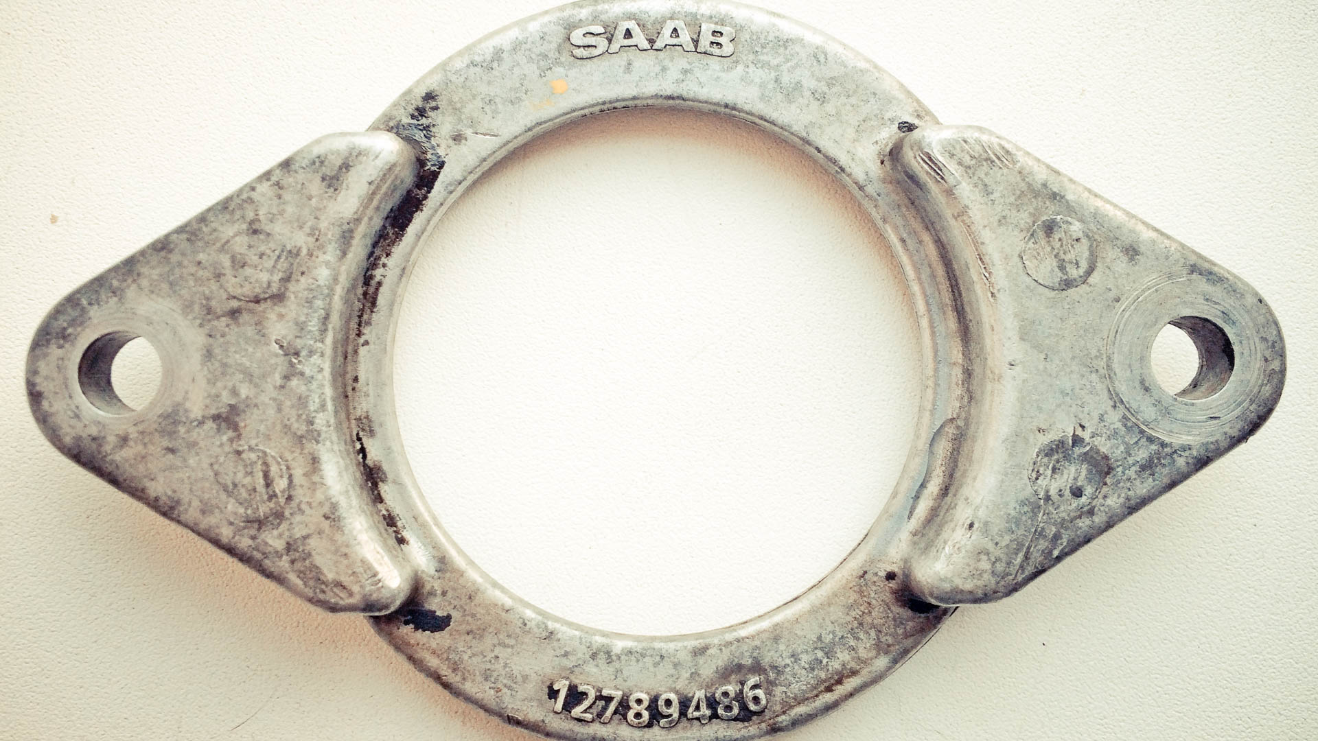

img_0611.jpg - 12789486 - Intermediate shaft bearing cover (#1 on scheme)

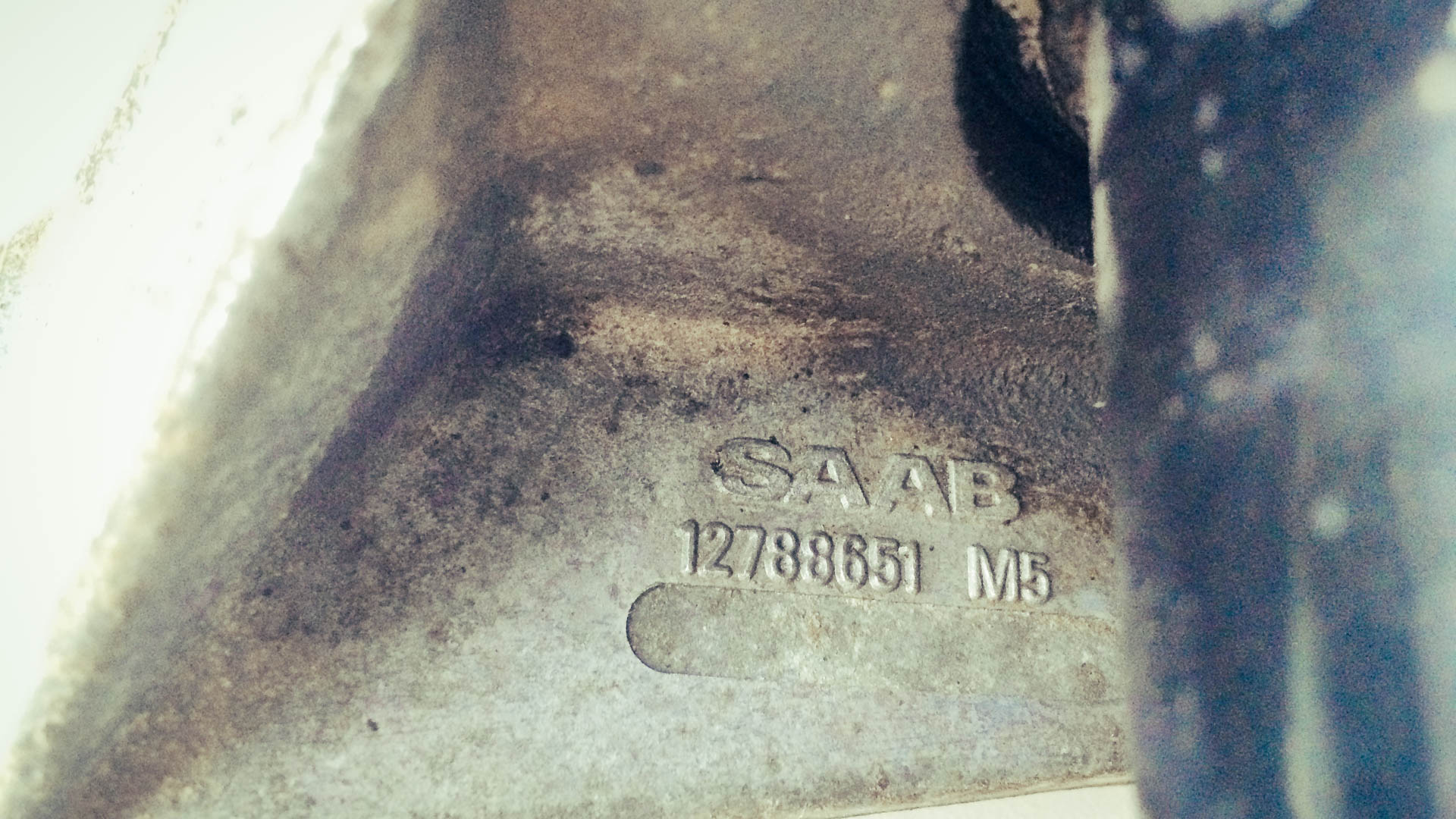

img_0615.jpg - 12788651 - Intermediate shaft bearing housing / mount (#7)

0410081a06-025.jpg - #6 ?????? - Intermediate shaft - 27 teeth 445mm (#6)
Maybe anyone knows what P/N of #6 on scheme.
There are some numbers from SAAB with B207R engine & M35 gearbox - 13408708 & 9186588 but there 27 teeth 465mm - it 20mm more than need.
