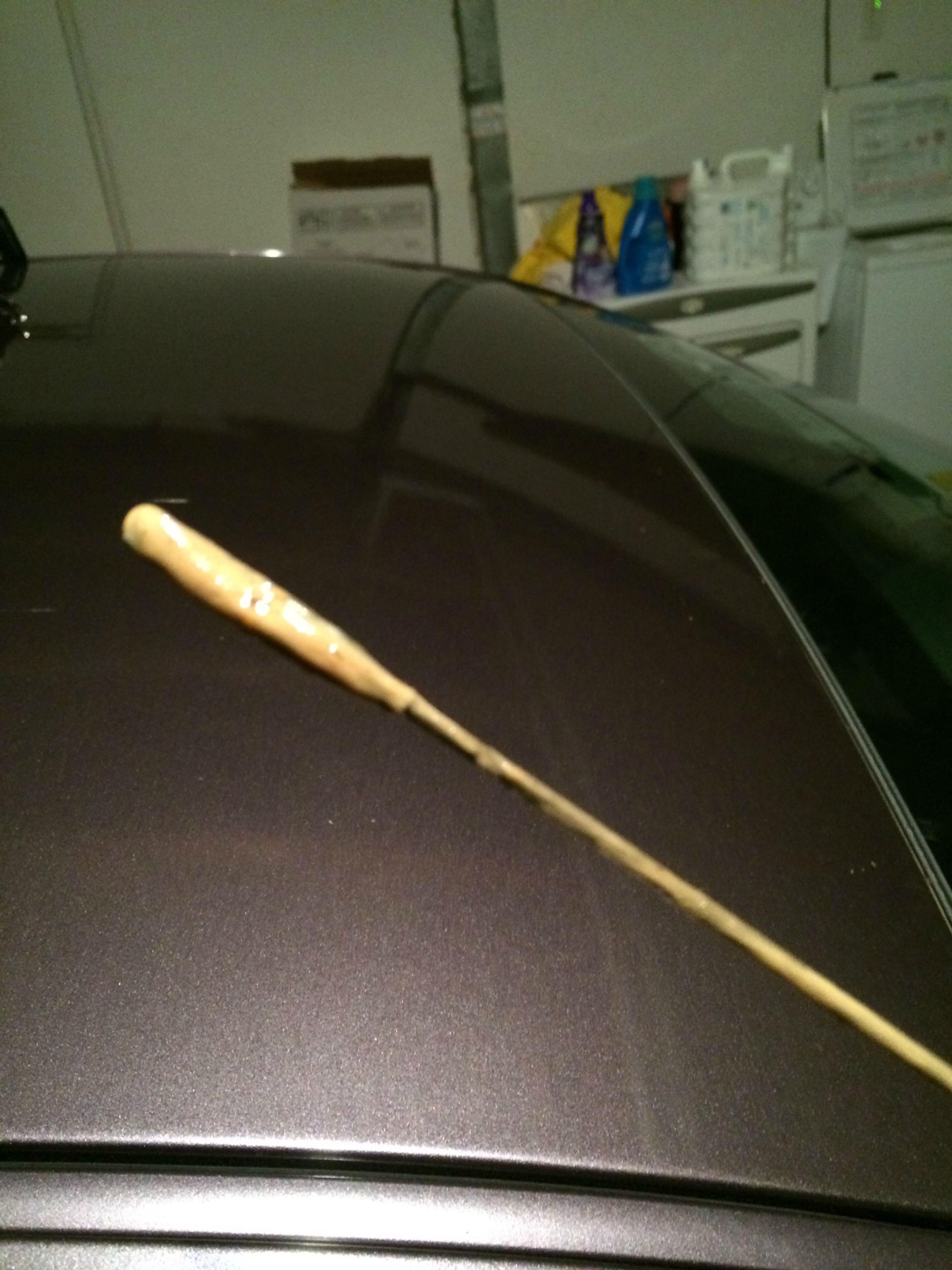

Question Thick Sludge on Dipstick
I'm new here so bear with me if I'm doing something wrong...
I have a 2006 Cobalt 2.2 with 150K + miles...
The check engine light has been on for about a year (please no lectures, I've had the computer reprogrammed 3x since I bought the car brand new so usually the lights/gadgets mean nothing). I know, I know.
Yesterday I was driving home from work and the oil light came on (red dash light, NOT the change oil notification), then immediately went back off. I drove the 2 miles to my house and checked the oil... sludge all over the dipstick and in the tube... wiped the dipstick and checked again, same amount of sludge was there.
From the little bit of research I've done... this looks REALLY BAD.
Cracked head, blown head gasket, or something else???
If anyone can help, please also include a price and/or the parts I would need so I could look it up myself. Need to know if I should just bite the bullet and buy a new car, or if this is something worth fixing.

Headgasket is gone dude
Pull the vavle cover, $20 says it looks the same on te inside
Take the vavle cover off, look for cracks or anything els around the head. After that remove the head itsself
To take a deeper look. Its not that hard i just did it on a 2.2 for my first headgasket repair ever. The machine shop was the longest part.
Look at everything, look for cracks , wear marks, all that ****
Needless to say, do not drive it again. Damage might mot be that bad, provided you didnt neglect this car and did oil changes and this is the first youve seen this sludge

Headgasket kit, with gaskets all the way around, bolts is around $200 and a machine shop is anotjer $200 to get the head shaved. After that, oil and coolant. Get a torque wrench and a heate garage, rest is peanuts. Oh ask your local dealer for a print of on how to do the headgasket, they give you torque specs, bolt order, everything. Timig is np

engine might even be done, idk how you didn't notice this from other engine signs first.

if it looks that bad and its been driven that way, even a couple miles, I bet the bearings are going to be bad. Crank and rods burned. Would suck to do the headgasket only to then spin a bearing....

Had this happen to two vehicles in my life.
First one was driven like this for awhile and died, second one caught sooner and saved. Only issue is no way to know how long you've been driving it like this.
Oh and check your coolant as the oil can get into the cooling system and sludge it up as well.

Headgasket. You will need to clean the motor out also. I suggest diesel and letting it sit for a few hours then draining it after you fix the head gasket.

That's shocking that you couldn't tell that a head gasket was blown while driving. How wasn't the engine over heating? Were you loosing coolant?

Temp was 201 when I got home. Oil light flashed at about 2 miles away from where I stopped driving... haven't checked the coolant yet, but it definitely didn't overheat.

chance are the bearings on that motor are shot, there's no real way to tell how long you were running around with water in the motor oil. Your oil light would have turned on because of low oil pressure from it being too watery.

Make sure they flush out the motor. I just did this to my 00 honda accord. After the fix, the car ran great but, you have to think about the muddy slug already in the motor. If you want to make sure it lasts, I would suggest doing what I said.

With the mileage you have on that car I'd honestly be looking for a low mileage 2.2 to swap in instead of trying to fix that one...
You may be able to find a used 2.2l with lower mileage for a decent price and it'll be more peace of mind then tearing apart your current motor and finding more and more issues. Or better yet get a rebuilt one.
