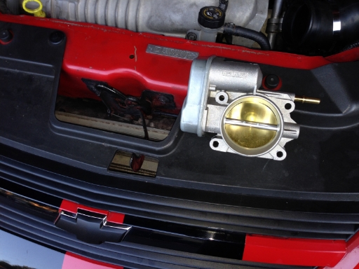

Today, I went a little WOT and hit some gravel which cause me to RED LINE, RED LINE, RED LINE - a lot. Afterwards, the car shut down into Reduced Engine Mode and won't start. These are the codes that are being thrown as a result:
I went ahead and swapped the TB out under warranty since I just replaced it three months ago. So, the TPS is not the problem.

I'm thinking that the ECM (which I also replaced with a used about 4 months ago) has gone to sh^t already. My only basis for this assumption is the sheer number of random codes being thrown related to electrical. I checked all fuses, the only other thing I could imagine it would be is a relay.
