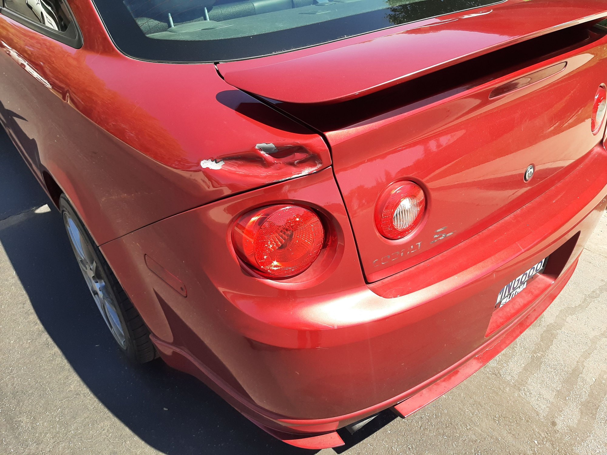

Hey yall. I just bought my second cobalt and the thing needs a bit of love.
Starting with this dent. Any suggestions on how to approach repairing?

Slight of replacing the quarter panel, a slide hammer and body filler.

Or if you get lazy, just make sure the body lines are correct and just fill it, forget the puller.
True, but with a puller you can get it closer and use less filler. Thats going to take some filler to get it right.
For perfection of course. It's in an area that isn't so conspicuous and you can hide most of it as long as the hard lines match. You can use wire mesh to strengthen it to do a layer approach.

He did get into two body lines. The one on the side and the bumper will have to come off to finesse the line by the bumper. Most likely a body hammer to get it back up straighter. I would go rent a body puller and a body hammer and get to work. That is just me. I have done so much body work over the years. I have restored 3 cars on my own.
I don't think you would need the slide hammer, you should be able to pull back the trunk lining and get to it from that side. The quarter panel replacement is a nightmare, rear bumper, rear glass, door, windshield, rocker cover, all have to come off.

If you can work it out from the backside, just remember first in/last out when it comes to dents.
i wouldn’t suggest a quarter change. It’s a absolute last ditch. OP can play around with body filler, but you will never make those lines meet. I’ve done everything from 90s foxbodies to a 67 camaro and we won’t talk about dents and rust. I look at those lines and would want it to be as perfect. Just me giving me advice.

I'm going to see how accessible the backside of that dent is and try to work some magic, but it looks like there's going to be a solid amount of filler there in the future.
