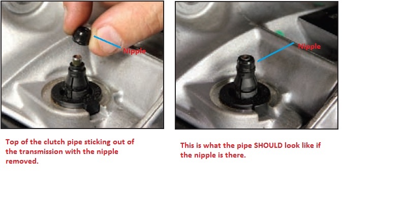

Originally Posted by SmitBag
is there a meet in or around dallas in the next couple weeks? i need to break in the new clutch. hopefully my slobalt will be put back together, this weekend. i just got the new new TOB, because the one that came in the clutch upgrade kit from ced **** the bed while bleeding it :/. fingers crossed. atleast i can now take out the tranny in two hours
Same thing happend to me. I had to drop the tranny like 3 times lmao I at least got good at it an did u make sure the clutch pipe did not have two rubber plugs at the top of it??? I forgot to take the old one out (from the cylinder u bleed it from) and that's how my TOB mest up
no i didnt remove them.. hmmm. because the new clutch pipe had the little ball part like the old one on it.

Ook well my old one was stuck in the cylinder. No don't remove them just make sure there's only 1 in there

This is the piece I'm talking about

yes i figure you were referring to that one, do you gravity bleed it or vacuum?

I use the screw in the clutch slave distribution block ... A friend on mine pump the clutch pedal and I unscrew the screw while he was holding the clutch pedal and then screw it back and repeat until there was no more air in the lines and there was pressure on the pedal
