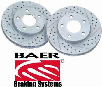

So getting new brakes is definetly going to happen. I'm thinking of getting these bad boys.
http://www.turbotechracing.com/produ...idproduct=4969
What do you all think?

i gotta quick brake question, sorry to commandeer the thread, but is it at all worth while to upgrade the calipers? id assume no, but there may be something i dont know. i know i def want drilled & slotted rotors. my brakes have warped 2 times within the last year. POS stock rotors FTL
oooh... i like those... good price too. i should talk to my guys about brakes...
