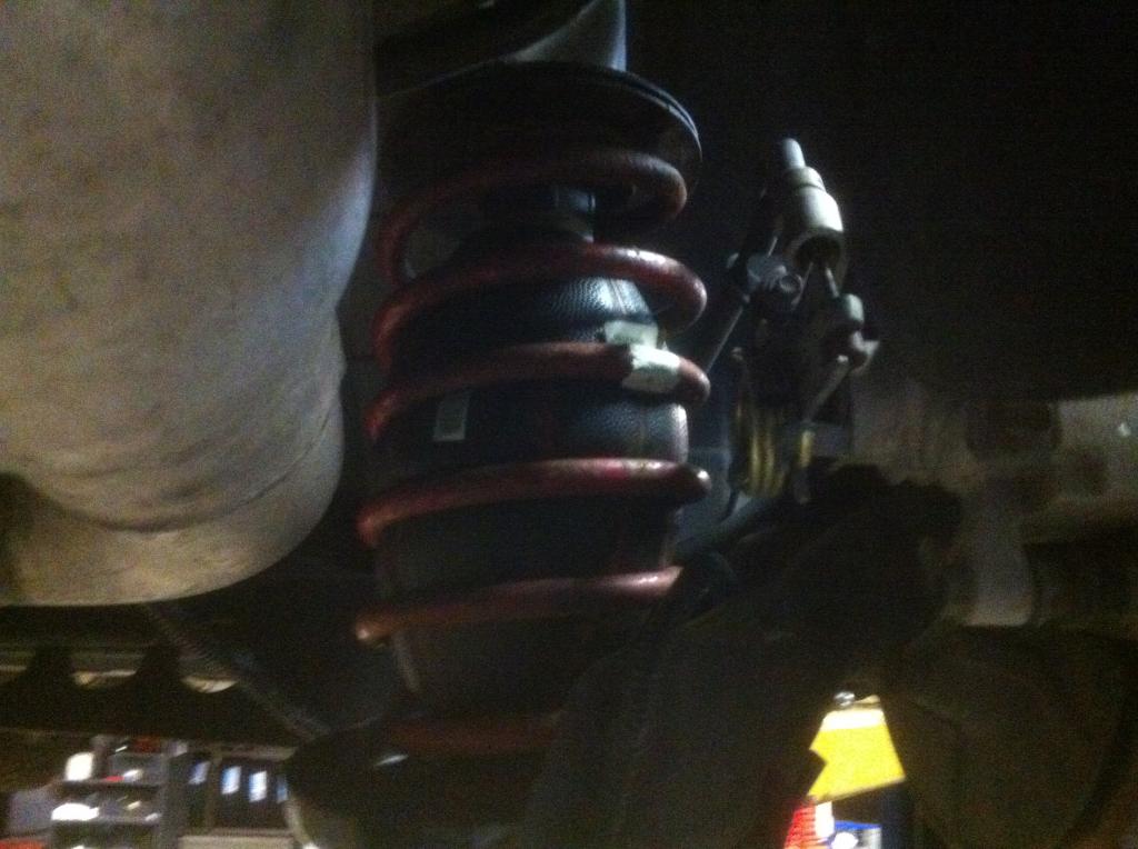

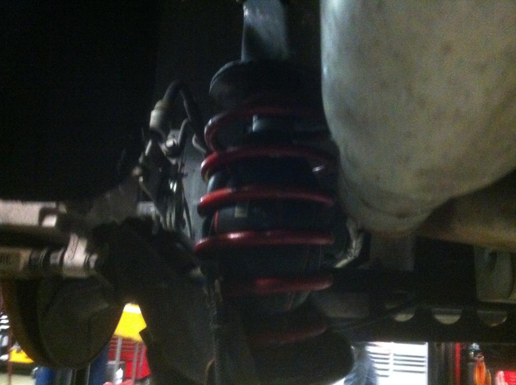

Old Apr 28, 2013 | 02:19 PM
Verbatim's Avatar
Joined: 09-13-09
Posts: 460
From: South County, MO
Originally Posted by dcrep06
lol i know they work the same i was just saying lol. but where exaclty do you place the football in the back? and u fill the football up with 15psi? kills the squat a little? and what football do you use? thanks for the input bud. how much did those LCABs and TCABs cost you?
I pulled my springs out of the rear(pedders); deflated and shoved the footballs inside the spring(was a bitch honestly), then slowly aired them up so I could seat and "clock" the footballs so the hole to fill them would be easily accessible. shoved them back in and bolted shocks back up and pulled it off the lift.
Yes, filled the footballs with 15psi
I picked up some peewee sized ones, got them on sale at wally world.
Been a while since I picked up the powell setup, Best bet is to email john or gloria and ask them and get you a set.
Shitty Iphone pictures but should be good enough...
This is how she sits with the footballs in the springs, but not aired up.

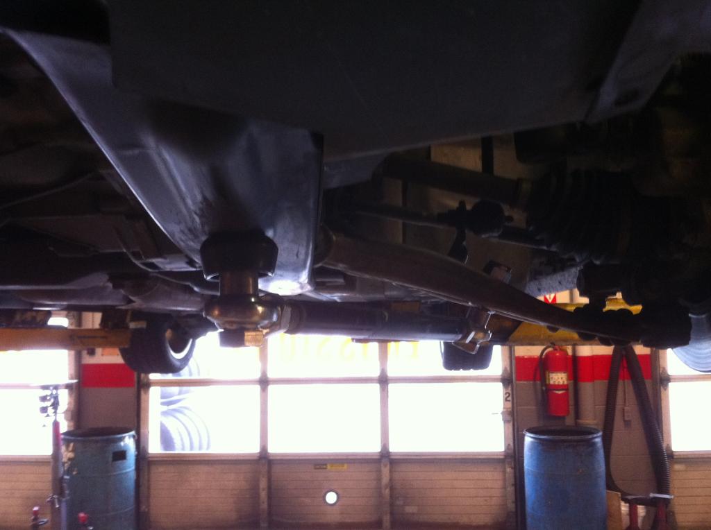

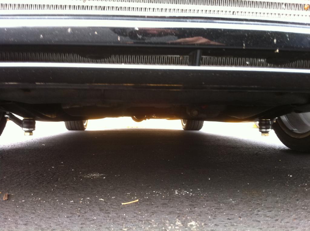

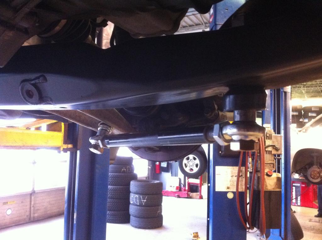

Heres the bars, I have since played with the front heim joint mounting, and I have less noise when at 1 full turn
