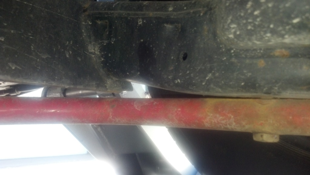

Also, while I'm at it...anyone have OTTP Street Bar? I have a few questions...again, I bought this a long time ago...either 08 or 09, not sure which.
But I was wondering...why even though I have the Street bar, does it have the Hardcore sticker on it? Do they all say that or is it an error when they put the sticker on?

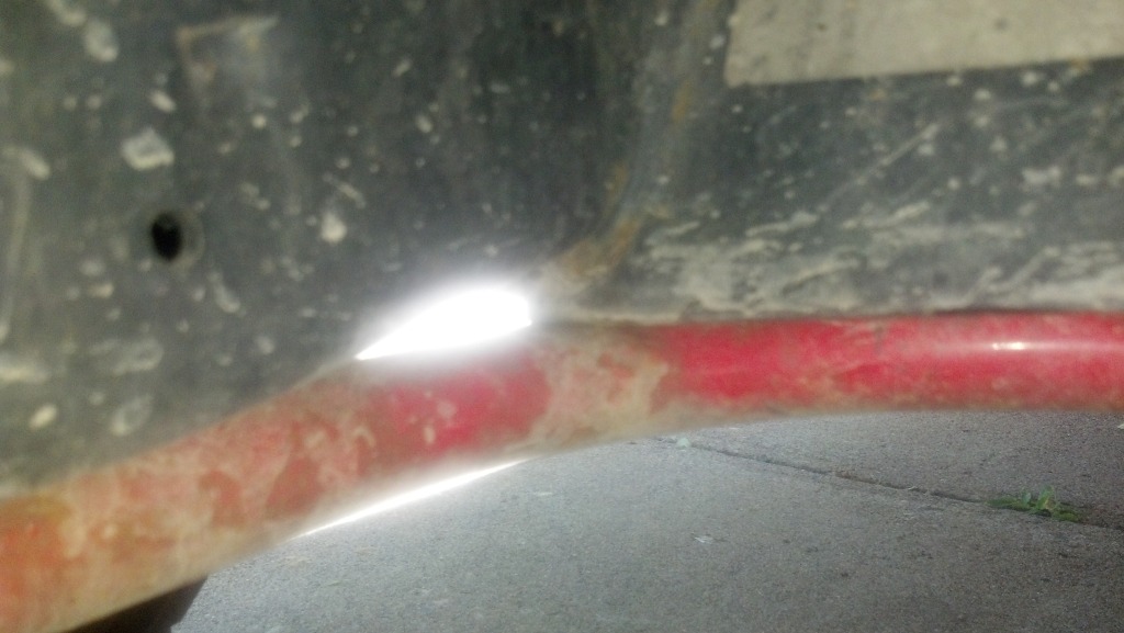

Secondly, anyone have problems with it's mounting? The driver's side contacts the rear beam while the passenger side does not. Does this contribute to any noises/clunking? It sounds like I have a clunking in the back and I know the shocks are fine along with the springs...they're seated properly as well.
The sway bar contacting the rear beam is normal. Powell designed those bars, my Powell bar rubbed there too. Also, if you do any hard cornering, it can cause the coils to rub together. Which causes the powder coating to wear off, letting the springs rust. They should be structurally fine.
I revised the bars to stop the contact. The V beam is not welded in perfectly side to side in the beam ;its a production item and they didnt care. I made the stickers on that bar, at the very beginning....
I have revised our bars with a welded in spacer etc, as folks didnt like the noise, (makes sense to me) but understand it doesnt make any difference in performance,really , except in racing we didnt hear any clunks lol so we never paid attention to that. We made them better and thats where they are today, along with stainless hardware.

As for the bar, I will probably be replacing it with your Hardcore 1.25" bar anyway...I think this bar handles extremely well with my tiny front sway bar and I will be upgrading my front bar to the factory FE5 sometime in the next month finally. I have had it for a year and now it's time to install it. I'll see how it handles with that and the 1" bar, but I think the 1.25" will compliment the FE5 up front better.
After messing around under the car this morning, I did look at the V beam a bit and noticed that it is pretty sloppily done, but like you said it's a production piece and how many hundreds of thousands of Cobalts have they produced (or more).
