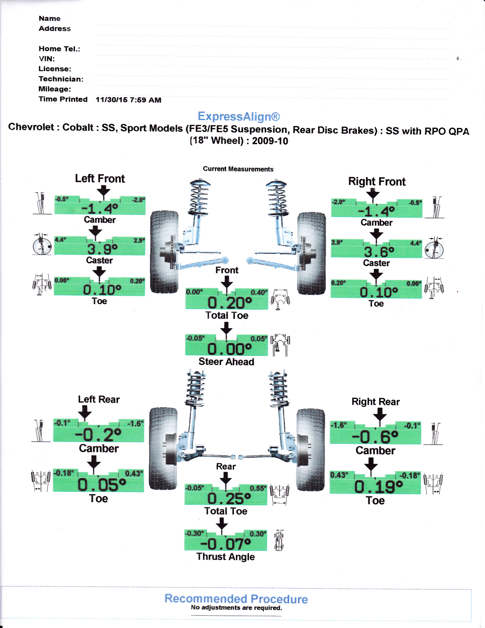

went back to the alignment shop yesterday for them to do one more look. To ensure all the suspension components were in good condition, then recheck alignment and potential install camber kits, etc.
The results are that all bushings, linkages, etc are in good condition. Alignment was all in spec. See attached results. Still has a slight pull to the right. Based on these alignment specs, does anyone see anything that needs adjustment? Would these angles cause any concern for tire wear? The shop said they could install camber kits, but did not see why I would want to spend about $200 if all the angles are in spec. Money is not an issue, but I do agree that if something is not needed, then why.

Attachment 8606

First I have to say the amount of chamber you have is normal for these cars they are actually suppose to have neg chamber since these are sports cars and they do it that way for hard cornering purposes so you don't get tire roll.
Like mentioned above caster really can't be changed, Unless you personally have access to an alignment machine reason being you have to loosen both strut and keep playing with them and suspension parts till its set even again and no shop has time for that. Ain't no body got time for that really.
Lastly if you look at the rear of your vehicle see how you have quite a bit toe on the right rear and your thrust angle is off. This is telling me your rear torsion beam is bent or twisted or possibly some worn bushings. The reason I bring this to your attention is it looks like the right rear wheel will be causing drag and resulting in the pull you are feeling and will wear that tire down a little quicker than the rest.
Also I wouldn't recommend shims to fix toe, Just leave it be it is quite common on cobalts, j-body's and pretty much anything with the same suspension set up.
If it does bother you it can be moved to make it centered to the front, You just have to loosen the three bolts that secure the torsion beam on both sides and square the rear of the car to the front. Then retorque the bolts.

Update: Although the front tires were new, I finally switched them around a few weeks ago (right to left, but still on the front). The problem went away. Had new tires installed yesterday (under warranty) and no more pull. I had a hard time imagining that new tires could be the issue, but this was the problem. It now rides straight with very little if any pull.
Thanks for everyone's information and input.
I was going to say, the alignment numbers looked pretty good, the right rear toe is in a bit more than the left which *might* cause a bit of pull, but I wouldn't expect it to, and obviously you know the problem was the tires (strange because they are brand new).
