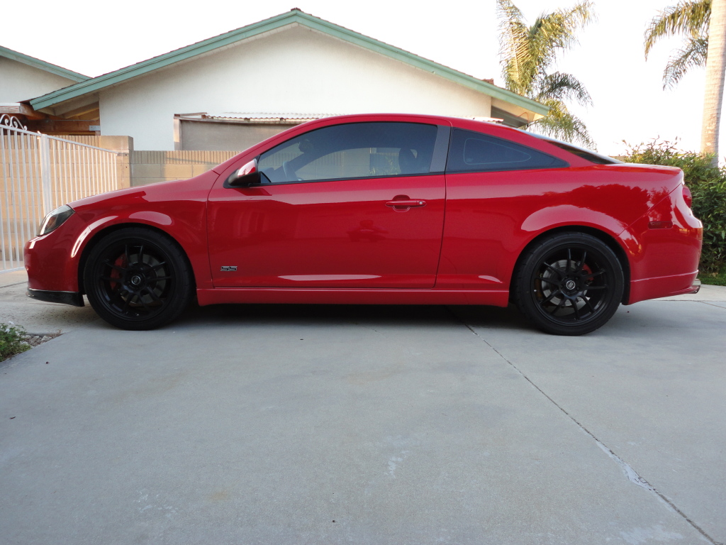

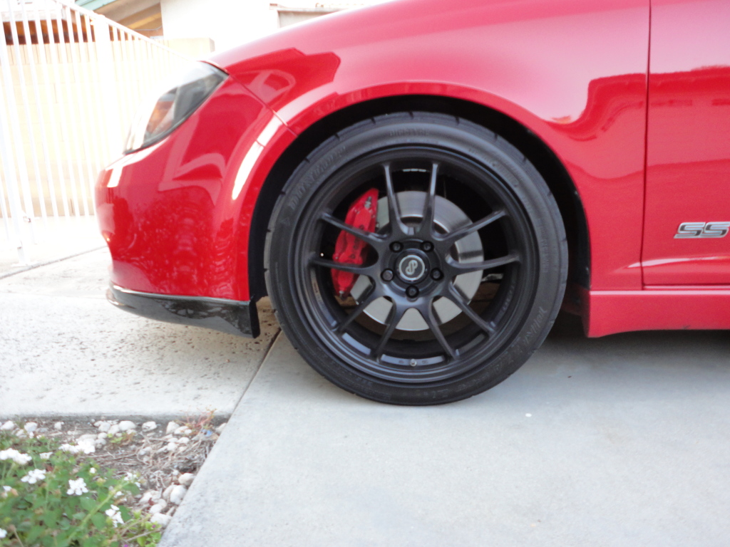

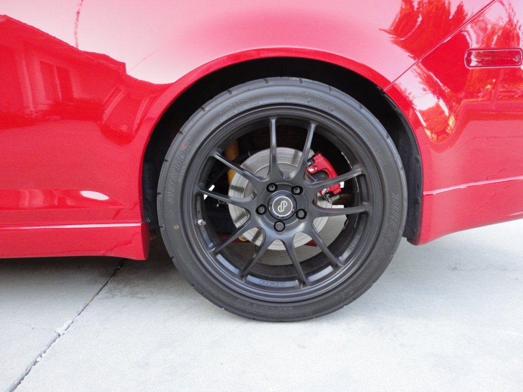

fender to ground height with pedders in front is 25"
fender to ground height with pedders in rear is 26"
currently on pedders springs with koni yellow rears
235/40/18 dunlop starspecs on 18x8 enkei pf01s wheels
getting springs in mail on friday should have them installed by saturday with koni yellow front inserts and will be updated with new measurements and pictures saturday/sunday

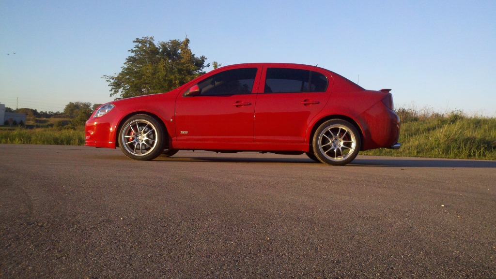

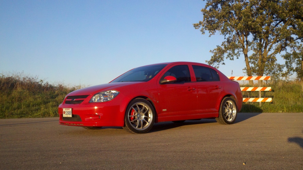

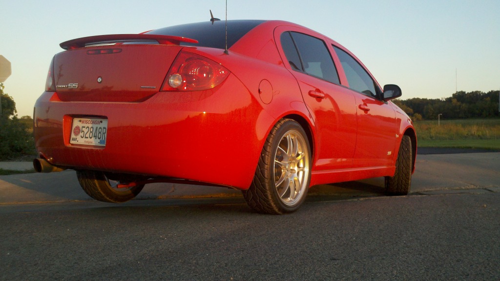

side shot with yyzs installed?
18x8 PF01's on 235/40/18 BFG KDW
driveway entrance w/ hardcore bar
like I said, I'm extremely happy with how they handle! just not a fan of this clunking issue I'm having at the moment
