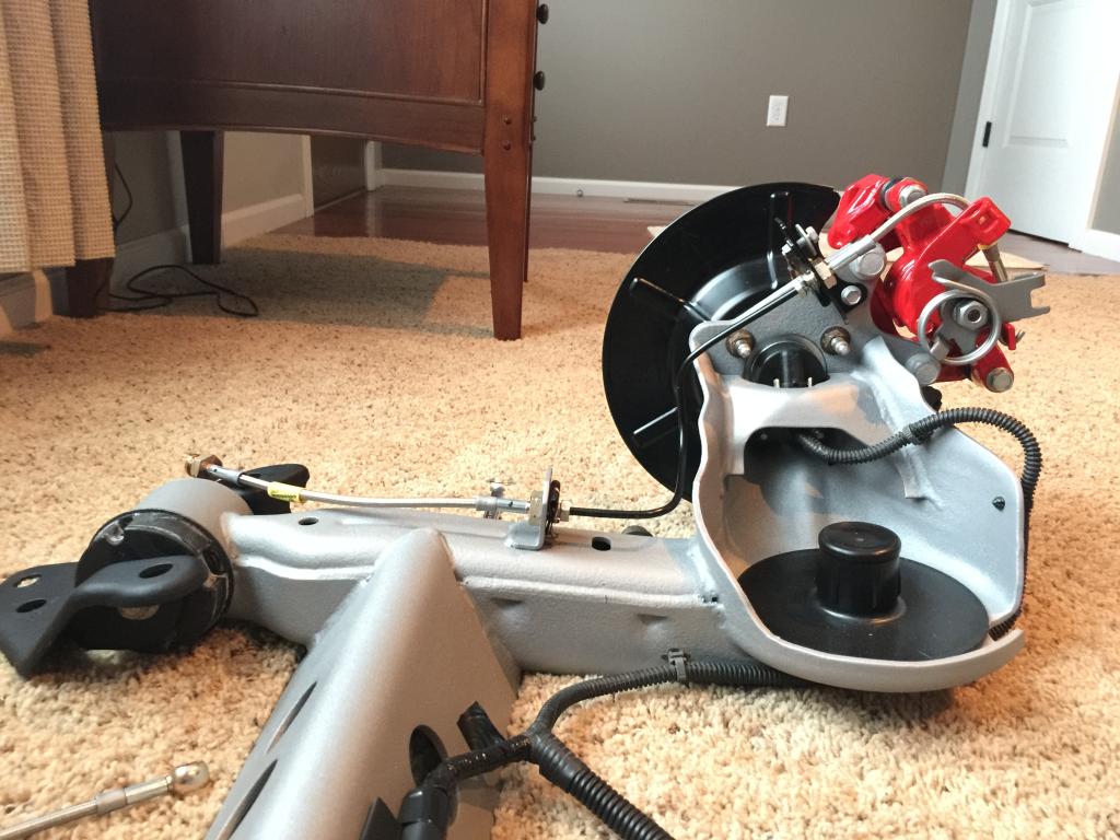

The hard brake lines you'll have to make. I just sold a second set I made. They aren't too hard to bend. pick up one of those cheapie hand benders from the parts store and use your old lines as templates for the bend angles. you'll have 3 bends to make and obviously you're last bit of brake line wont be formed the same as the drum brake lines but the first 3 should be the same. your new line will just go straight up to the line bracket instead of bending in and connecting to the drum brake backing plate. The hard part will be getting good flares on the ends. I was lucky to use the flare machines a work but doing jobs like that is frowned on. I had to sneak them out of there It's too bad GM doesn't sell replacements for these.
Id recommend buying coated lines. The ones I used are coated with whats called Nygal. Its a plastic coating to help prevent corrosion. I think the parts stores carry various lengths of coated tubing. you may be able to have them flare the second end once you get the tubing cut to the proper length. I think i cut mine at 14" but it's hard to remember now.
