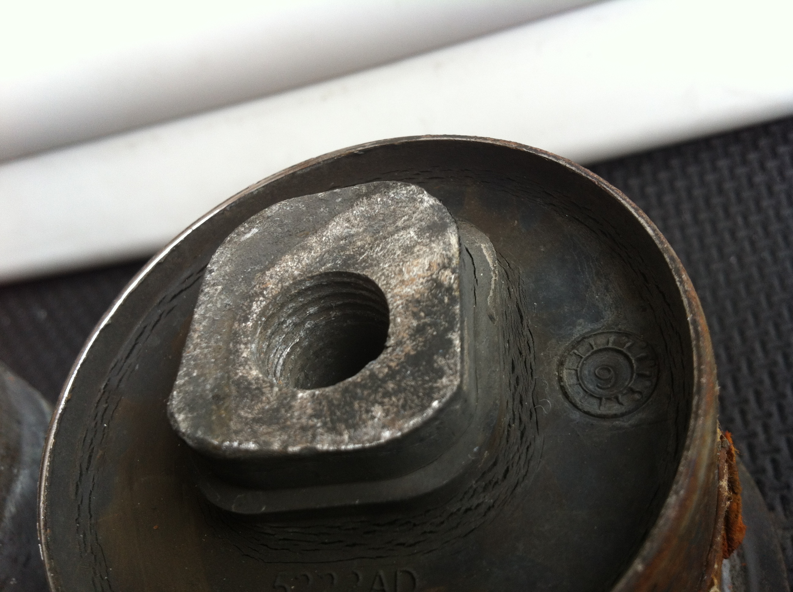

I've had a loud metal rattle or clunking in my rear suspension for a long time and until recently I was unable to determine the cause. At a recent car show I managed to make a video of the culprit: the right rear twisting bar bushing:
I ordered Powell Race Shop replacement bushings and swapped them out last weekend.

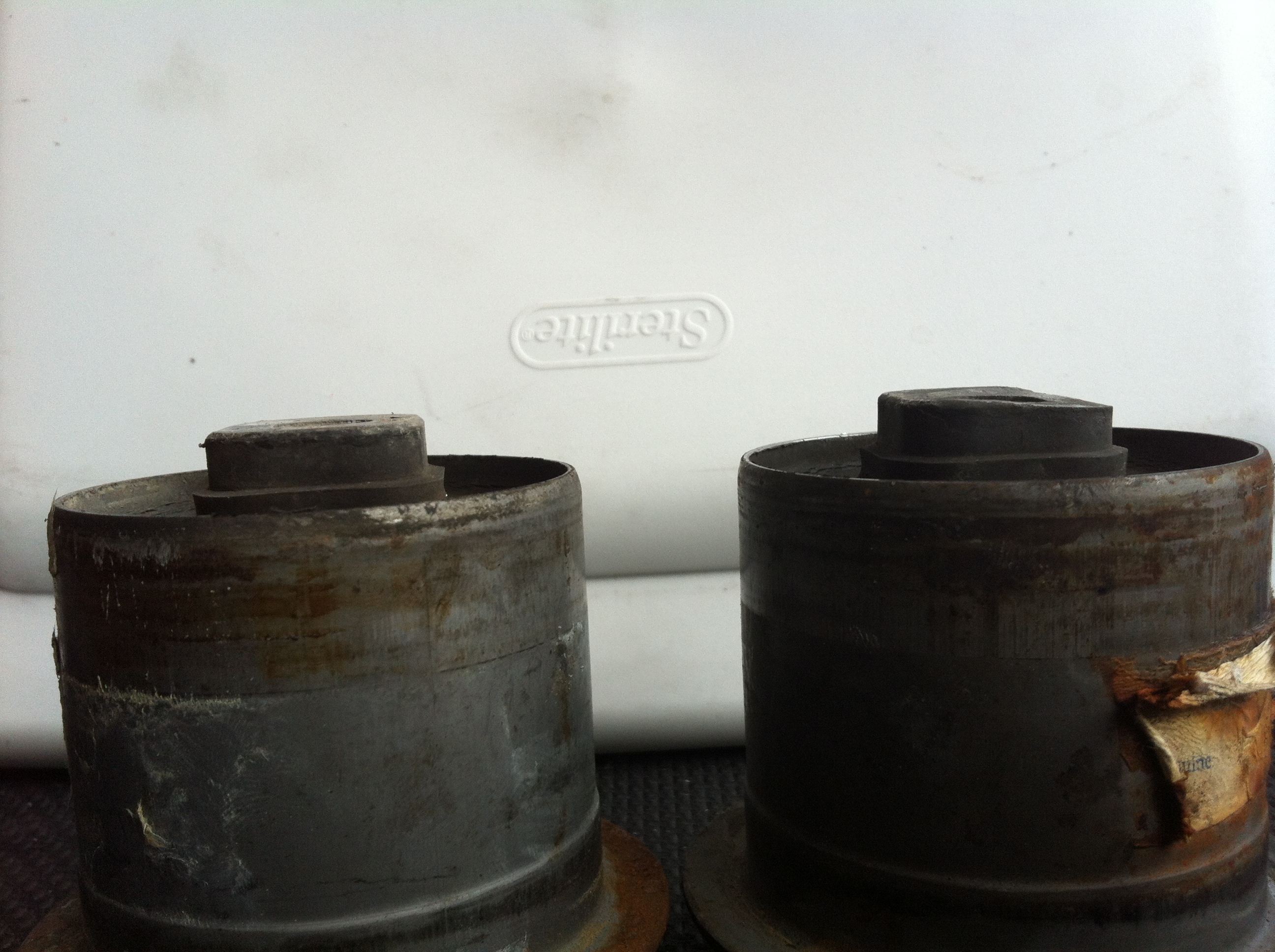

It turns out the right side bushing has worn down on the outer side against the bracket, and also the bolt had worn down the orifice on the inside:
On the left, the left hand bushing, still intact, on the right the worn down one:
This picture clearly shows how the bolt has eroded away the aluminum sleeve:

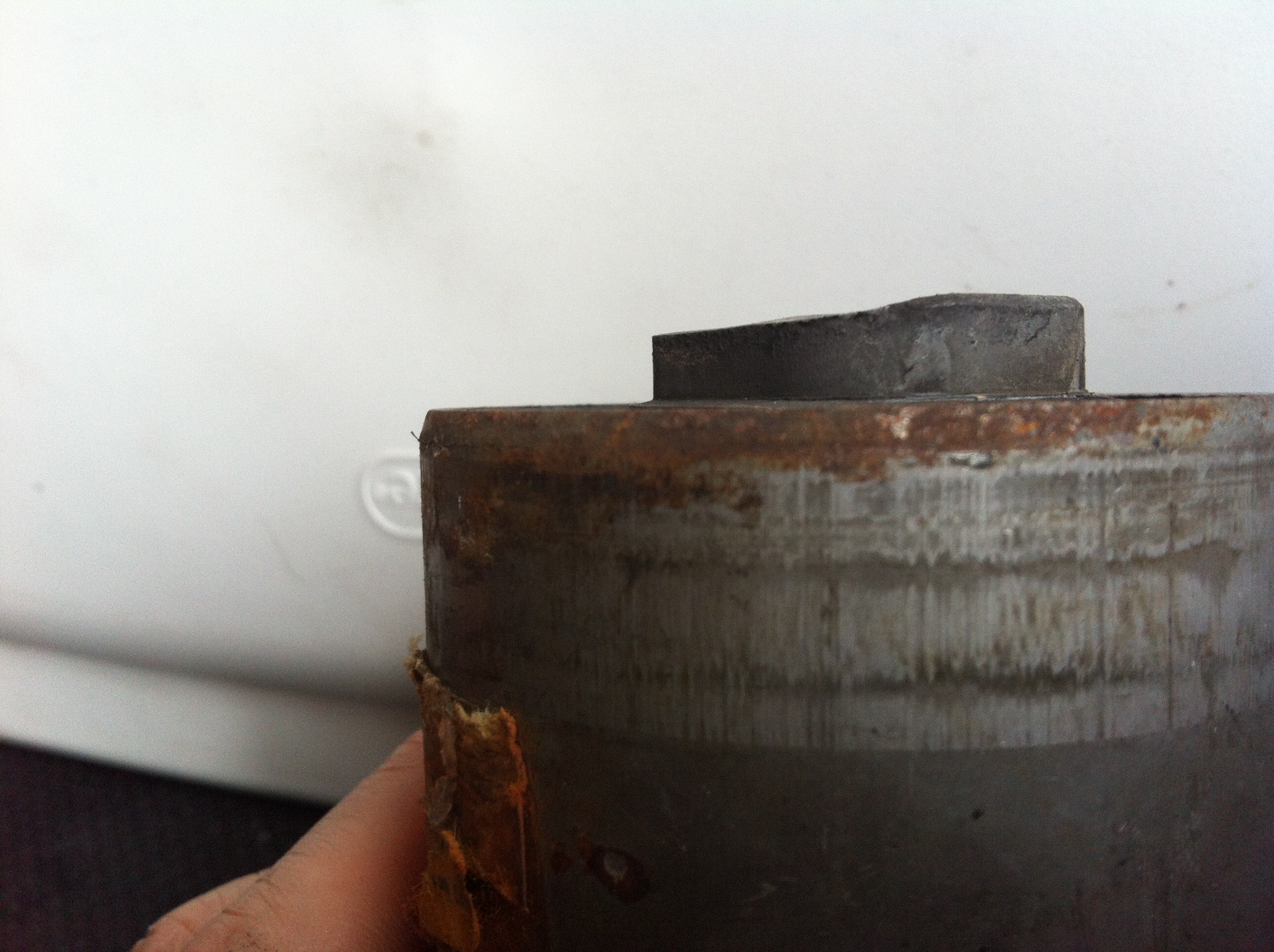

As I said, this had been going on for some time, as evidenced by the amount of material missing in this picture!!
